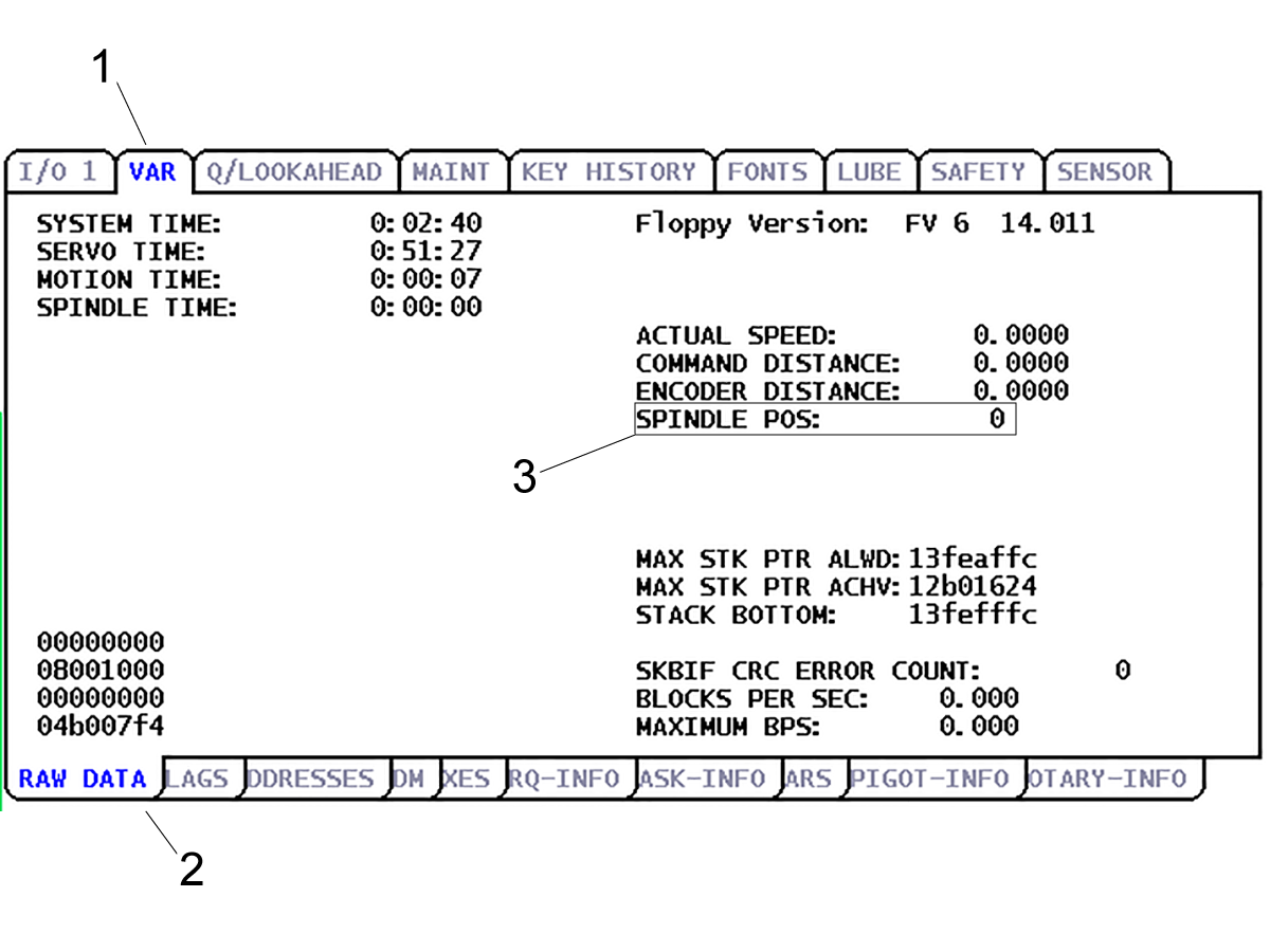

Go into DEBUG mode
Push [POSIT].
Select the VAR tab [1].
 Note: If you have software version 15.xx or earlier, navigate to the VAR tab.
Push [WRITE/ENTER]
Select the RAW DATA tab [2].
Turn the spindle dogs with your hand. Turn until the SPINDLE POS [3] value is between 0 and 2000. Make the value as near as possible to 0.

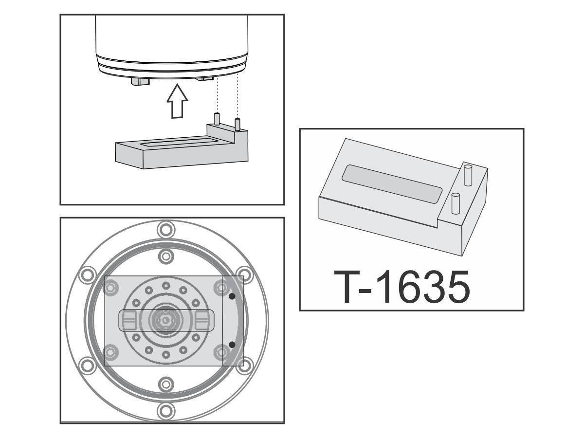

Attach the spindle lock tool (T-1635). This tool aligns the spindle dogs.
 Caution: Make sure the SPINDLE POS value stays between 0 and 2000. If the value is not accurate, you will crash the machine.
Enter the SPINDLE POS value into Parameter 257.

Remove the Spindle Lock Tool (T-1635).

Tools Required
  • Spindle Lock Tool T-1635
 Note: If you have software version 15.xx or earlier, push [PAGE UP] or [PAGE DOWN] to go to the VAR tab.
Push [WRITE/ENTER].
