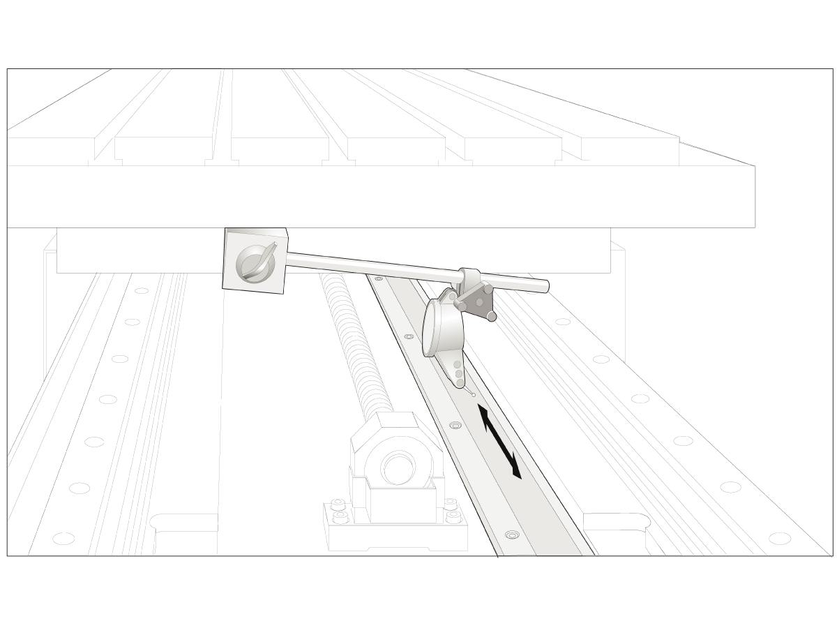

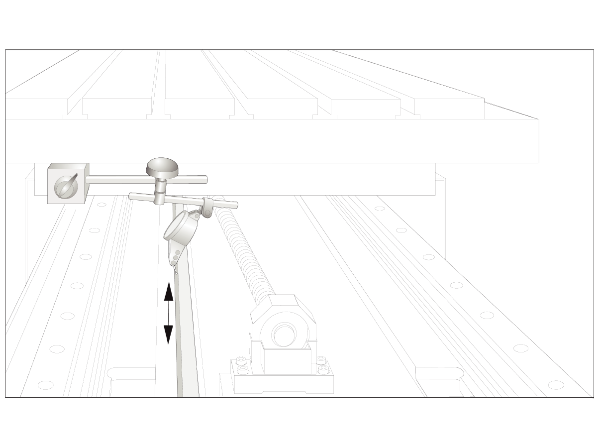

Using a dial indicator check the parallel runout of the scale mounting bracket. For VF-3 only see the next paragraph for indicating runout.
To indicate the full length of the scale mount; jog table all the way to the left and place the magnetic base on the right side of the table as shown.
Zero the indicator, mark the position of the indicator stylus on the scale mount and obtain reading, full travel to the right. Remove magnetic base and place it on the left side of the table. Zero the indicator at the mark on the scale mount and obtain reading, full travel to the left. (T.I.R. .004).
Align if necessary. Verify bolts are tight. If alignment cannot be made within tolerance, shim stock may be used near mounting bolt locations when mounting the scale.

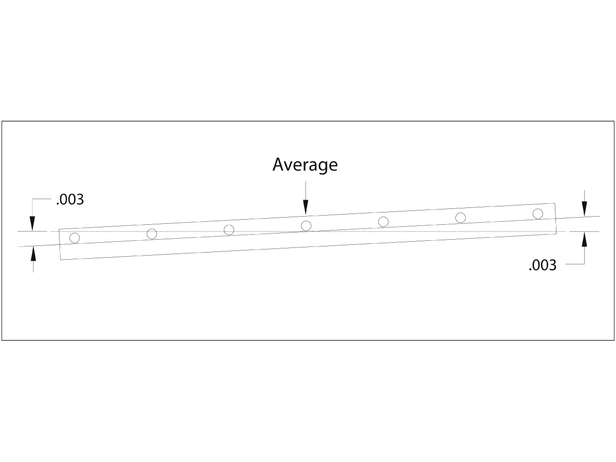

Install the linear scale using blue loctite on the screws. Check and adjust scale parallelism. Use shim stock as required to obtain parallelism TIR .004.
Obtain an initial flatness measurement using a dial indicator. To adjust, tighten the bolt nearest the area where the reading is the average of the total deviation. Tighten the remaining bolts in an outward pattern while adjusting flatness (T.I.R. .004).
Check parallelism of the scale, and adjust if necessary (T.I.R. .004). Verify all mounting bolts are tight.

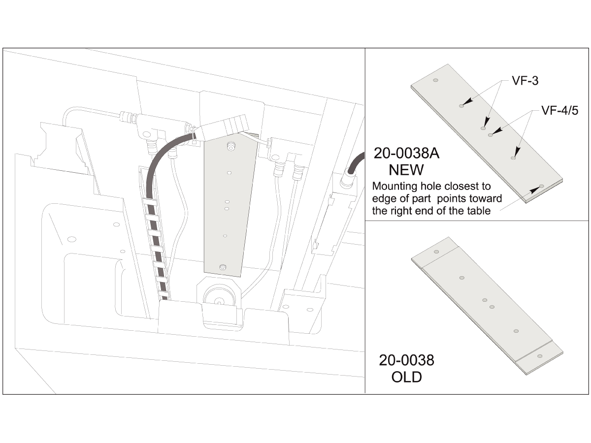

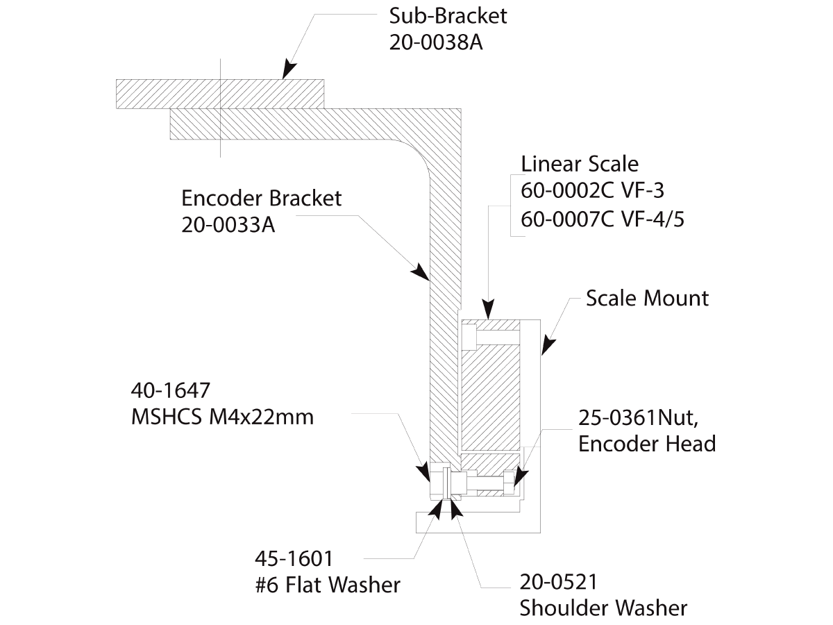

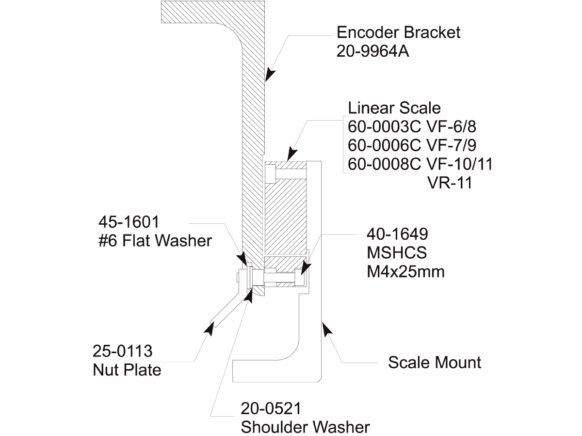

Use a new style, electrically isolating encoder bracket for mounting the encoder head. See installation diagram for part number.
For VF 3/4/5 make sure the correct sub-bracket is used (P/N 20-0038A).
See below for old/new part comparison and hole pattern usage. Use the same cylindrical spacers under the sub-bracket.
7
Check all mounting surfaces for burrs that may influence the angle of the bracket. Install encoder bracket to the table or sub-bracket head leaving the bolts loose enough to adjust the bracket. (use a flat washer and a split-lock washer).

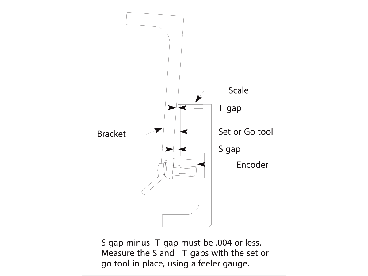

Linear Scale - X-Axis - Alignment

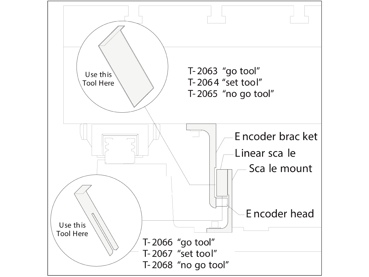

Using the horizontal gap tool "set tool" (T-2064), align the encoder bracket to the scale (see illustration) by pinching the tool between the encoder bracket and linear scale and slowly tightening the encoder bracket mounting screws by alternating between screws to prevent shifting the bracket.
Be sure alignment is not made where there are labels on the scale.
Leave the "set tool" in place and check that the bracket surface and the scale surface are parallel. If they are not, use a feeler gauge to measure how out of parallel they are. If they are more than .004" out of parallel shim the encoder bracket.
Remove the "set tool" and verify allowable gapping error by inserting the "go tool" (T-2063) from both sides of the bracket. Insertion of this tool means the gap is not too small.
Attempt to insert "no go tool" (T-2065) from both sides of the bracket. If the tool does not fit then the gap is not too large. This completes alignment of the encoder bracket.
The new isolating encoder bracket uses metric screws with flat washers, plastic shoulder washers, and nuts or nut plate as shown in the installation diagram.
Align encoder head to scale by pinching vertical gap tool "set tool" (T-2067) between the encoder head and scale and tightening the screws (use blue Loctite).
Be sure any isolating material overhanging the encoder head is not pinched between encoder head and gap tool. Remove "set tool" and verify allowable gapping error by inserting "go tool" (T-2066) from both sides of the encoder head. Insertion of this tool means the gap is not too small.
Attempt to insert "no go tool" (T-2068) from both sides of the encoder head. If the tool does not fit then the gap is not too large. This completes alignment of the encoder head.

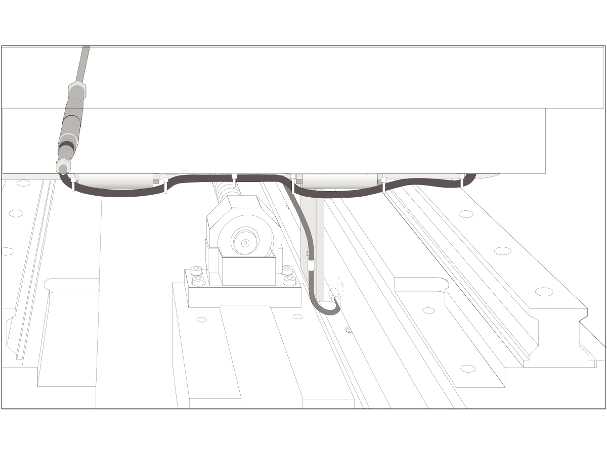

Do not connect linear scale cable to extension cable at this time. Verify isolation or electrical discontinuity between encoder head and its bracket using an ohmmeter.
Connect linear scale cable to extension cable, check cable routing, and secure the cable.
Check that the cable will not interfere with other parts when the table is moved.
Be sure that the cable does not bend too tightly (see illustration).
6

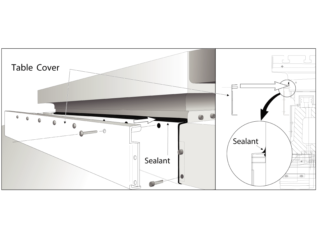

Clean table cover mounting surfaces as described above.
Apply a continous bead of sealant along entire surface as shown.
Attach table covers and smooth out sealant on outside of table cover as shown.
