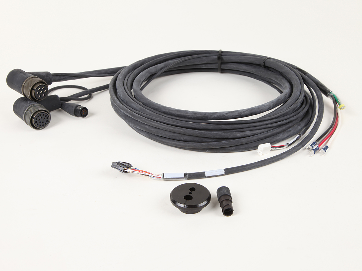

This procedure tells you how to replace these brushless axis cables:
  • 2-Cable set: motor power and encoder
  • 3-Cable set: motor power, encoder, and brake
Cable Replacement
 Note: The replacement cable kit includes a grommet. The grommet has holes for the Power Cable [1], Encoder Cable [2], and [3] Brake Cables (The brake cable hole [3] is not on the grommet if you have a 2-Cable set).
If the cable that you must replace has a mechanical axis limit switch cable [4] for the axis movement, install the jumper [5] on the switch cable [4].
Put labels on the locations of the cables you will replace.
  • The encoder cable connection location is on the processor PCB [1]
  • The power cable connection location is on the amplifier [2]
  • If you have a brake cable, the connection location is on the I/O PCB [3]
Cut the extra rubber [3] off of the grommet. Make sure a space is between the smaller diameter of the grommet and the larger diameter of the grommet, as shown [4].
Fill the amphenol connectors on the motors [5] with dielectric grease.
IMPORTANT: Make sure to only place grease on on the contact points of the connectors. Do not apply excess grease to the entire face of the connector. This can cause damage to the servo motor.
Install the new axis cable. Put the cables [6] into the grommet [7]. If you have a brake cable, put it in the grommet [7] first.
Push the grommet [7] through the hole in the control cabinet. Make sure the tab [8] on the grommet goes fully through. This holds the grommet in position on the inside of the control cabinet.
