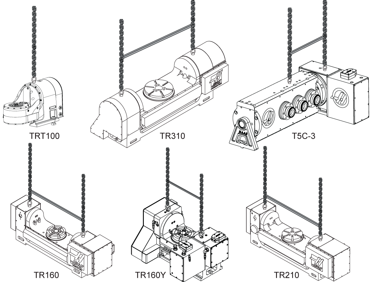

Rotary - TR/TRT/T5C - Lifting Instruction
Lift the rotary table with the lift rings as shown to prevent damage to the gear set. Attach an air supply to the rotary before you lift it. All rotary tables (HRT, TR, TRT, and T5C) use the 1/2-13 eyebolts. Haas Automation, Inc. does not supply lifting chains or straps for rotary products.
Warning: LIFTING A ROTARY WHILE NOT CONNECTED TO AIR MAY DAMAGE THE ROTARY.
If spreader bars are not available, eyebolts may be used as shown:
TR500SS
To lift the TR500SS, position your lifting mechanism above the center of gravity [1] to ensure the rotary is lifted uniformly.
Lift the machine from the eye bolts near the A frame [2] and the lifting bracket [4].
NOTE: Use straps [3] or something that won't damage the platter, as lifting it from this location will interfere with the platter.
TRT310 being lifted with two hooks.
Lifting TRT 160 and TRT 210
There are two ways to lift the TRT160 and TRT210.
1. Use the center hole on the top of the rotary. The center hole has 1/2-13 threads. Using this hole is similar to how the TRT100 is shown being lifted above. These two models will not come with the eye bolt for this hole.
2. Use the two holes beside the center hole. The two holes on the side have M8-1.25 threads. These rotaries can be lifted similarly to how the TRT310 is lifted in the image. These units will come with the eyebolts that fit in these holes. These eye bolts have an ID of 0.75 inches (19 mm).

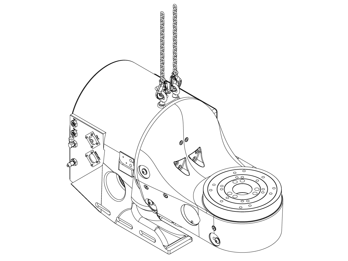

TRT 310
Unlike the two smaller rotaries, the TRT310 has no central hole that can be used for lifting. Also, these two side holes are larger than on the smaller models being 1/2-13 threads with the eyes having an ID of 1-1/8 inch.
The TRT310 must be lifted using a sling with two hooks, as shown in the picture. A spreader bar is not needed.
The TRT310 weighs about 1000 pounds. Verify that appropriate lifting equipment is ready for installation.

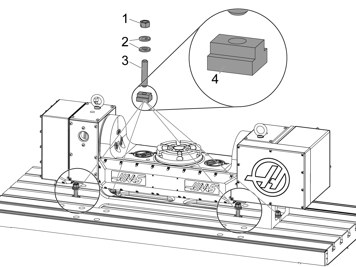

Center the table and jog it to the front of the machine near the door. Turn ("tilt") A axis 90 degrees to access the T-Nuts.
Press [EMERGENCY STOP].
Loosen the T-Nuts. Remove only the inner T-Nuts [4], the 1/2-13 double-threaded studs [3], washers [2], and nuts [1].
 Note: You need the outer T-Nuts [4], the 1/2-13 double-threaded studs [3], washers [2], and nuts [1] to keep the rotary stable until you remove it. See AD0334 for instructions on removing TR rotaries.
Home the A axis.
 Note: The A Axis must be in the home position to be moved. This will prevent damage to the rotary.
Note: When removing an integrated trunnion from a VF-TR, a service kit will need to be ordered. This kit will have a standard TR310 or TR210 base and shipping brackets. Order 93-2127 for VF-5TR and 93-2126 for VF-6TR. Follow the instructions in VF-5TR, VF-6TR - Integrated Trunnion Removal and Installation - AD0334 to remove the trunnion.

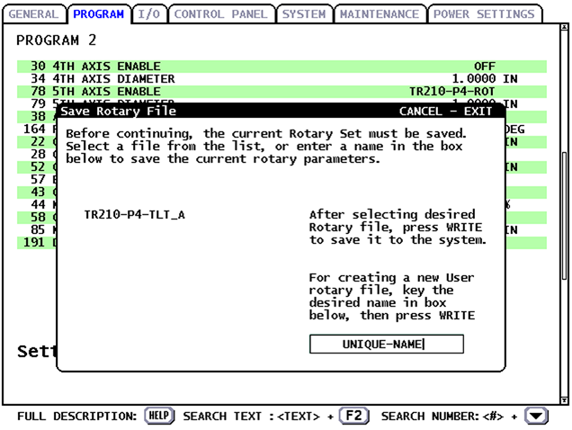

Disable Rotary Axes - CHC
Release [EMERGENCY STOP].
Change Setting 30 4TH AXIS ENABLE to OFF. Push [ENTER].
Save the file with a unique file name. Use less than (12) characters. Push [ENTER].
Change Setting 78 5TH AXIS ENABLE to OFF. Push [ENTER].

Remove the T-Nuts, the 1/2-13 double-threaded studs, washers, and nuts.
 Note: You may not be able to remove all of the T-Nuts until you lift the rotary.
