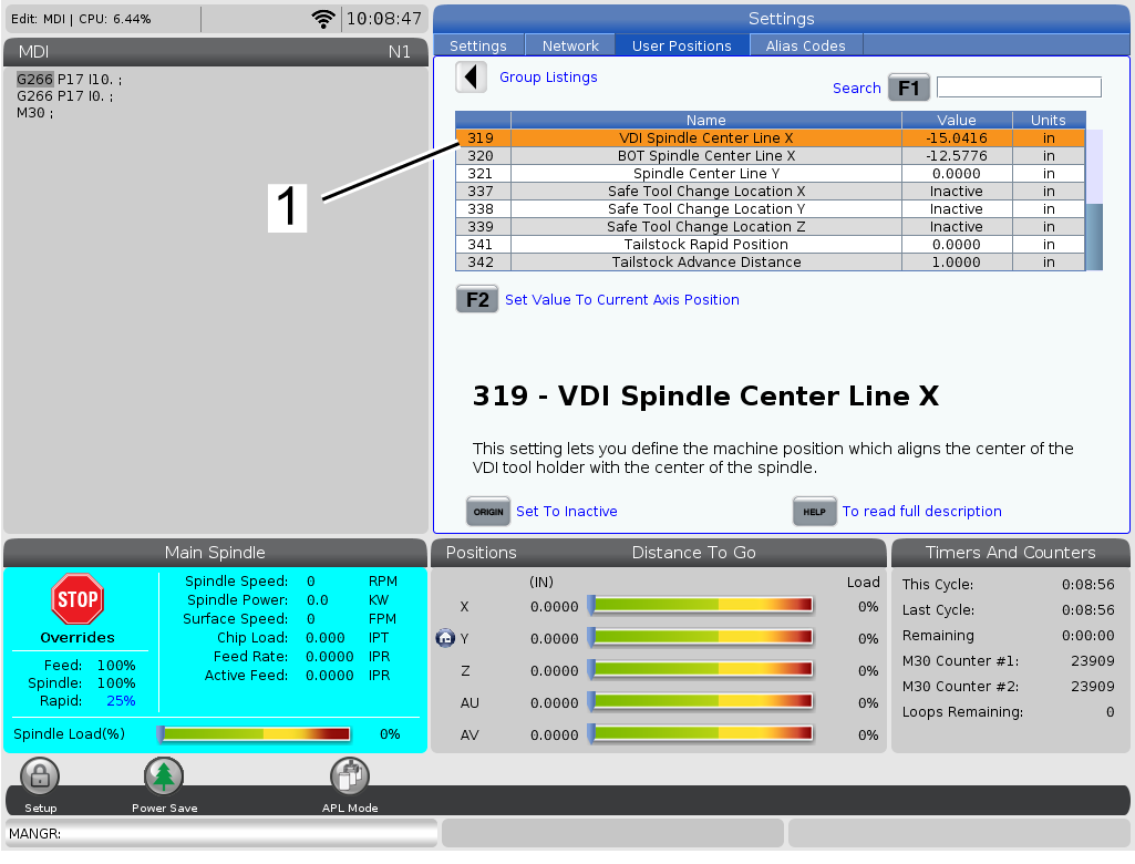

Once you have the turret on spindle center line:
  • Go to Settings by pushing [SETTING]
  • Use the arrow key to navigate to User Positions then to Spindle Center Line.
  • Highlight the appropriate setting for the type of turret on your machine [1]
    • VDI turret: Setting 319
    • BOT/BMT turret: Setting 320
 Note: If you have a hybrid turret use Setting 319 VDI Spindle Center Line X. You should have centered the spindle to Tool 1 which is a VDI tool.
  • With the turret still on spindle center line:
  • Press [F2] to set the value to the current axis position.
  • Move your indicator away from the tool holder.
  • Press [ZERO RETURN] to Zero Return your machine
  • Hand Jog to the X value that was recorded in Setting 319/320 and verify that the indicator shows zero runout to check that the turret returned to spindle centerline
  • Use arrow key to navigate to User Positions then to Spindle Center Line.
  • Highlight Setting 321 Spindle Center Line Y and press [F2] then [ENTER].
  • The value should change from inactive to all zeroes.
  • Highlight the appropriate setting for the type of turret on your machine.
  • Zero Return your machine
  • Hand Jog to the X value to what was recorded in Setting 319/320 and check to see if you spindle is centered.
