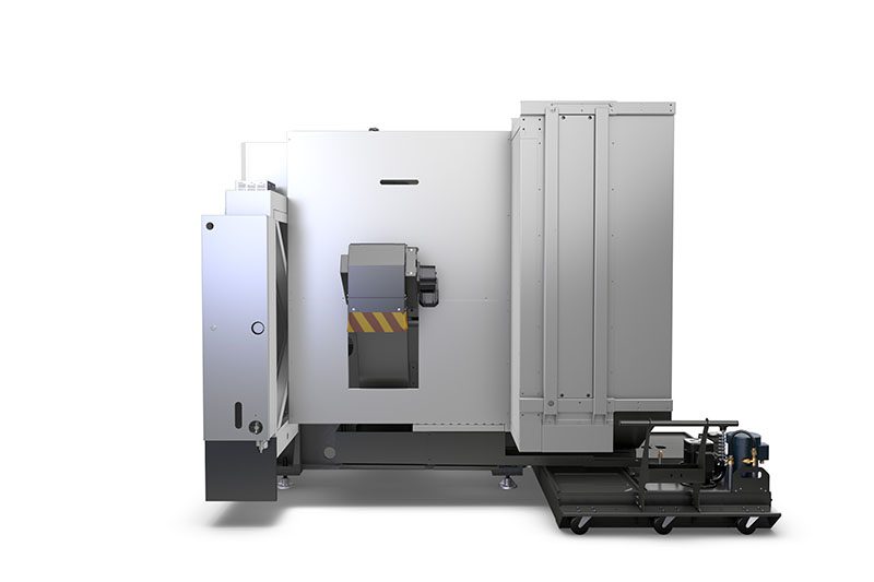

The EC-500/50 adds a robust 50-taper spindle to our popular 500 mm pallet-changing horizontal machining center to create a high-performance HMC with 50-taper cutting ability in a smaller footprint.

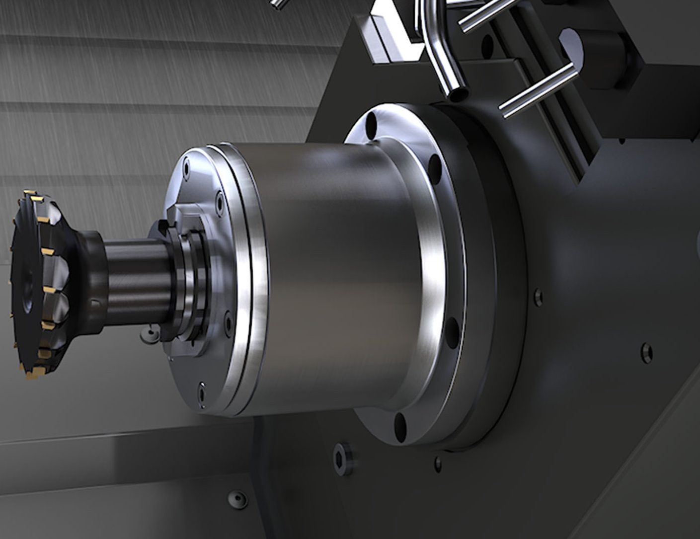

50-Taper Spindle
The EC-500/50 comes standard with our 7500-rpm 50-taper spindle, which uses a Haas-built two-speed gearbox to provide a wide constant horsepower band, good low-speed torque for heavy cuts, and higher torque throughout the range above 500 rpm.
For heavy cuts and high material-removal rates, a high-performance 7500-rpm spindle is also available. Powered by a 60 hp vector drive, this spindle provides higher power throughout the rpm range than the standard spindle. A 10,000-rpm, 60 hp spindle is also available.
  • 2-speed gearbox designed, manufactured, and built in-house
  • More power for larger diameter tools and tougher materials
  • Automatic High or Low gear selection, based on commanded rpm
  • User-programmable selection of High or Low gear via M-codes
Optional 7500-rpm, 60 Horsepower (44.7 kW) Peak Vector Drive Spindle CLICK HERE
Optional 10,000-rpm, 60 Horsepower (44.7 kW) Peak Vector Drive Spindle CLICK HERE
EC-500/50 Coolant Ring
The 4-nozzle coolant ring surrounding the spindle nose is perfectly positioned so that nozzles can be pointed at the shortest tools, and others can be positioned for longer tools. The compact, cylindrical design prevents chips from collecting on top. NOTE: The Haas Programmable Coolant Nozzle (P-COOL) is not available on the EC-500/50.
EC-500/50 Chip Management
The completely redesigned EC-500/50 has been improved from the ground up, with all new castings for increased rigidity, better cutting performance, 5 more inches of Y-axis travel, and vastly improved chip evacuation.
At the heart of the EC-500/50’s improved chip management system is a wider belt-type chip conveyor positioned in the center of the machine, directly under the spindle. The steep walls of the interior enclosure easily funnel chips to the conveyor.
The conveyor discharges chips at the height of a full-size industrial barrel. Washdown nozzles mounted in the ceiling are fed by a separate coolant pump, and allow you to direct coolant flow to areas where chips may gather, to further enhance chip evacuation.
