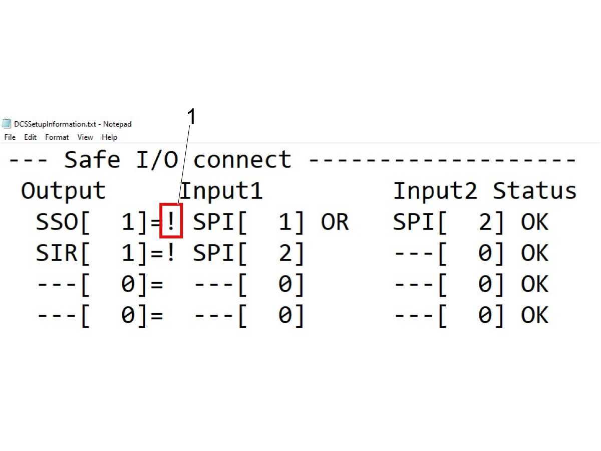

9156.406 SRVO-406 DCS SSO SVOFF input 1,1 The K9 and K10 Relays on I/O PCB are not installed. Make sure you have the K9 and K10 relays installed on the I/O PCB.  Refer to the Robot Installation Procedure, Electrical section.
The fence is open in Run Mode. Make sure the interlock is working and that machine is receiving the interlock input signal.
The TB3-B wiring is damaged or miswired. Check the wiring for the TB3-B connector. Compare the wiring of the connector to the wiring diagram.
The DCS Cartesian Position Check Zone was not setup. Follow the DCS Cartesian Position Check Zone procedure.
The Safe I/O for Input 1 is set incorrectly. Follow the Safe I/O Input 1 procedure below.

Safe I/O Input 1
If SRVO-406 is generated in Run Mode and the wiring is correct, DCS is set correctly, and the light curtain is not broken. Verify that the Safe I/O Input 1 is set correctly.
With the alarm generated and the robot connected to the Haas, take an Error Report. Navigate in the Error Report to HaasData > Robot Logs > DCSSetupInformation. Open the file and scroll to the Safe I/O connect section of the file. Check if there is an exclamation point[1] on the SSO row before SPI. If it is, follow the document below to set Input 1 correctly.
Safe I/O Input 1 Procedure
