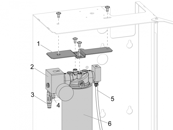

Install the metal reservoir with oil [6]. Install the completed new axis-lubrication reservoir assembly into the cabinet.
Use the adapter bracket [1] if the holes in the cabinet do not match the holes in the head assembly. Make sure the bracket is oriented as shown.
Note: Damage can occur over time if the vertical axis hose is not connected to an output with a check valve. Air can get into the hose and the vertical axis won't get adequate lubrication.
Connect the input air hose [5] and output grease hoses. Make sure to install the vertical axis to the output port with the check valve [3]. The other axes are installed on the hose fittings [4].
Connect the pressure switch cable to the pressure switch behind the oil manifold [2].
