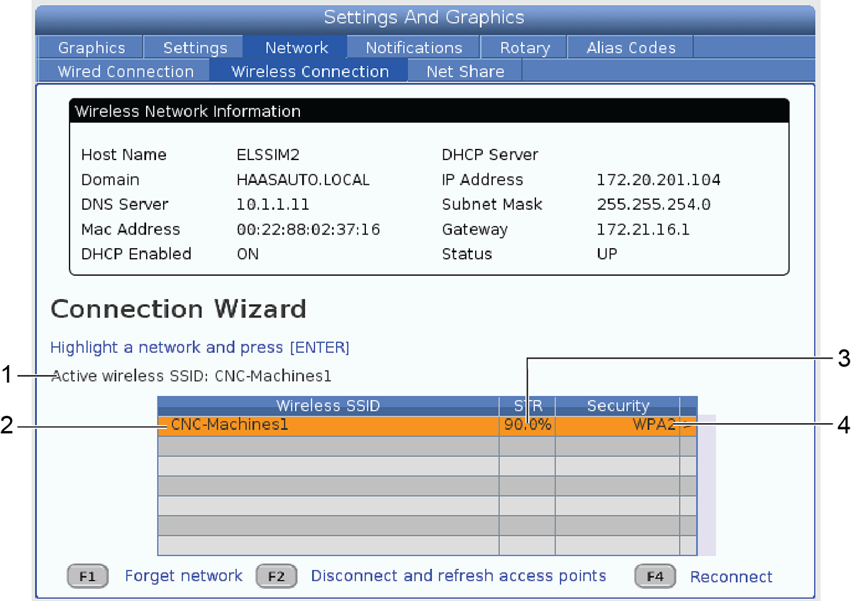

To establish a wireless network connection
Select the Wireless Connection tab in the Network tabbed menu.
Press [F2] to scan for available networks. The Connection Wizard shows [1] the Current Active Network Connection (if any), [2] the Network SSID, [3] the Signal Strength, and [4] the Security Type for the available wireless networks.
The control supports 64/128 WEP, WPA, WPA2,TKIP, and AES security types.
  1. Use the cursor arrow keys to highlight the network you want to connect to, and then press [ENTER]. The network settings table appears, with fields for [1] the network password and [2] DHCP enable/disable.
    Type the access point password in the Password field.
    Note: If you need special symbols such as underscores ( _ ) or carets ( ^ ) for the password, press F2 and use the menu to select the special symbols you need.
  2. If your network does not have a DHCP server, change the DHCP Enabled setting to OFF and type the IP Address, Subnet Mask, Default Gateway, and DNS Server Address into their respective fields.
    Press [F4] to complete the connection, or press [F3] to discard your changes.

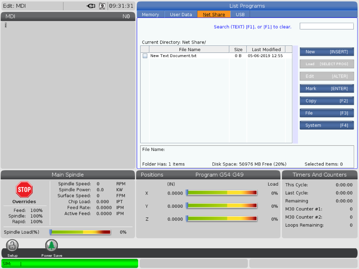

Local Net Share Setup
Local Net Share is used to access the file system of a Haas CNC Machine from a shop PC in order to transfer files between the CNC machine and the PC.

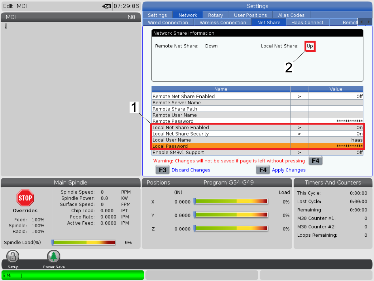

To set up Local Net Share:
Press the [SETTINGS] button.  Navigate to the Network tab. Navigate to the Wired Connection or Wireless Connection tab.
Make sure the machine network status [1] is "UP".
Navigate to the Net Share tab.
In the Cnc Network Name field [1] enter a unique identifiable name.
Set the Local Net Share Enabled and Local Net Share Security settings to ON.
The Local User Name setting defaults to haas and cannot be changed.
Choose a password and enter it in the Local Password field.
Press [F4].
Wait for the machine to configure Local Net Share.  When configuration is complete the Local Net Share status will change to "UP".

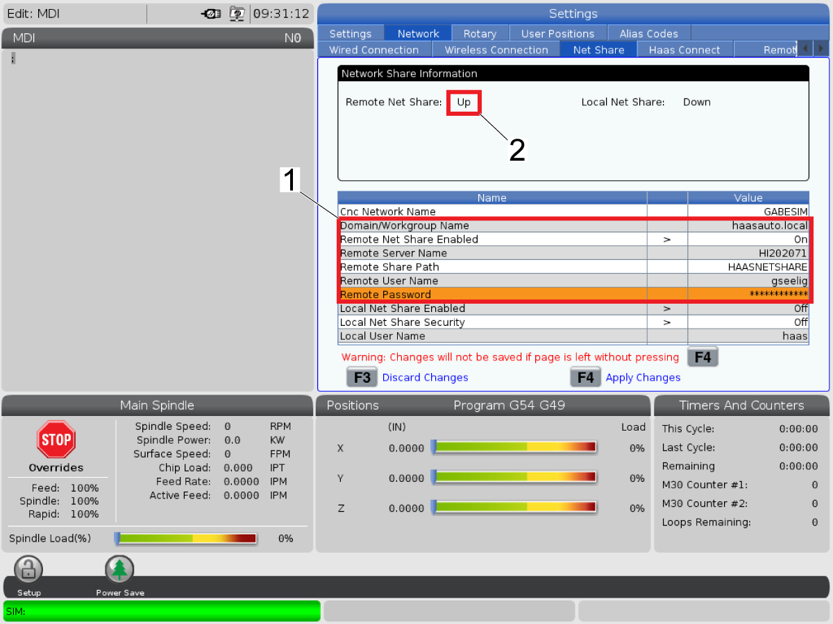

Remote Net Share Set Up
Remote Net Share is used to create a central file storage location hosted on a shop PC that can be accessed by any Haas Cnc Machine in your shop that is connected to the internet and configured for Remote Net Share.
To set up Remote Net Share:

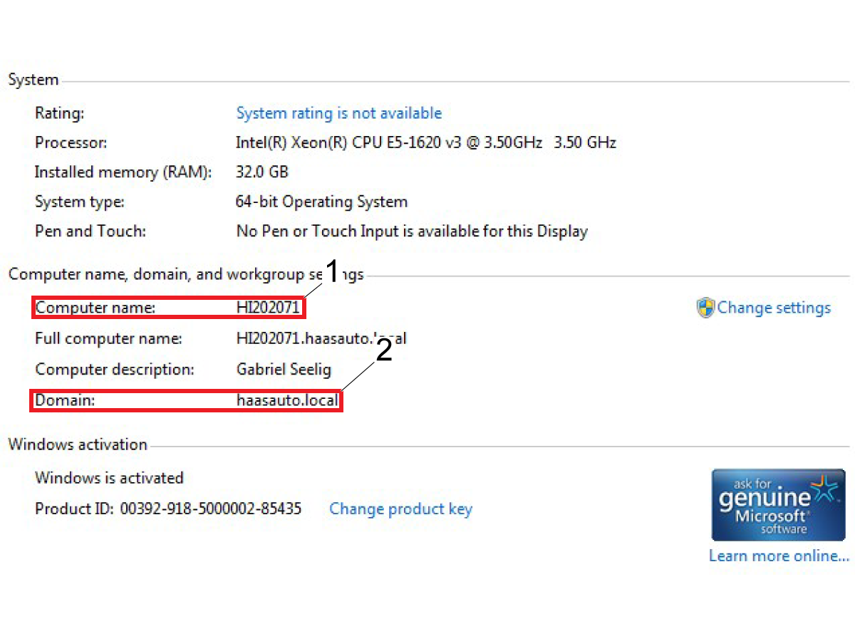

Click the "Start" button [1].
Right click computer [2] and click properties [3].
Note the Computer Name [1] and the Domain / Workgroup name [2].

Enter the Domain / Workgroup name into the Domain/Workgroup Name field.
Note: Maximum character length for the Domain Name is 15 characters or less. This includes .LOCAL if used.
Set Remote Net Share Enabled to "ON".
Enter the Computer Name into the Remote Server Name field.
Enter the name of the Net Share folder created in Step 3 into the Remote Share Path field.
Enter the username used to log into the shop PC into the Remote User Name field.
Enter the password used to log into the shop PC into the Remote Password field.
Press [F4].
Wait for the machine to configure Remote Net Share.  When configuration is complete the Remote Net Share status will change to "UP".
