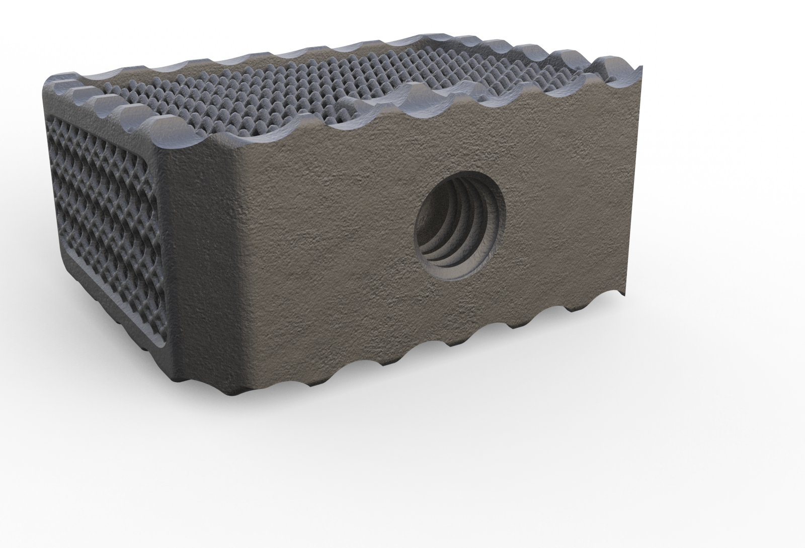

For more than a decade, Nexxt has machined its Honour and Struxxure implant lines from PEEK rods and titanium blanks using Haas machining centers. The company recently added a Haas drill-tap center to machine features into its Matrixx products, and Elsbury says fast growth in that product line will likely lead to new machine purchases soon.

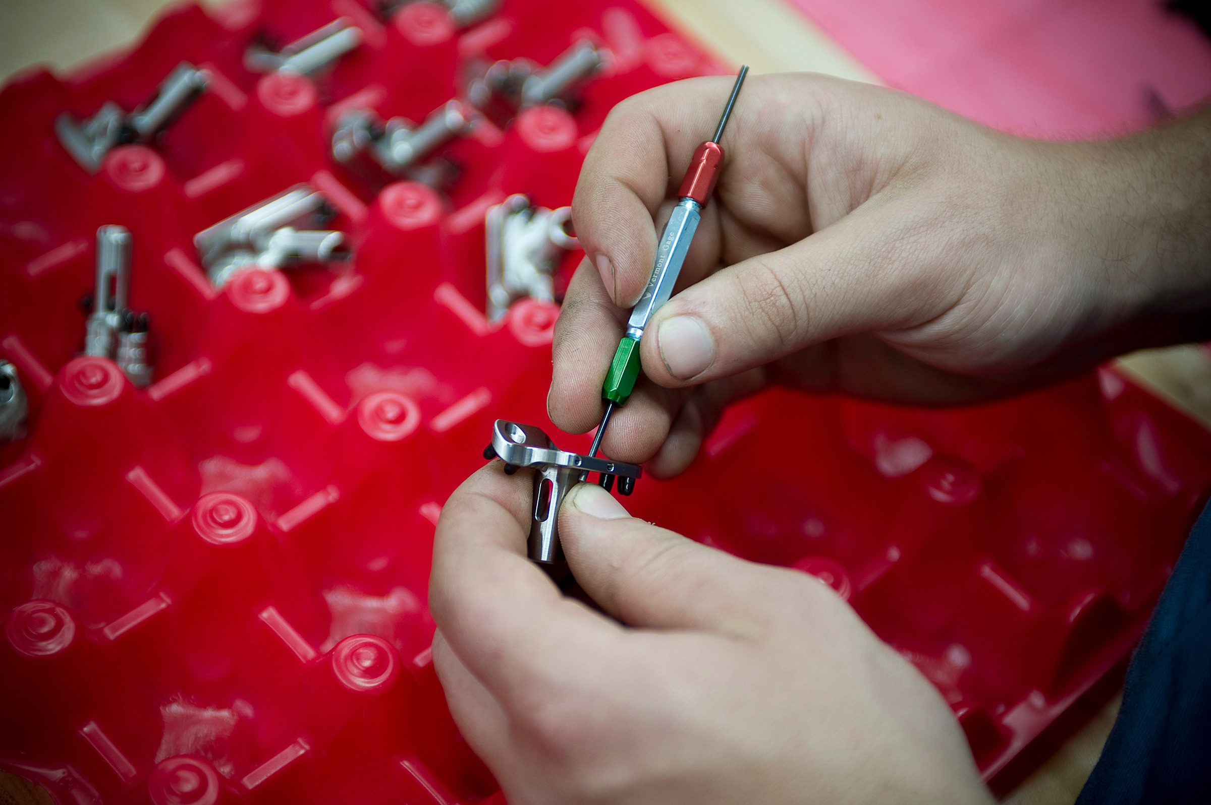

The implants use fixed or variable plates and fixed or variable screws. Fixed plates allow the screws to only go in one direction at one spot, while variable plates allow some movement around the screw head. Different surgeries require different approaches, but most implants have a mix of fixed and variable spots, all of which need to be machined to surgical-grade tolerances.
“This one plate can be used with a fixed screw, variable screw, or both. That’s why ours is, in my opinion, the best,” Riser adds. “We have sold thousands upon thousands of these things, and we’re getting very good feedback from the doctors. It’s working well for the patients.”

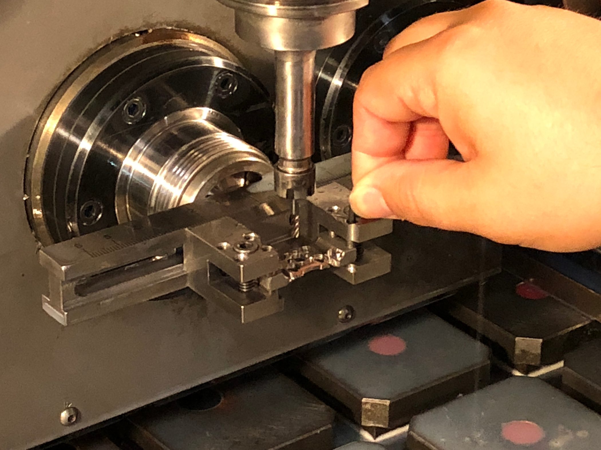

Nexxt machinists can make two pieces simultaneously on their Haas CNC equipment, programmed with Mastercam software. Careful material handling policies mean PEEK parts use metal fixtures, and titanium parts use plastic ones. All pieces are machined dry (PEEK can absorb some lubricating fluids), and employees wear gloves, so the parts don’t contact human skin until they enter the patient.
“The shortest cycle time is about half an hour,” Riser explains, adding that he uses about 15 tools for each part. “I do everything in one operation. I flip it over and do the bottom. The longest one is more than two hours.”
