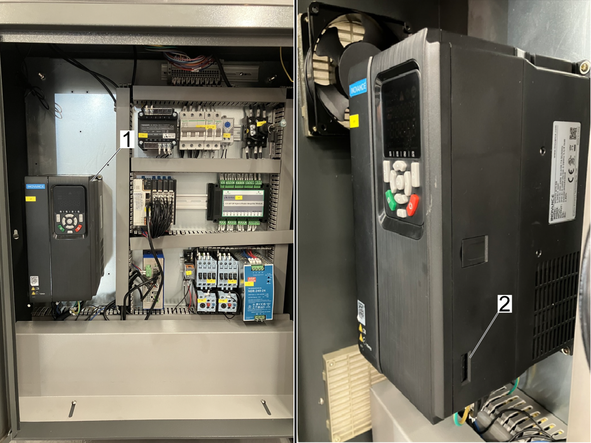

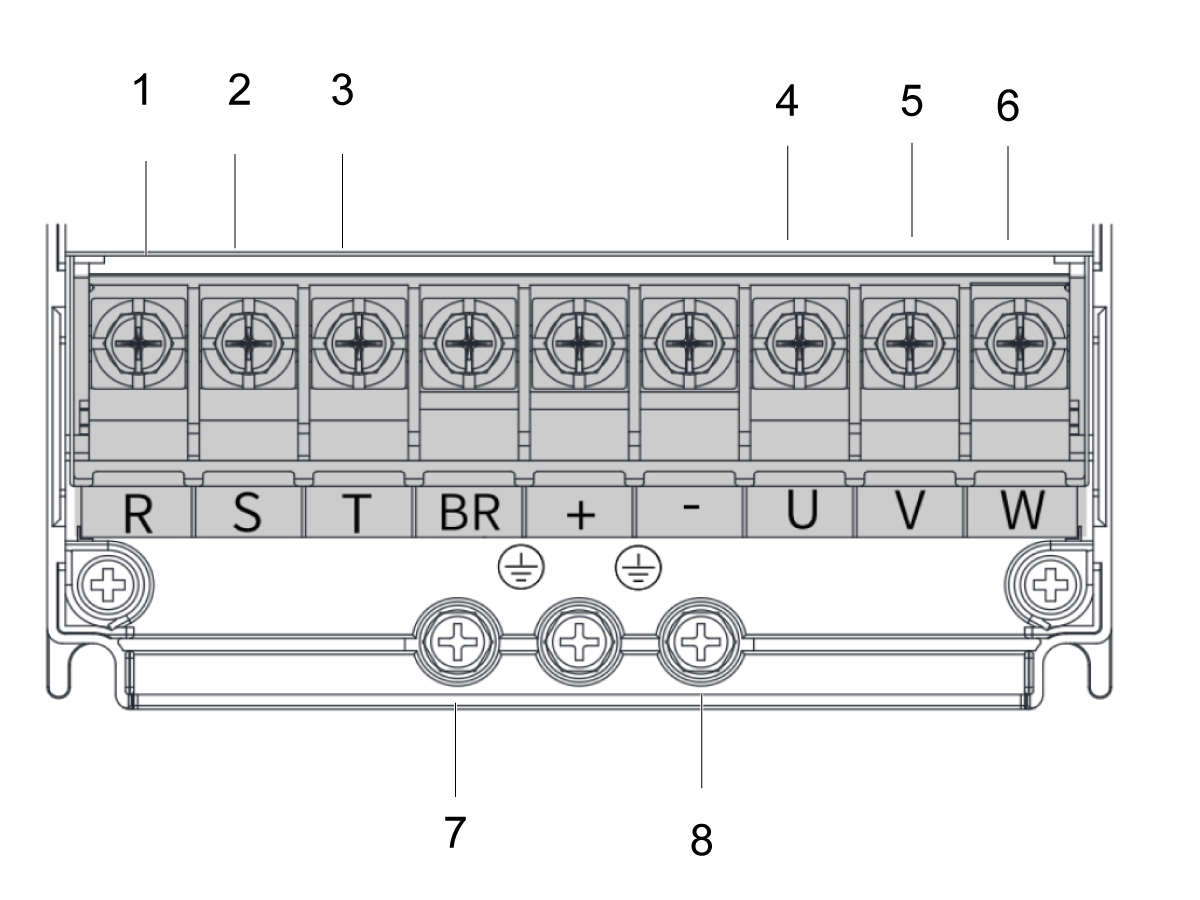

VFD - Main Terminal Wiring Inspection
Power OFF the machine and set the main circuit breaker to the OFF position.
Open the control cabinet of the machine and locate the VFD [1].
Remove the front cover by using the two push tabs found on both sides of the VFD [2].
Refer to the chart below to connect each properly labeled wire to its corresponding terminal.
Number / Terminal Cable Label
1 / (R) U
2 / (S) V
3 / (T) W
4 / (U) U1
5 / (V) V1
6 / (W) W1
7 PE
8 PE

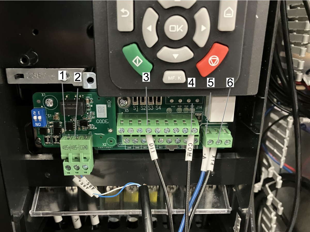

VFD - PCB Wiring Inspection
Number / Terminal Cable Label  Terminal Name
1 485+ 458+
2 485- 485-
3 D11 D11
4 COM COM
5 V- T/A
6 X14 T/B

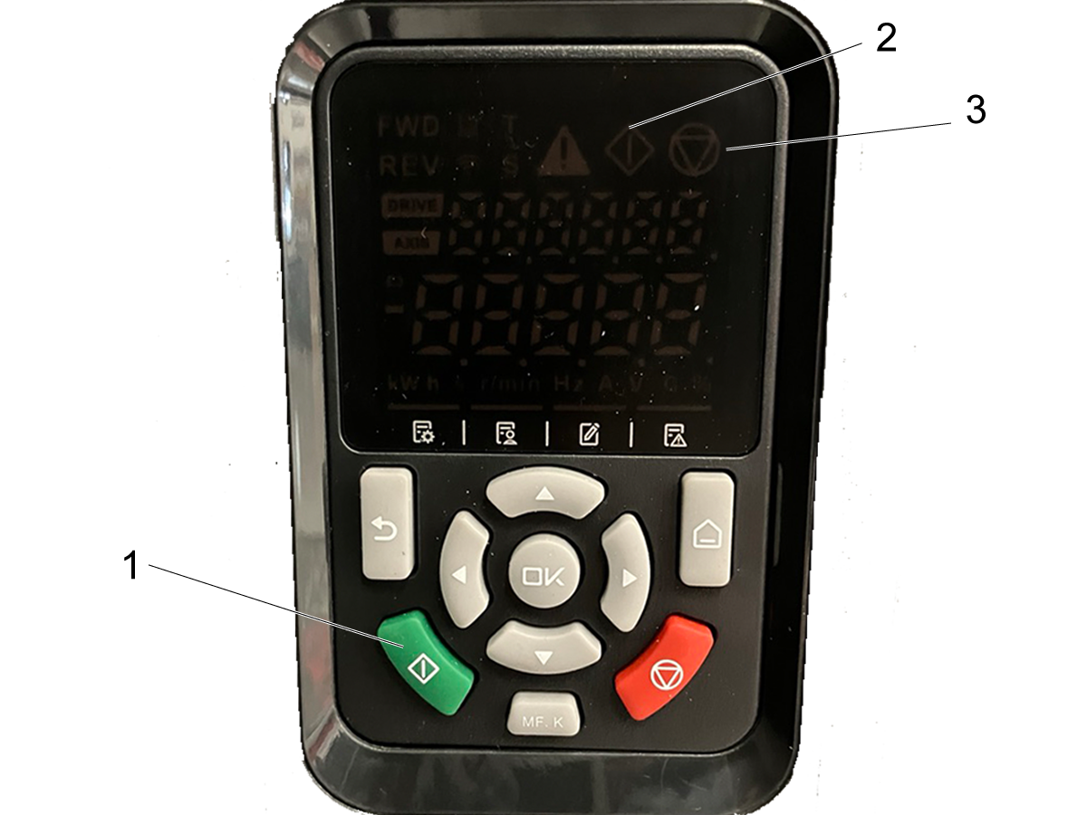

VFD - Parameter Inspection
Ensure that the VFD is Programmed correctly.
NOTE: VFD parameters must be verified when replacing the VFD.
Open the electrical control panel and turn on the machine.
To access the operations panel on the VFD , click the return arrow key [1].
Note:  Program the VFD to align with the setting values in the chart below
Navigate through different parameters using the up and down arrow keys [2].
Press OK to modify the parameter.

After entering the values from the chart above, go to parameter F1-37 and set it to 11.
Press the green confirm key [1].
Note: Motor tuning will begin. During the process, the light will turn green [2]. Once tuning is complete, the light will turn red [3].
After tuning is complete, navigate to parameter F0-02 and set its value to 1. Additionally, set the value of parameter F0-03 from 0 to 9.
