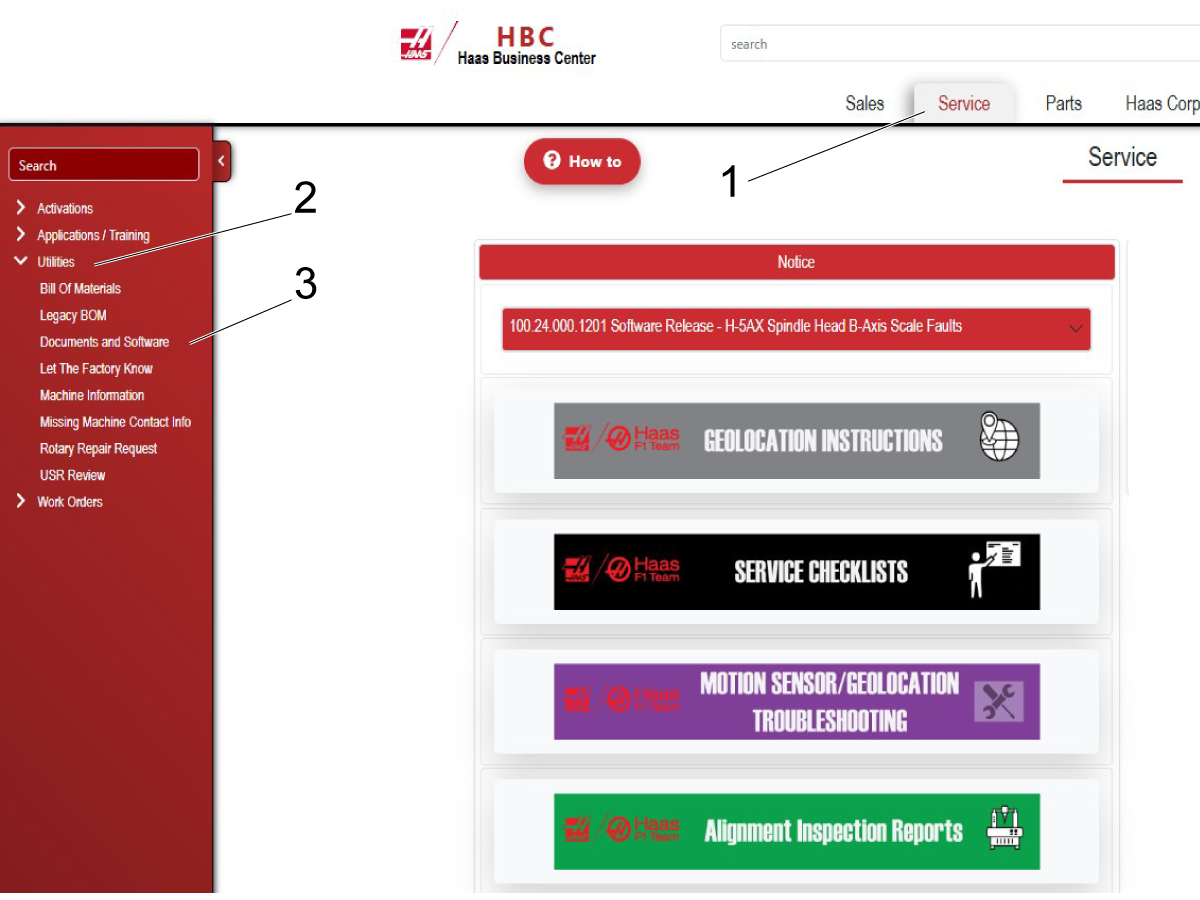

HAB - Control Software Download
Log on to the Haas Business Center.
NOTE: Only Haas Certified Service technicians can log into this site.
Select the Service Tab [1].
Select Utilities [2].
Select Documents and Software [2].
Navigate to the HAB Software Folder.
Select  15_Shop_Equipment > Bandsaw > HAB_Software > Controller Software

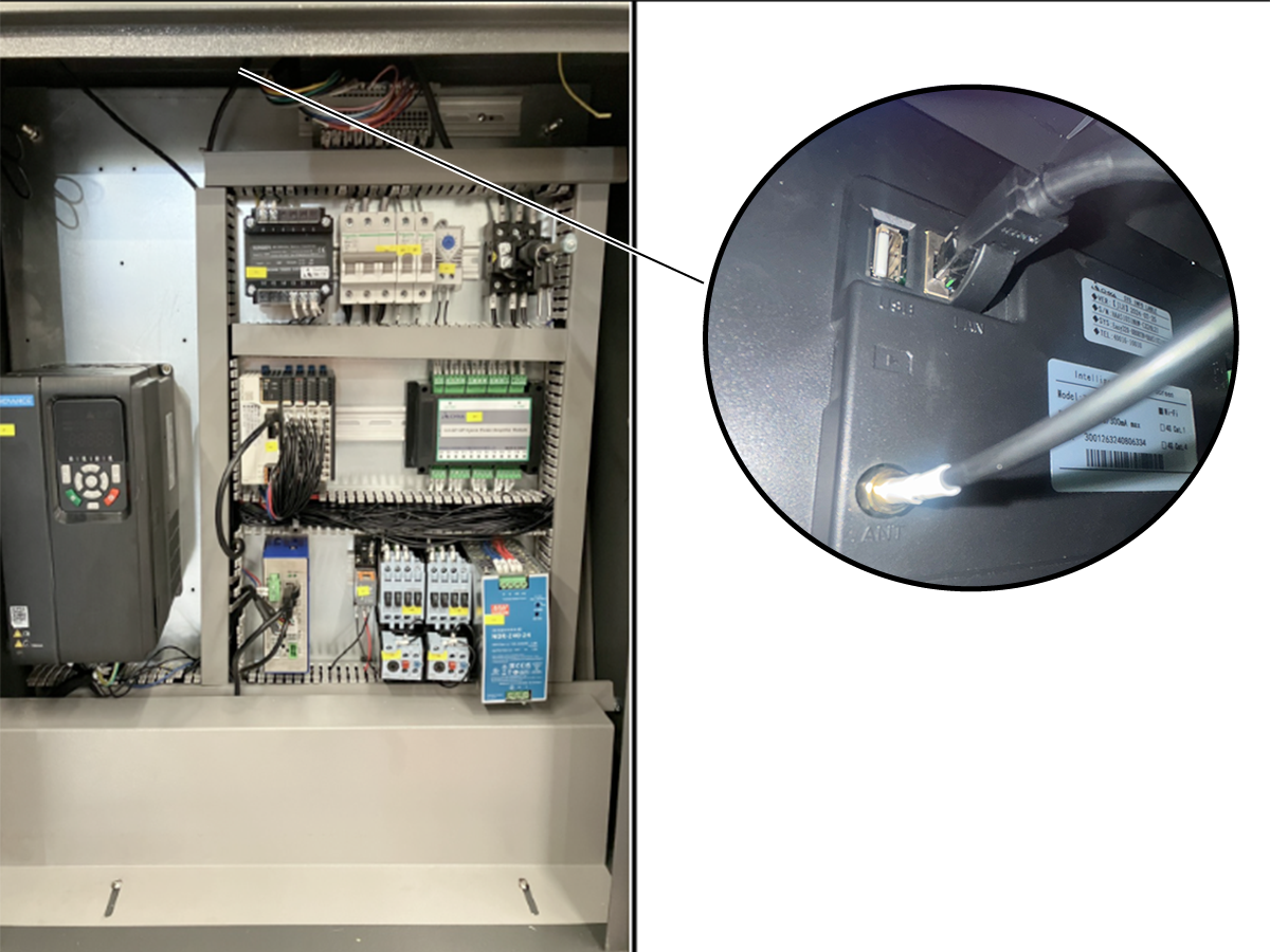

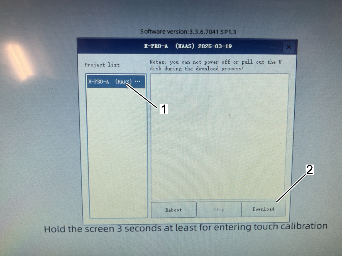

HAB - Control Panel Software Installation
Extract the folder named HAB - Control Panel Software. Inside, you'll find another folder called tpcbackup.
Drag and drop the folder titled tpcbackup onto the USB 2.0 Flash Drive.
Connect the USB 2.0 flash drive containing the folder named tpcbackup to the USB port located on the back of the control panel.
Follow the on-screen instructions to proceed with the download.
Before downloading the new software, make sure the correct files are selected [1].
Select Download [2].
When the download has completed the machine will automatically reboot.
Note: When the machine reboots, it may start up in a different language. Refer to the HAB Troubleshooting Guide for instructions on how to change the language correctly.

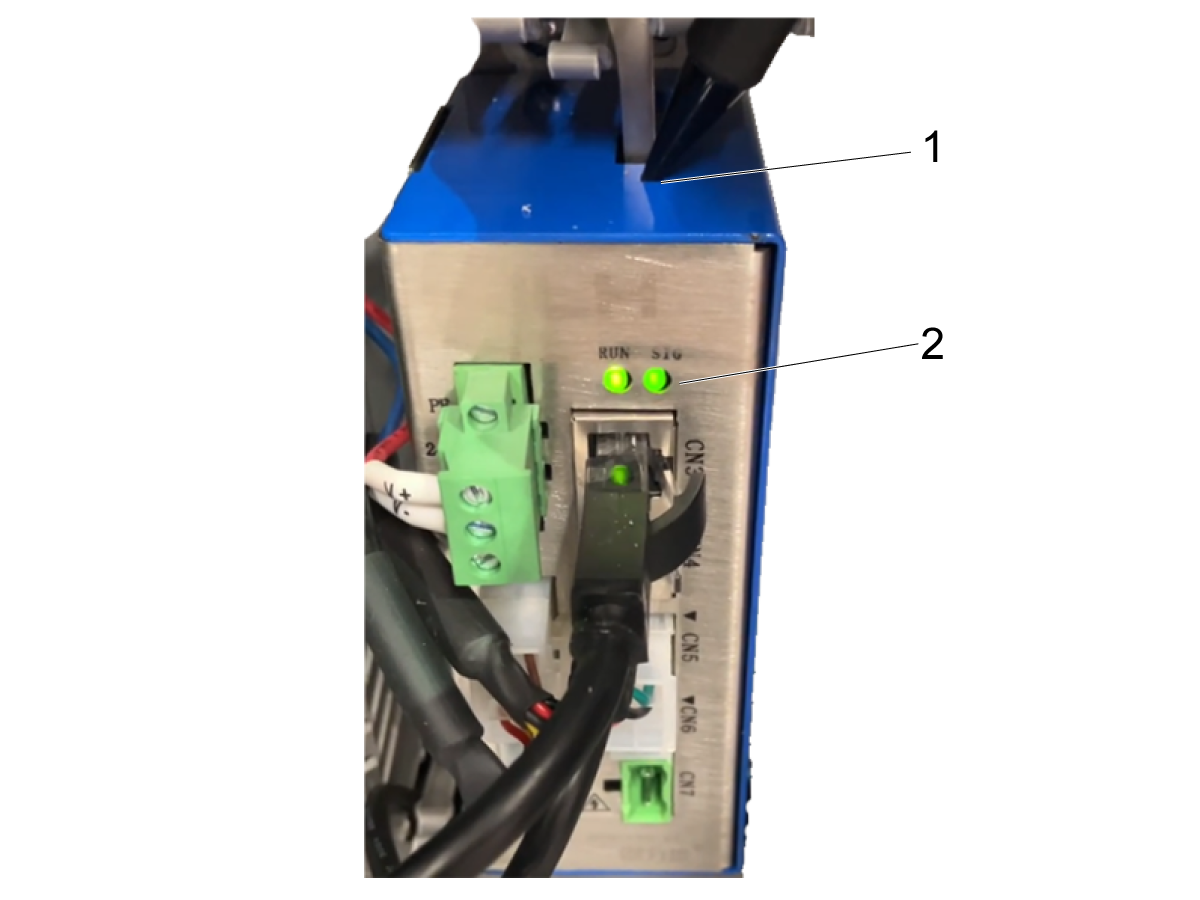

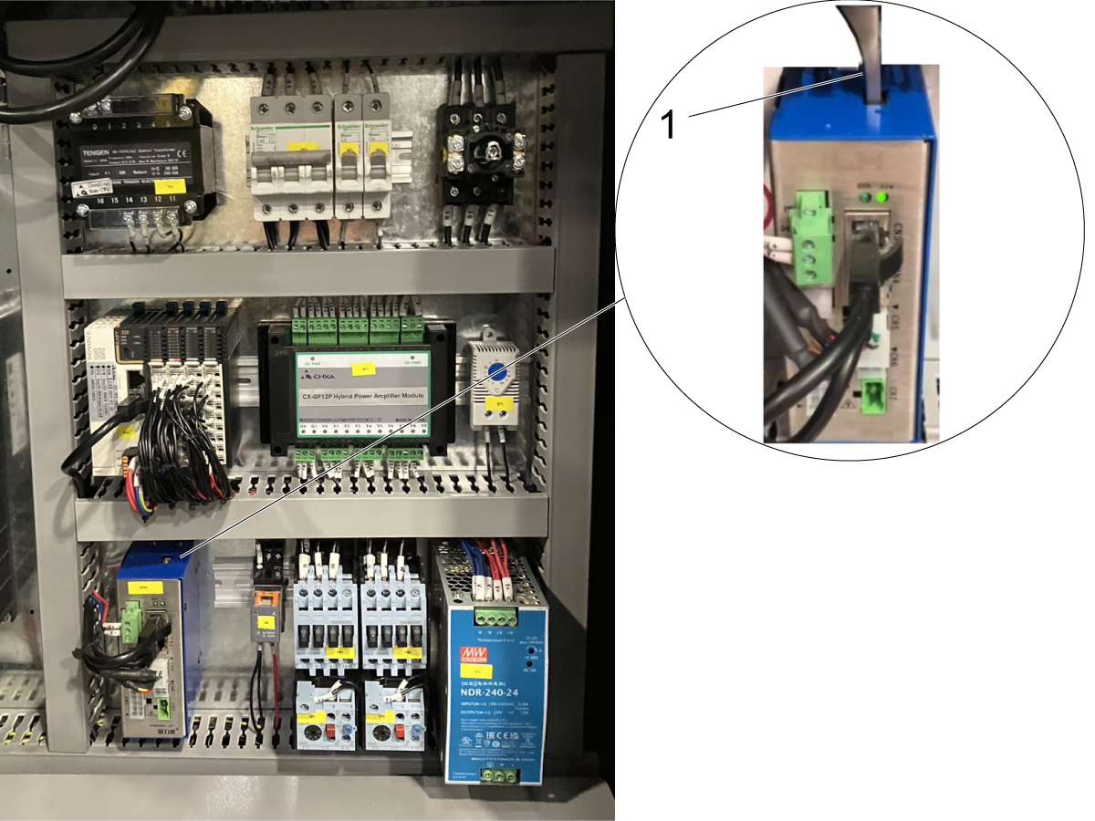

Locate the interface drive found near the bottom of the control cabinet.
The port for the USB 2.0 flash drive can be found at the top of the drive [1].
With the USB plugged into the drive, press and hold the Upgrade Button found on the top [1].
Hold the button until both lights glow green, then release.
Note: When the upgrade is completed, the two lights will resume flashing alternately.
Note: To confirm the update was successful, go back to the Advanced Functions, navigate to Machine Information, and check the intelligent version. The intelligent version should be updated for the procedure to be considered successful.

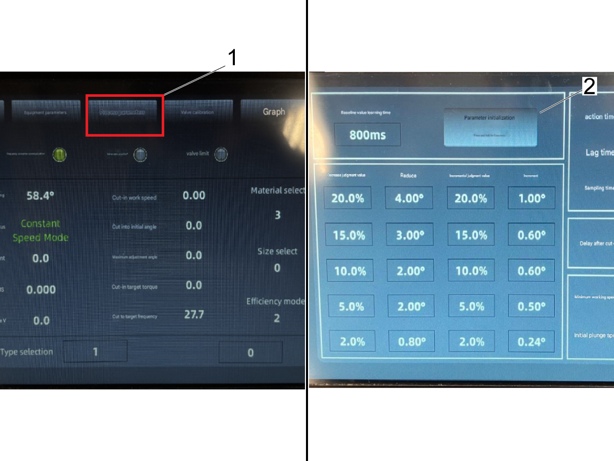

HAB - Controller Software Initialization

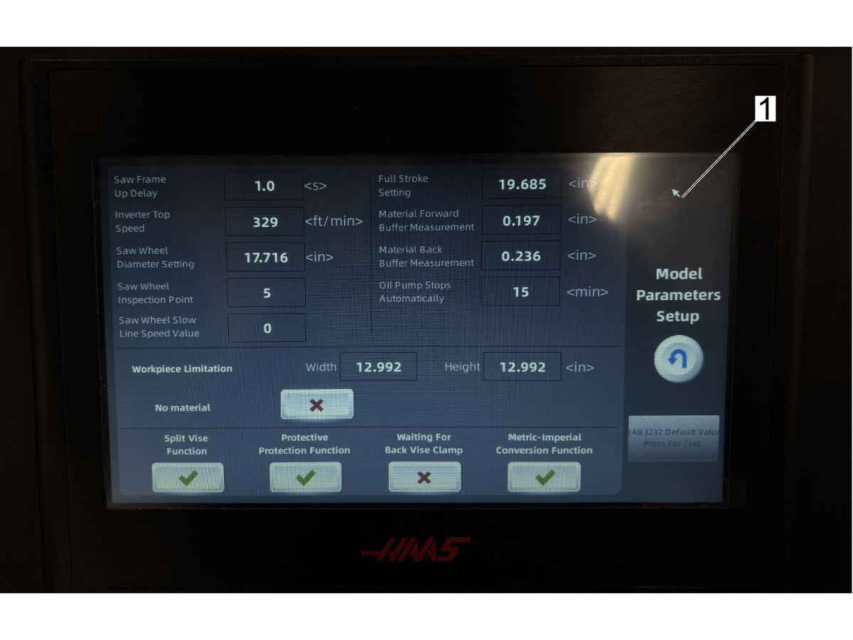

After the interface drive has been updated, the new parameters must be initialized on the control panel.
Select Advanced Functions
Navigate to Type Parameter and enter the password 123.
Once inside the Type Parameters page press and hold the blank space [1] for 5 seconds until a hidden interface page will appear.
After navigating to the hidden interface page:
Select Process Parameters [1].
Select and hold Parameter Initialization [2].

Power on the band saw and enter the bandsaw into manual mode.
Select Advance Functions found at the bottom of the display page.
Once inside the parameters page press and hold the blank space [1] for 5 seconds until the hidden interface will appear.
Before proceeding, it is important to verify which transmission module is found in the band saw.
Locate the side cabinet found directly behind the electrical cabinet.
Important:
[1] Will be established for the 1st generation
[2] Will be established for the 2nd generation.
