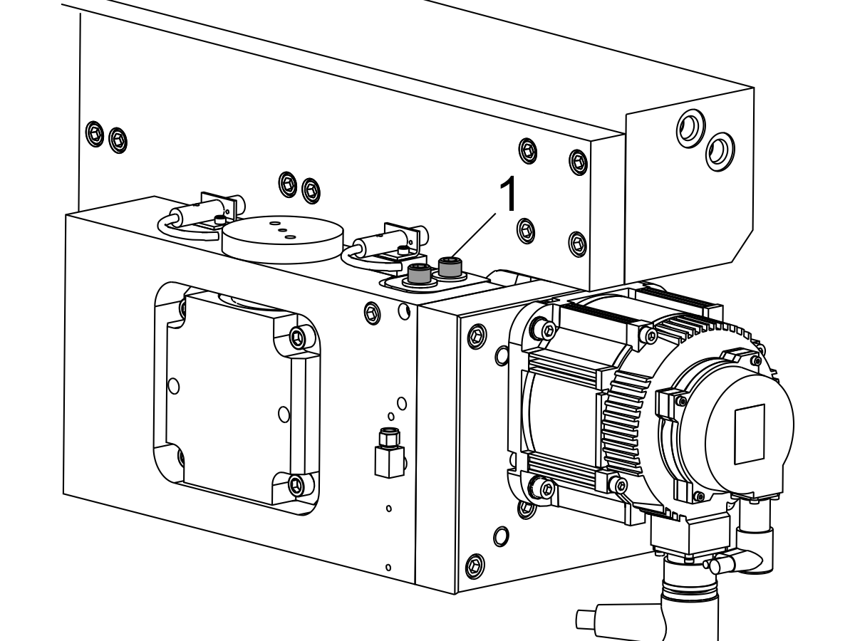

Disconnect the air supply hose to the C Axis actuator block [1].
Connect the air supply hose to the air regulator.
 Note: For an SL Lathe, set the air pressure on the regulator to 45 PSI. For an ST Lathe, set the regulator to 85 PSI.
Open the cutoff valve to engage the C Axis.
Loosen the (2) stop block lock down screws [1].
Remove the stop block adjustment screw [1].
Apply one drop of medium-strength thread locking compound to the stop block adjustment set screw.
6
Install the stop block adjustment set screw.
 Note: DO NOT tighten the stop block adjustment set screw.

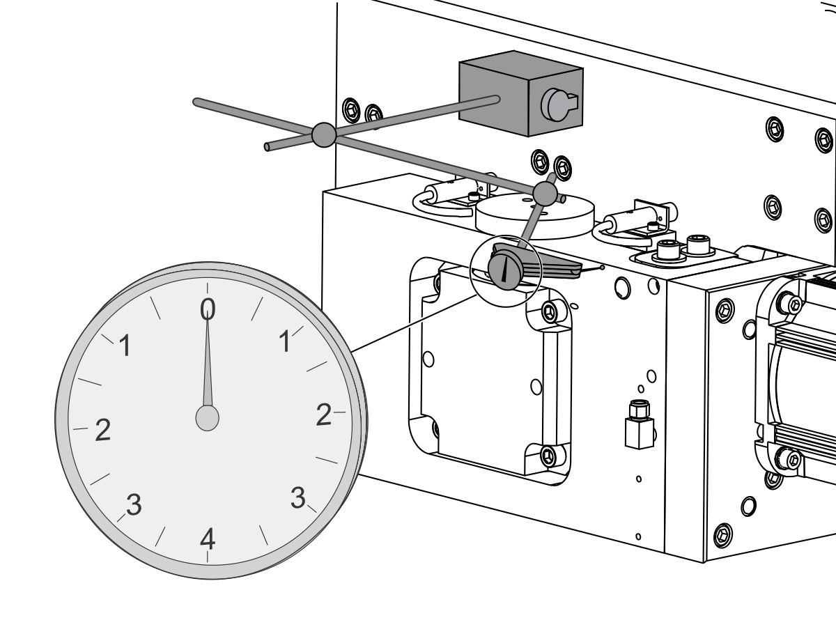

Place a magnetic base indicator on the spindle head [1] and rest the indicator tip of the pivot block [2].
Handle Jog the C Axis 360 degrees and look at the indicator.
Find the highest point then adjust the stop block adjustment set screw.
Gear runout NTE 0.0001".
If gear runout is out of specification, refer to the C Axis Grid Offset Adjustment procedure and the installation section of the C Axis Motor, Brake Caliper, Rotor and Rotating Hydraulic Cylinder Replacement procedure.

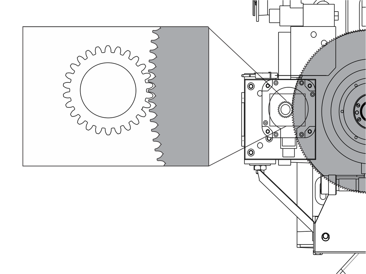

8
If the grid offset and servo motor installation are correct and the runout is more than 0.0001" over 360 degrees, inspect the C Axis gears for damaged teeth.
9
When the runout is correct, set the indicator to zero at the lowest point of the runout.
10
Tighten the adjustment screw until the pivot block is 0.0005" away from the gear mesh contact point at the highest point.

Torque the stop block screws to 35 ft-lb (47 Nm).
12
Disconnect the air supply hose from the air regulator [1].
13
Connect the air supply hose to the C Axis actuator block [1].
