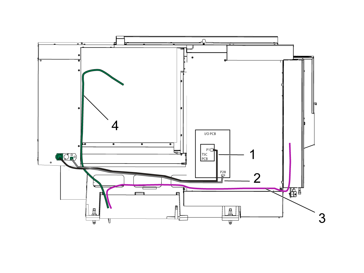

Route the HPC extension [1], vacuum sensor [2] cables
Route the purple tube from the lube panel to the coolant tank.  Make sure to leave enough slack at each end.
Route the high pressure hose, following the same routing as the blue coolant hose.
Connect the HPC extension cable to P1 on the HPC motor-drive PCB
Connect the vacuum sensor to P28 on the I/O PCB.
Install the receptacle end of the cable to the receptacle bracket. Use the twist lock mount and the screws.
Install the vacuum sensor cable to the receptacle bracket.

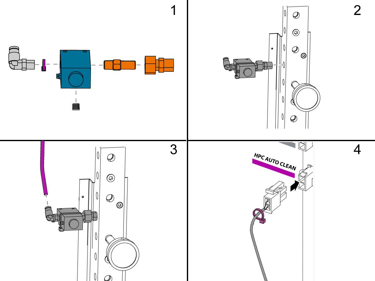

Turn off the air to the machine. Assemble the solenoid assembly [1].
Remove the plug from the air manifold. Install the solenoid assembly [2].
Trim the purple tube to the correct length. Connect the purple tube [3] to the air solenoid.
Connect the cable for the solenoid [4] to the connector panel label "HPC Auto Clean".

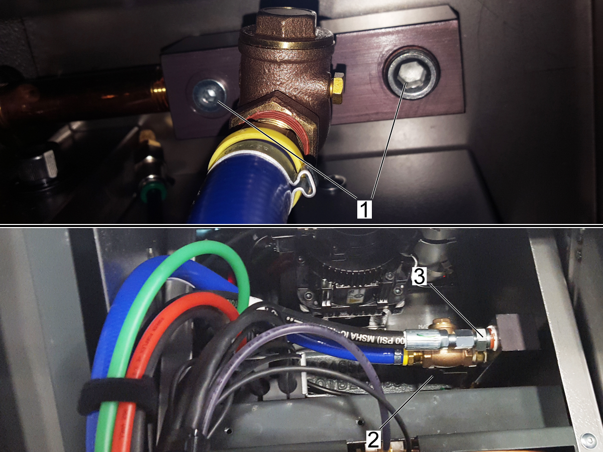

Remove the plugs [1] from the coolant manifold.
Install the coolant pressure sensor [2] to the coolant manifold.
Connect the M12 cable label "HPC Pressure sensor" to the coolant pressure sensor.
Install the fitting for the high pressure hose.
Connect the HPC hose [3] to the fitting.
Secure the HPC hose [1] with a hose clamp and velcro strips [2].

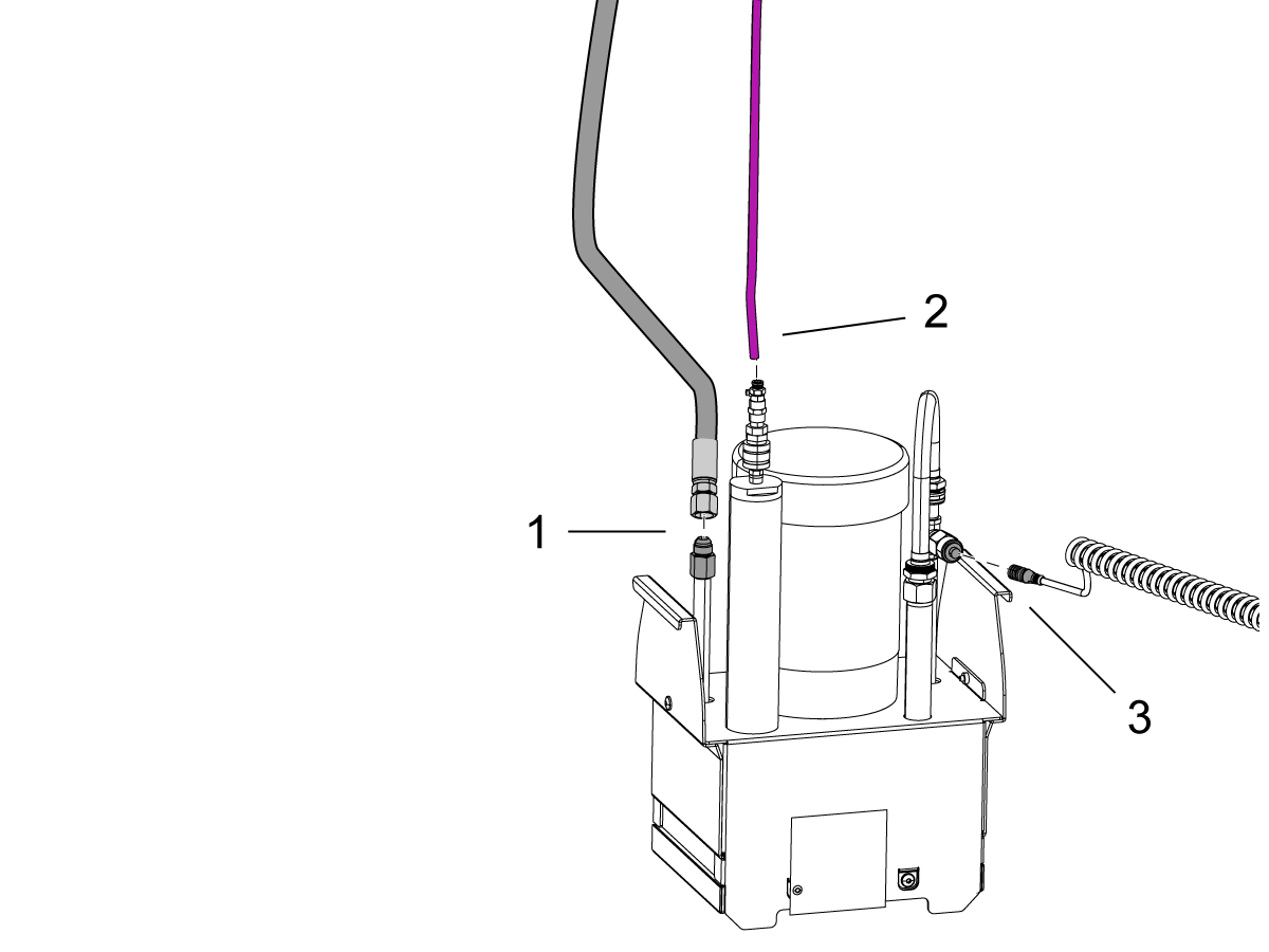

Install the HPC pump into the integrated coolant tank.
Connect the HPC hose [1]  to the HPC pump.
Connect the purple hose [2] to the air fitting.
Connect HPC filter sensor [3] to the HPC pump.
