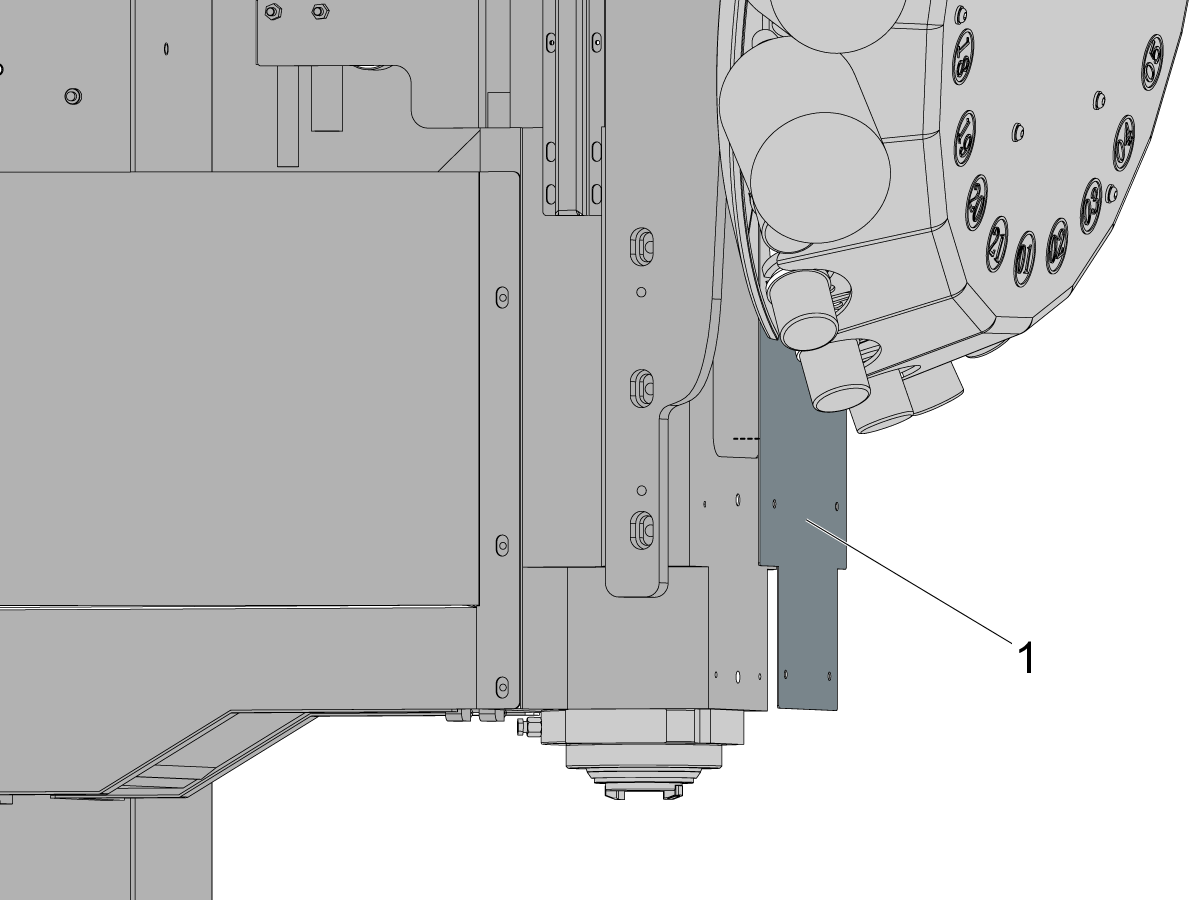

Important: The tool carousel is not shown in the images in this procedure to clearly show what is happening in each step. Do not try and alter the carousel in any way during this procedure. The spindle can be replaced with the carousel in place.

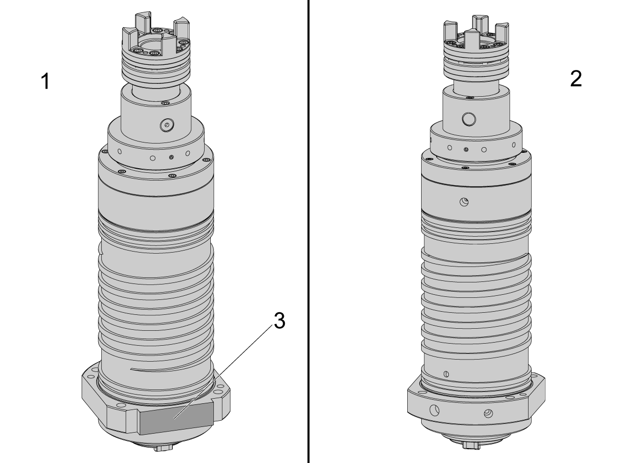

The image shows what the spindle looks like on a DC-1 30T machine. The front [1] and back [2] of the spindle can be identified by locating the flat face [3] which is on the front of the spindle assembly.

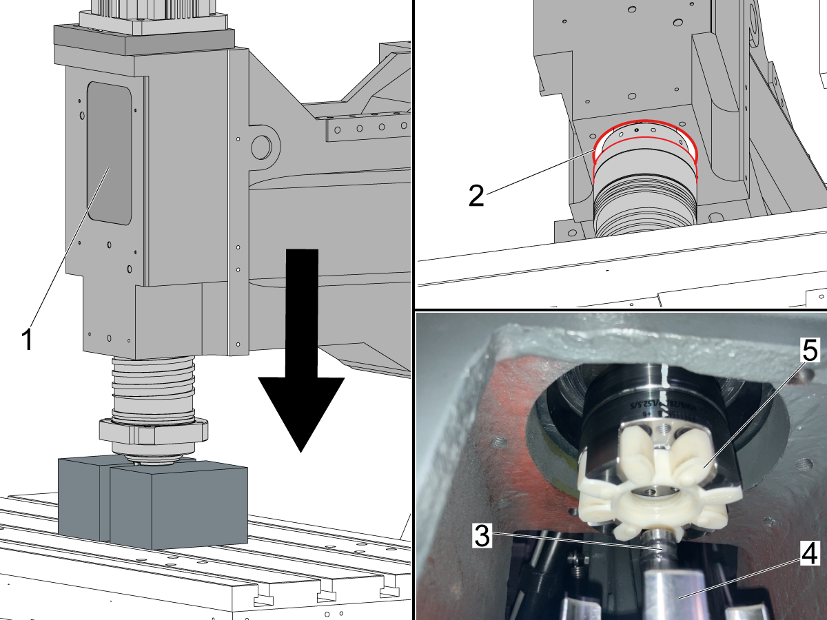

Start by removing the front and back plastic covers from the tool carousel. This will help with visibility and access to the spindle head where the spindle motor and spindle are coupled together.
Remove the front plate [1] that covers the access hole in the spindle head casting.
Note: The coupler between the spindle and spindle motor does not need to be removed from either side. Do not try and remove the coupler.

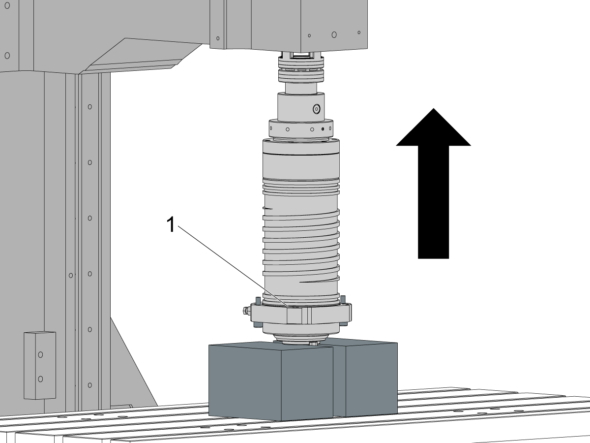

Place some blocks [1] on the table of the machine.
Jog the Z-axis down towards the blocks until there is about a 1/2" - 1" gap between the face of the spindle [2] and the blocks.
Leave a gap between the blocks [3] wide enough for the spindle drive dogs so that the spindle can sit flush on the blocks when removed.
Note: The spindle will not fall quickly out of the casting. The blocks are there as a precaution and act as a rest for the spindle instead of sitting it on the table.

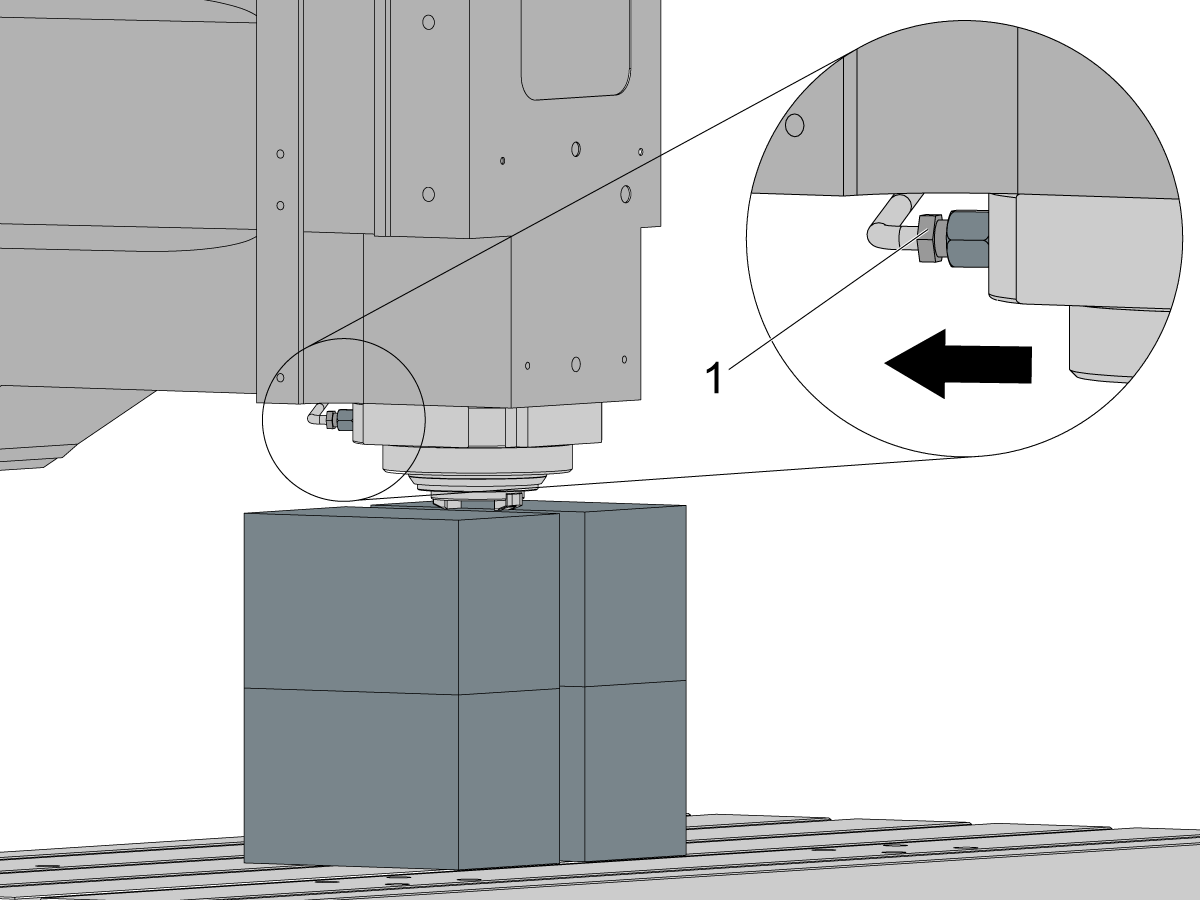

There is a line that feeds to the bottom of the spindle. Disconnect the line [1] using an open ended wrench.
Once the fitting is loosened, slightly bend the line so that the male fitting is not resting inside the female fitting in the spindle.
Note: When the spindle is removed, the fitting could get caught and the line could get damaged. Make sure the line going into the spindle head is free from the spindle before moving on.

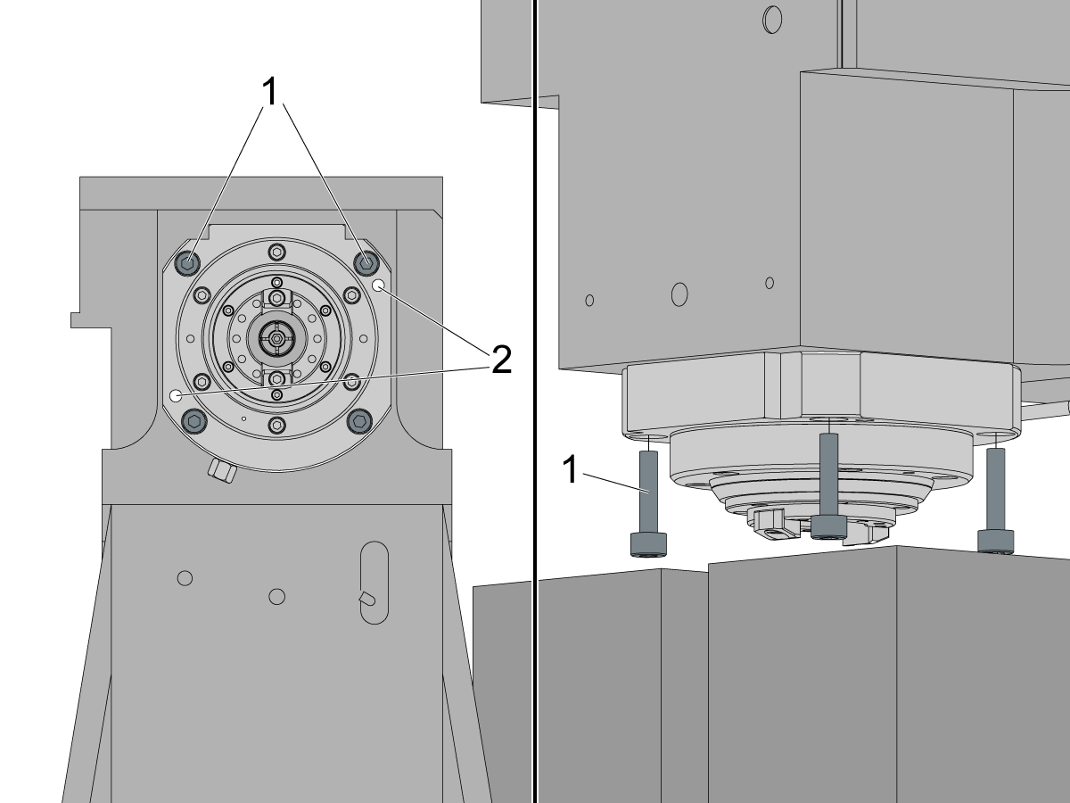

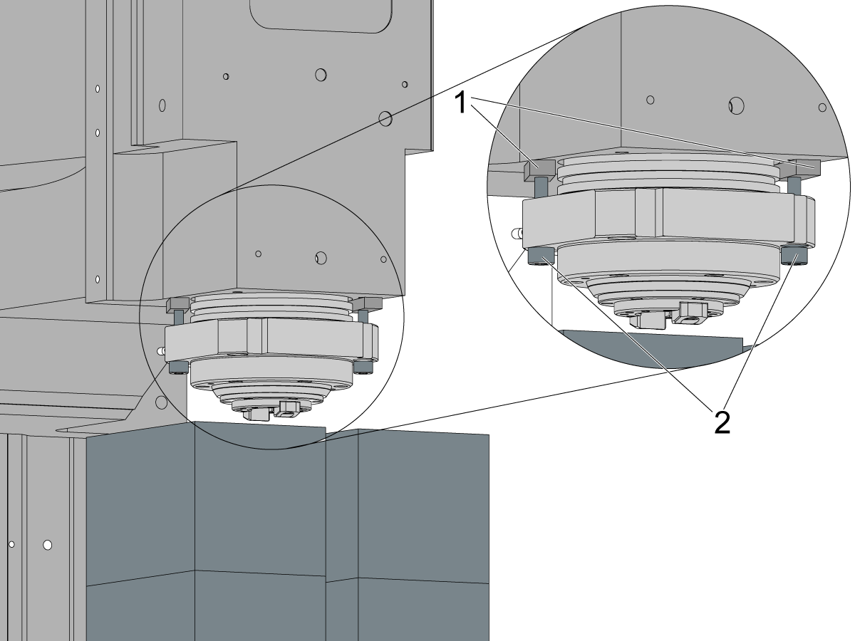

With the spindle about an inch from the blocks on the table, start loosening the 4 mounting bolts [1] that fasten the spindle to the head casting.
Remove the screws from the spindle one at a time. Keep these screws. They are not only used to mount the replacement spindle, but they are used in the next step to separate the spindle from the casting.
Note: The spindle should not drop out of the casting on its own. Even with no bolts holding it in place the spindle still needs to be jacked off of the casting.
Important: The 2 holes [2] on the spindle face are used to jack the spindle away from the casting. The next step covers how these holes are used.

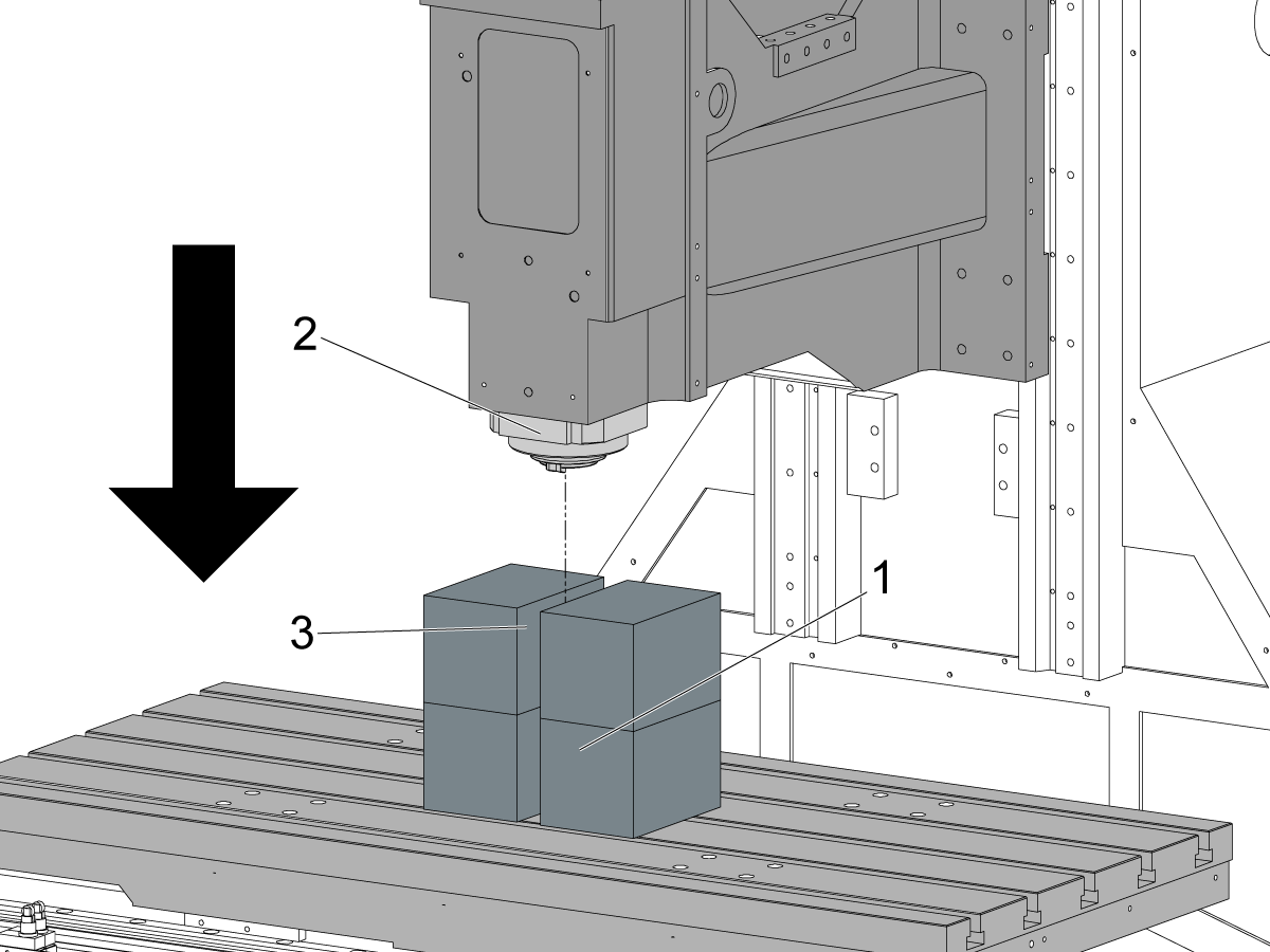

Pull the spindle down until it is resting on the blocks [1] placed on the table.
Then slowly jog the Z-axis up about 1" and then pull the spindle down to the blocks.
Repeat this process of incrementally jogging the Z-axis higher, and then pulling the spindle out more.
Keep an eye on the coupler between the spindle and the spindle motor. You should clear the motor end of the coupler after a few repetitions of this.
Note: As the spindle is pulled more out, you may start to reach the Z-axis zero position, limiting the ability to jog the head up. Change the height of the blocks on the table so that you can get the spindle free of the casting.
Note: The spindle assembly weighs around 40 lbs. It can be lifted in and out of the machine by hand.

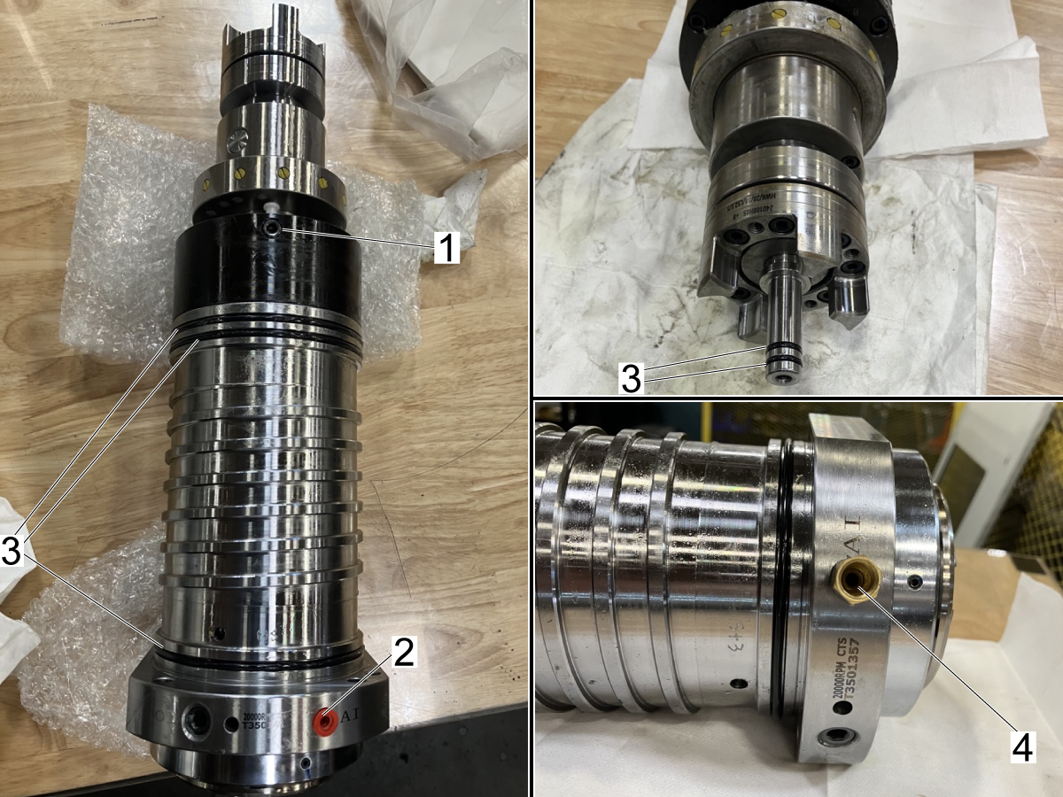

Install the transfer tube into the new spindle. A transfer tube should come with the spindle.
Make sure the transfer tube is fully seated in the spindle. Then put some silicon grease on the  O-rings on the transfer tube [3].
Inspect the new replacement spindle. Verify the following:
  • Make sure that all O-rings [3] are on the spindle/transfer tube and in good shape
  • Make sure that there is a plug [1] located on the upper part of the spindle.
  • Make sure that the red plug [2] on the bottom is there.
Remove the red plug from the bottom of the spindle [2] and insert the fitting [4] from the spindle being replaced. This will get connected to the hard line coming from the spindle head.

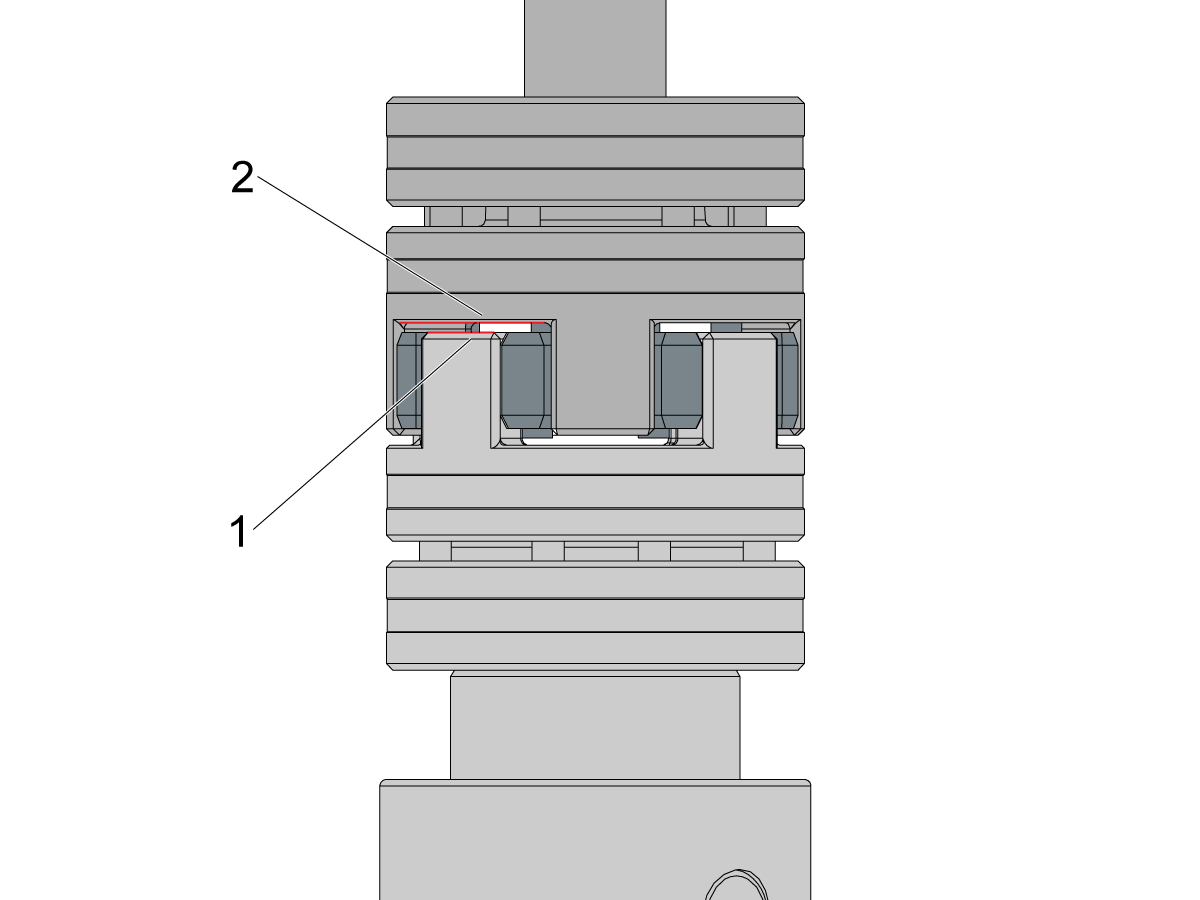

Check the gap between the spindle coupler teeth [1] and the motor side of the coupler [2].
Note: Before you check the gap, make sure that the motor mounting bolts and the spindle mounting bolts are torqued down.
The gap between the coupler should be 3.0mm. To verify the gap, use a feeler gauge to check the distance between the coupler. If you can fit a gauge bigger than 0.119" between the coupler (surfaces [1] and [2] in the image) then verify that all mounting bolts are torqued correctly.
Note: Contact Haas Service if the spindle coupler teeth bottom out on the motor coupler, or if there is an excessive gap between the motor and spindle parts of the coupler.
