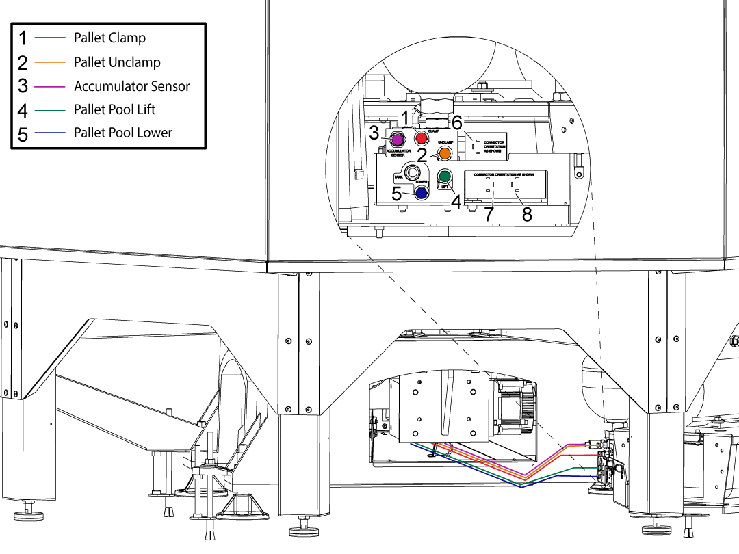

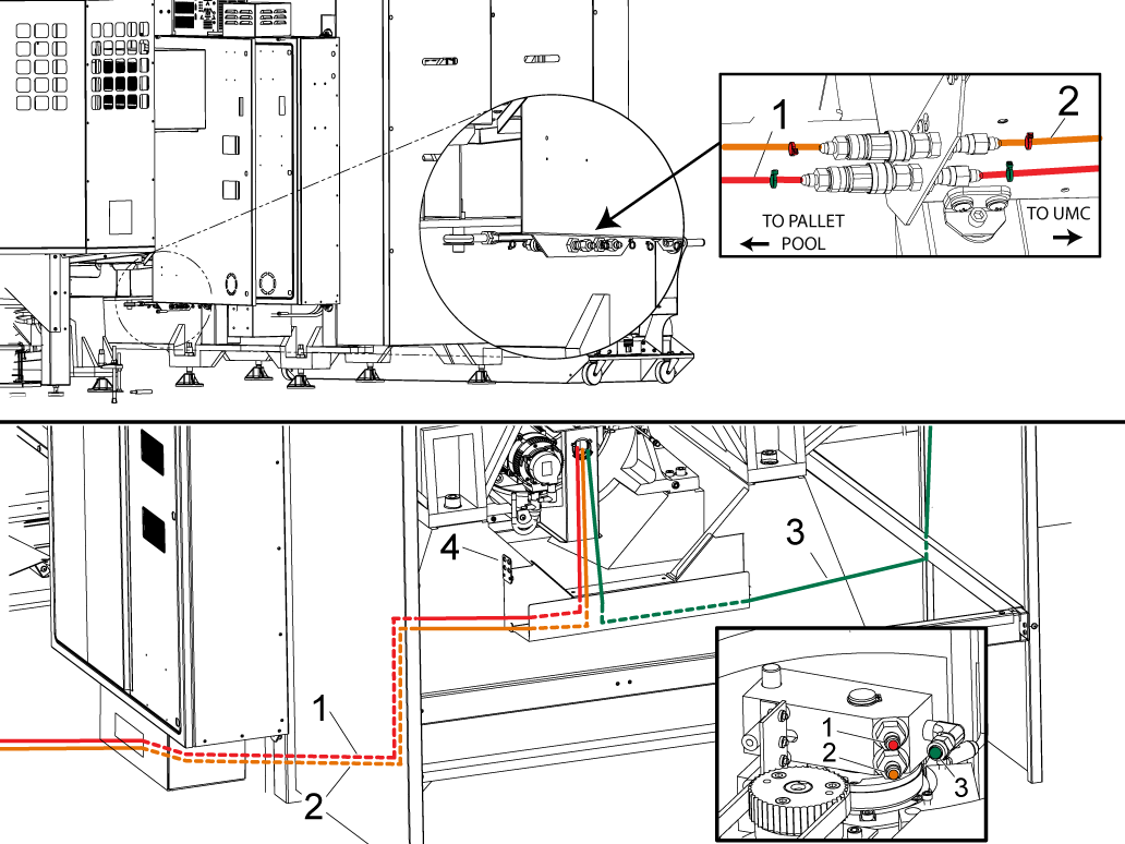

Route the Pallet Clamp [1] and the Pallet Unclamp [2] hydraulic lines from the back of the B anc C axes assembly to the HPU manifold and connect to the corresponding ports.
Route the Pallet Pool Lift [3] and Pallet Pool Lower [4] hydraulic lines from the pallet pool to the HPU manifold and connect to the corresponding ports.
NOTE: The lower port is the hole closes to the edge of the lift/lower cylinder.
