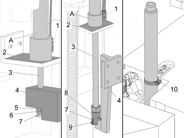

Install the hydraulic cylinder [A] from the top of the column.
 Caution: Make sure the hydraulic hose connection [1] faces the same direction as the one that was removed.
To connect the hydraulic cylinder to the lift bracket:
  • Small/medium mill
    • Pull the piston shaft [3] through the lift bracket [4].
    • Install the washer [5] and (2) jam nuts [6].
    • Install the cotter pin [7].
  • Large mill
    • Pull the piston shaft [3] down until the clevis [8] fits over the lift bracket [4].
    • Install the clevis pin [9].
Install and tighten the band clamp [10].

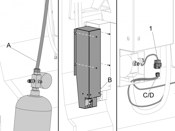

Remove the tank assembly from the column.
Remove the tank from the mount.
Install the hose from the new hydraulic cylinder [A] onto the new tank.
Put the hydraulic tank into the tank mount.
Install the hydraulic tank [B] onto the column.

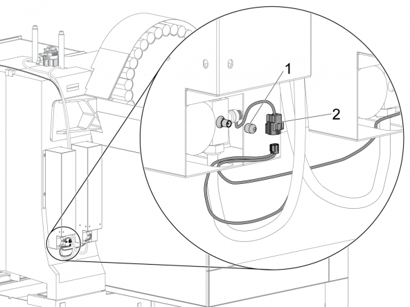

Look at the connector on the pressure sensor cable installed in the machine.
  • If the connector is the same as the connector on the tank [1], use the installed cable.
  • If the connector is not the same as the connector on the tank [1], discard the installed cable. Install the pressure sensor cable [C] or [D] from the kit.
Connect the two-pin end of the pressure cable to the pressure switch on the tank.
With your fingers, tighten the gas chuck [1] on the charge/discharge kit to the Schrader valve [2].
 Note: Make sure you turn the T-handle of the gas chuck fully counterclockwise.
 Note: If your system has a double-ended tank system, a second Schrader valve is at the top of the tank(s). Use the bottom valve.
Attach the other end of the hose to the source pressure [3].
Slowly pressurize the system to the correct value. Refer to the chart at the end of this procedure.
Power up the machine.
Push [ZERO RETURN]. Push [Z]. Examine the tank and hoses for leaks or abnormal noises. Make sure the tank pressure is correct at the top of travel. Add nitrogen if necessary. Remove the charging system. Replace the valve cap.

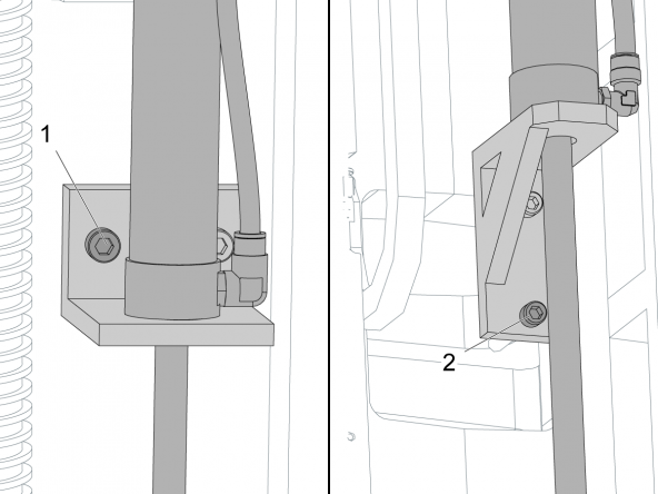

Loosen (1) screw on the cylinder mounting bracket.
Make sure the screw is sufficiently tight to hold the cylinder in position, but sufficiently loose to let you make the adjustment.
The illustration shows the cylinder mounting bracket for a large mill [1] and for a small or medium mill [2]
Make sure the (2) screws [1] on the bracket are sufficiently tight to hold the cylinder in position, but sufficiently loose to let you make the adjustment.
