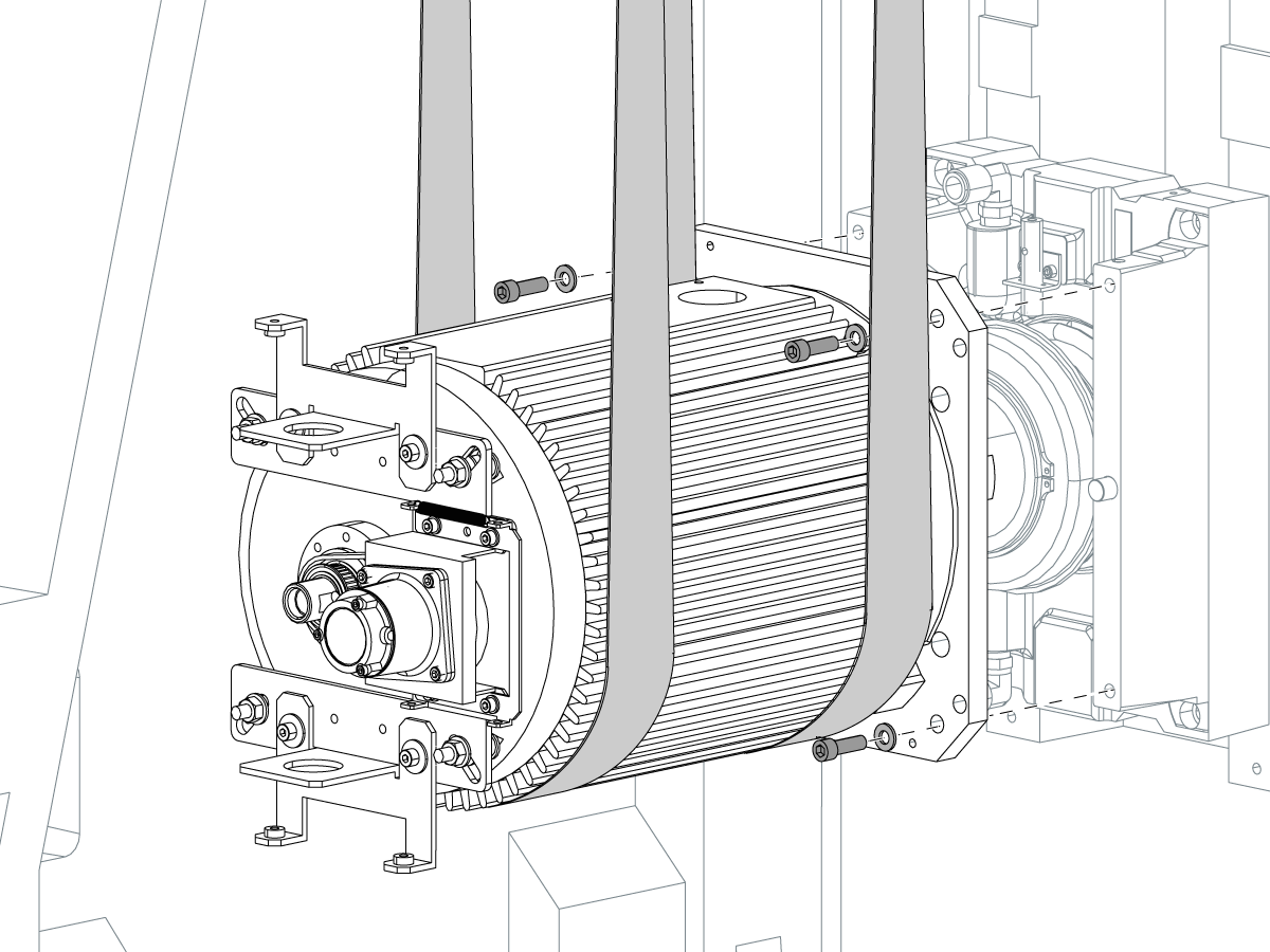

For older style motors use attach (2) lift straps to the motor assembly.
CAUTION: The motor assembly weighs 150 lb (68 kg). Make sure to use a lift of the correct capacity.
Remove the (4) screws that hold the motor assembly to the tool release piston (TRP).
Remove the motor from the machine.

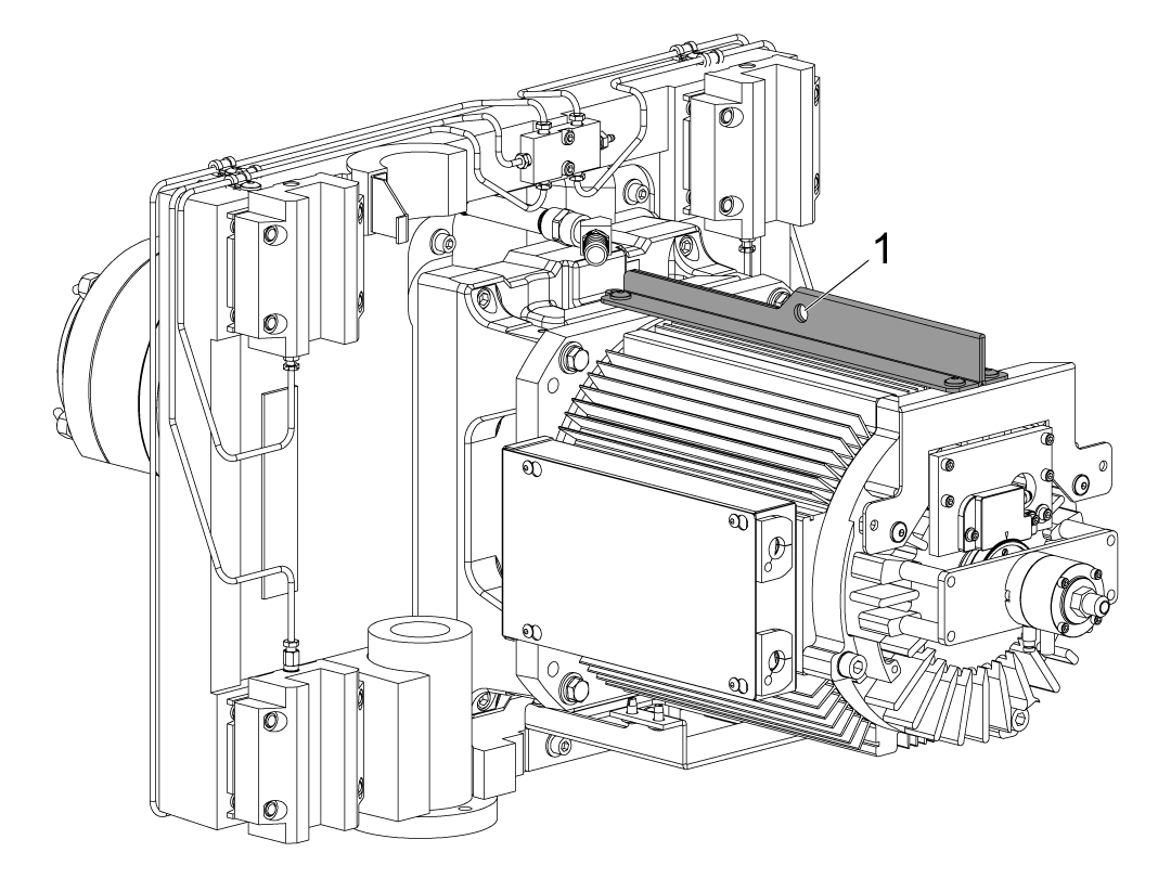

For newer style motors there is a lifting bracket [1] mounted to the motor, attach the lifting apparatus to the lifting hole.
CAUTION: The motor assembly weighs 150 lb (68 kg). Make sure to use a lifting apparatus of the correct capacity.
