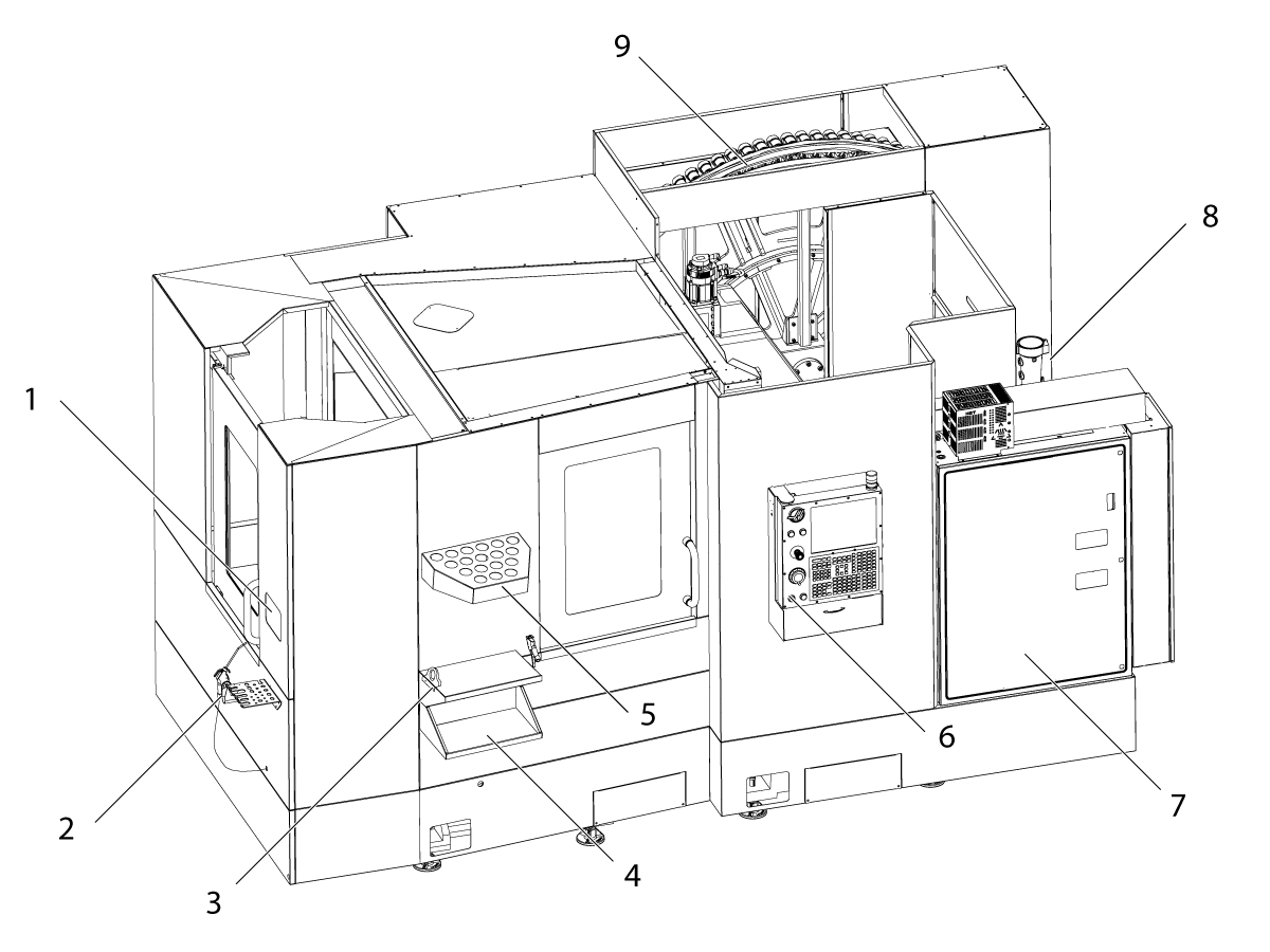

Horizontal Mill Features (EC-400/EC-500, Front view)
  1. Load Station Emergency Stop
  2. Air Gun
  3. Tool Holding Vise
  4. Front Table
  5. Tool Crib
  6. Control Pendant
  7. Electrical Cabinet
  8. Coolant Filters
  9. Side Mount Tool Changer

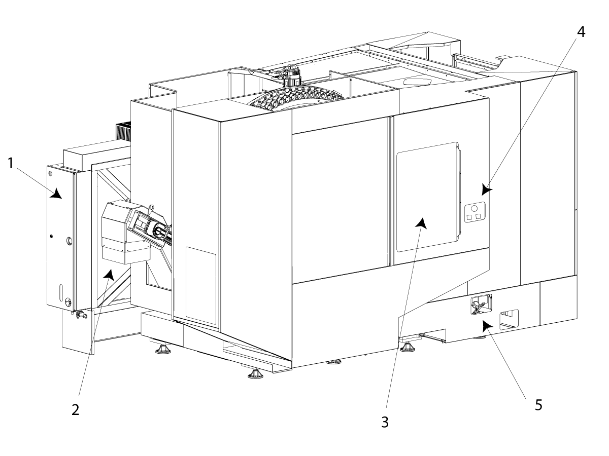

Horizontal Mill Features (EC-400/EC-500, Rear Left view)
  1. Lubrication Panel
  2. Chip Conveyor
  3. Tool Changer Access Door
  4. Tool Changer Emergency Stop
  5. Hydraulic Oil Refill
