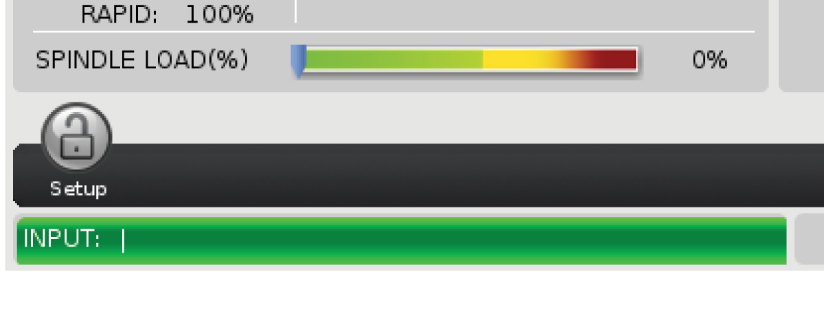

Input Bar
mill_input_bar_display
The input bar is the data entry section located in the bottom-left corner of the screen. This is where your input appears as you type it.

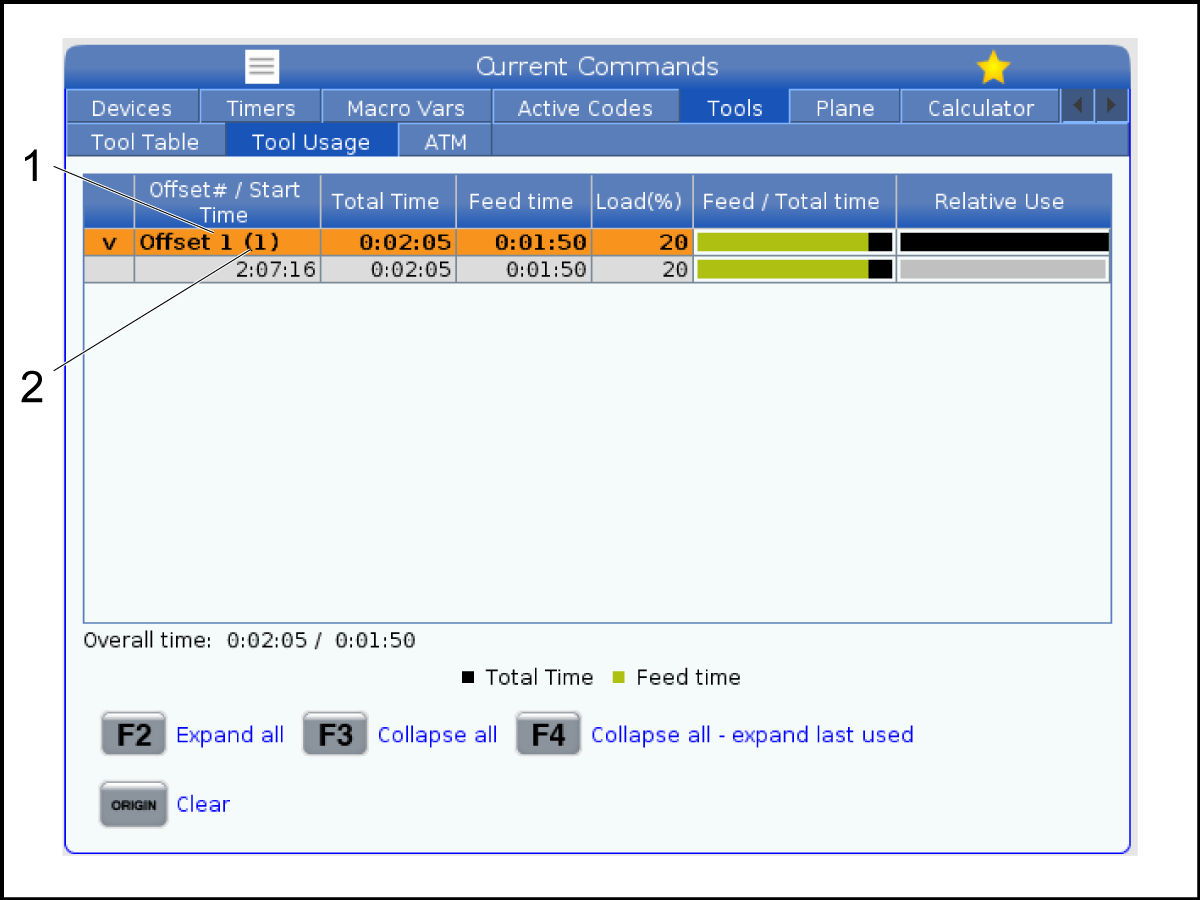

5.4 Current Commands
Current Commands
This section describes the Current Commands pages and the types of data they show. The information from most of these pages also appears in other modes.
Press CURRENT COMMANDS to access the tabbed menu of available Current Commands displays.
Devices -The Mechanisms tab on this page shows hardware devices on the machine that you can command manually. For example, you can manually extend and retract the Parts Catcher or Probe Arm. You can also manually rotate the spindle clockwise or counterclockwise at a desired RPM.
Timers Display -This page shows:
  • The current date and time.
  • The total power on time.
  • Total cycle start time.
  • Total feed time.
  • M30 counters. Each time the a program reaches an M30 command, both of these counters increment by one.
  • Macro variable displays.
You also see these timers and counters in the lower-right section of the display in the OPERATION:MEM, SETUP:ZERO, and EDIT:MDI modes.
Macros Display -This page shows a list of the macro variables and their values. The control updates these variables as programs run. You can modify the variables in this display.
Active Codes -This page lists the active program codes. A smaller version of this display is included on the OPERATION:MEM and EDIT:MDI mode screens. Also when you press PROGRAM in any Operation mode, you see the active program codes.
Advanced Tool Management -This page contains information the control uses to predict tool life. Here is where you create and manage tool groups, and where you enter the maximum tool load percentage expected for each tool.
For more information, refer to the Advanced Tool Management section in the Operation chapter of this manual.
Calculator -This page contains the Standard, Milling/Turning, and Tapping calculators.
Media -This page contains the Media Player.

Tools - Tool Table
Tool Table
This section tells you how to use the tool table to give the control information about your tools.
To access the Tool Pocket Table, press [CURRENT COMMANDS] and choose the Tool Table tab.
Active Tool- Tells you the tool number that is installed in the spindle.
Active Pocket - this show you the next pocket number.
Set pocket as Large [L] - Use this flag when a large tool has a diameter of greater than 3" for 40-taper machines and greater than 4" for 50-taper machines. Scroll to the pocket of interest and press L to set the flag.
CAUTION: You cannot place a large tool in the tool changer if one or both of the surrounding pockets already contain tools. Doing so causes the tool changer to crash. Large tools must have the surrounding pockets empty. However, large tools can share adjoining empty pockets.
Set pocket as heavy [H] - Use this flag when a Heavy, Small Diameter 40-taper tool (4 lb or heavier) or a 50-taper tool (12 lb or heavier) is loaded into the spindle. Scroll to the pocket of interest and press H to set the flag.
Set pocket as XL [X] - Use this flag when two adjacent pockets at each side of the tool are needed. Scroll to the pocket of interest and press X to set the flag.
NOTE: This option only appears if your machine is a 50-taper.
Clear category [Space] - Highlight the desired tool and press SPACE to clear the flag.
Set tool [###] + [Enter]- Highlight the desired pocket and type in the tool number + Enter to set the desired tool number.
NOTE: You cannot assign a tool number to more than one pocket. If you enter a tool number that is already defined in the tool pocket table, you see an Invalid tool error.
Clear tool [0] + [Enter]- Highlight the desired pocket and press 0 + Enter to clear out the tool number.
Reset table [Origin] - Press ORIGIN with the cursor in the center column to use the ORIGIN menu. This menu lets you:
Sequence All Pockets - Makes all of the tool numbers sequential based on their pocket location, starting with 1.

Tools - Tool Usage
Tool Usage
The Tool Usage tab contains information about the tools used in a program. This display will tell you information about each tool used in a program and statistics about each time it was used. It starts to collect information when user Main program start and clear information when meet codes M99, M299, M199.
To get to the Tool Usage display press [CURRENT COMMANDS] then go to Tools and then Tool Usage tab.
Start Time - When the tool was inserted to the spindle.
Total Time - The total time the tool has been in the spindle.
Feed time - Tool usage time.
Offset # [1]
Tool # [2]
 NOTE: Each time the same tool is called, it will make a new row with a new timestamp.
Load% - The maximum load of the Spindle during a tool usage.
NOTE: This value is retrieved every second. The actual load compared to the recorded may vary.
Feed/Total time - A graphic representation of the feed time of the tool over the total time.
Engagement:
  • Black Bar- This bar is the total amount of time the tool was in use.
  • Gray Bar - This bar shows how long the tool was used in this usage related to other usages.
  • Green Bar - This bar shows feed time / total time.
