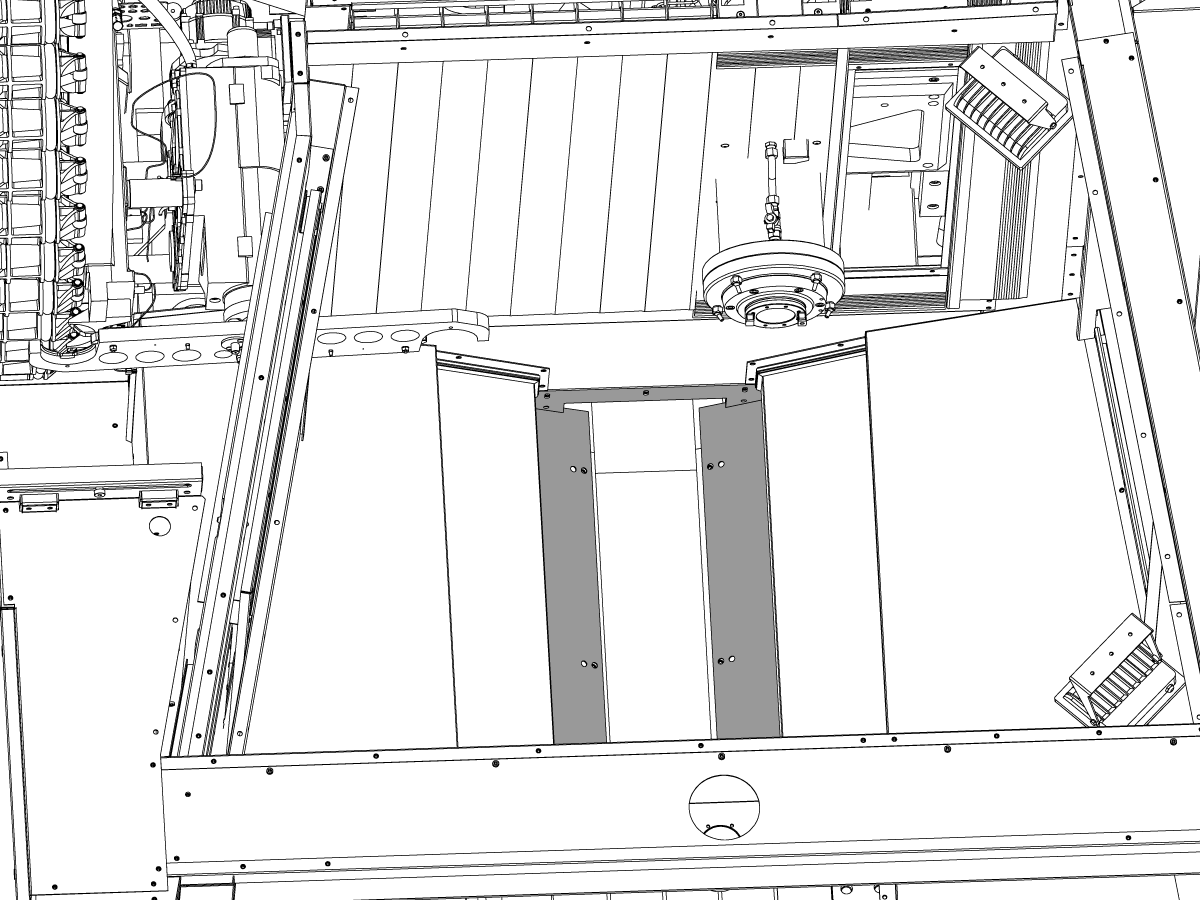

Refer to the following steps to identify which sheet metal to remove.
Remove the following sheet metal in order to remove the conveyor.
The following image depicts the sheet metal that needs to be removed near the spindle side of the conveyor channel.

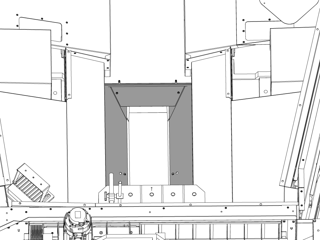

Remove the following sheetmetal in order to remove the conveyor.
The following image depicts the sheet metal that needs to be removed near the APC side of the conveyor channel.

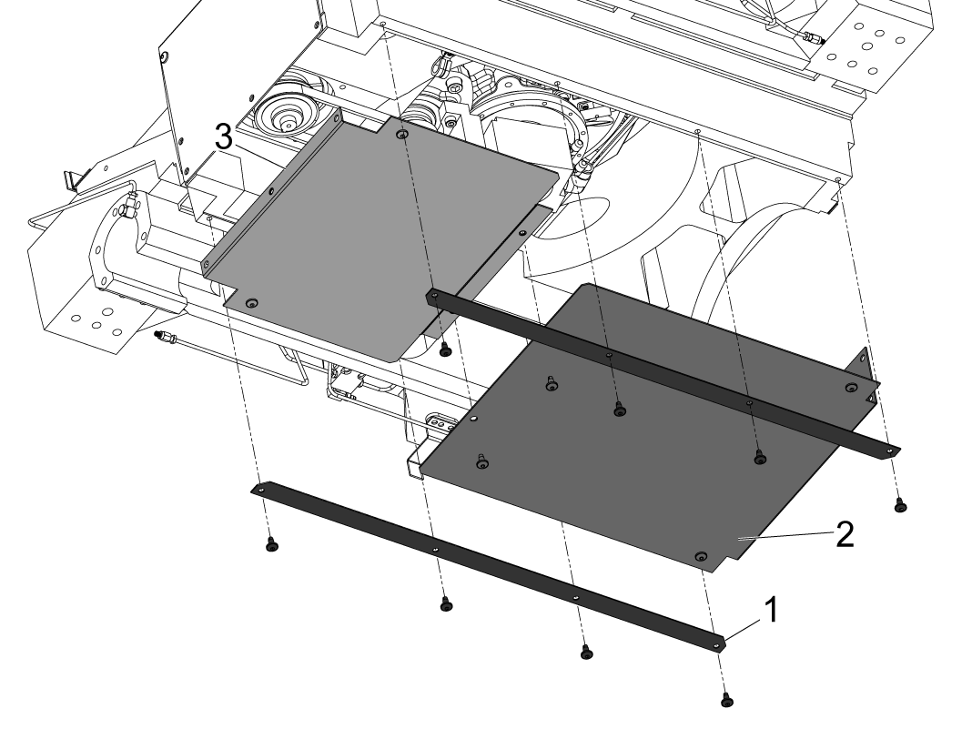

Remove the  sheet metal depicted in order to expose the hydrualic manifold.
Remove the two long strips [1] holding the covers [2] and [3] in place.
Remove the cover denoted as [2] first, then the panel denoted as [3] next.
NOTE: These panels are wedged between the sheet metal on the sides of the saddle in which you removed the bolts in the previous step.

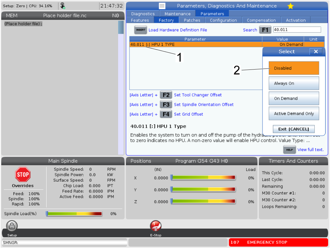

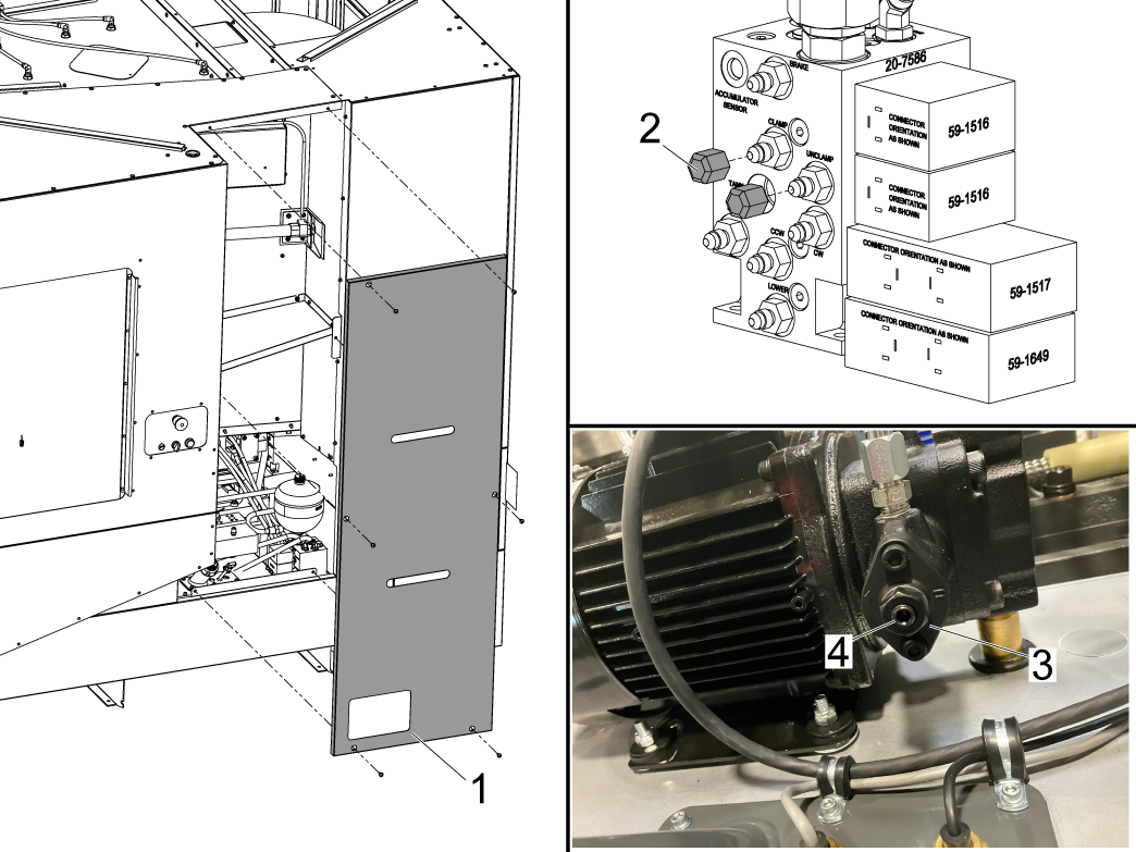

Depressurize the HPU
Zero return the B-Axis before depressurizing the HPU
Set parameter 40.011 HPU 1 TYPE [1] to DISABLED [2].
 NOTE: Parameter 40.011 HPU 1 TYPE will need to be set to DISABLED in order for the depressurize page to work. If it is set to ALWAYS ON or ON DEMAND the HPU will not depressurize.
Depressurize the HPU using the HPU DEPRESSURE page.
Press [DIAGNOSTIC] then navigate to the MAINTENANCE tab [1] then navigate to the HPU DEPRESSURE tab [2]. Press [F3] to depressurize the HPU [3] and the HPU should no longer have pressure in the lines. The text on the screen will display a status that the HPU is safe to use [4]
 NOTE: Parameter 40.011 HPU 1 TYPE will need to be set to DISABLED in order for the depressurize page to work. If it is set to ALWAYS ON the HPU will not depressurize.
Release the brake, press E-stop and place lock-out on the machine.

Remove panel [1] to expose the HPU and its manifold block. It is important to cap the clamp, unclamp, and brake fittings [2] on the HPU manifold side in order to proceed with the installation section of this procedure.
NOTE: Mark the hydraulic lines and fittings on the manifold with zip ties to ease reinstallation later during this procedure.
NOTE: The hydraulic lines will leak fluid when disconnecting them from the manifold, place a plastic bag or rags to maintain a clean machine.
Using 1/2-13 eye bolts safely lift and remove the platter.
This platter weights approximately 200 lbs use the proper lifting apparatus when removing.
Release the brake and make sure the the HPU is depressurized before removing the line. Plug the brake like to prevent leakage.
 WARNING: IF YOU DO NOT DISENGAGE THE BRAKE AND DISCONNECT THE LINES YOU CAN PERMANENTLY DAMAGE THE BRAKE BY REMOVING THE PLATTER.

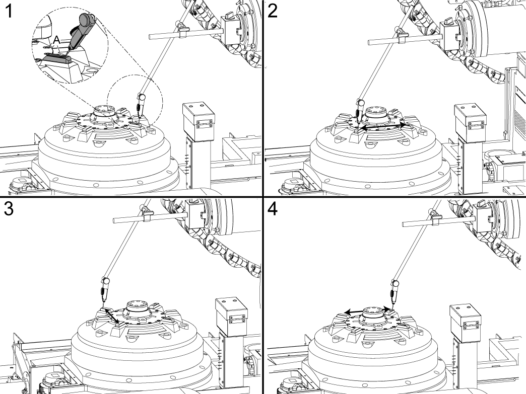

IMPORTANT: It is recommended to indicate and adjust the receiver axial and radial runout before installing the piston and other internal components, otherwise with all the internal components this will be much harder to do.
6
RECEIVER FACE RUNOUT:
With an indicator and mag base setup, locate the front right key and set the dial to zero. The front right key will have an arrow engraved on it [A].
Indicate the top face of the keys and measure face runout on the receiver rotate the receiver every 90 degrees this is NTE 0.0005 in (0.0127 mm) TIR.
Once the runout has been adjusted torque the mounting bolts in star pattern referencing the HAAS TORQUE SPECIFICATION document.

RECEIVER RADIAL RUNOUT:
With an indicator and mag base setup, locate the front right key and set the dial to zero. The front right key will have an arrow engraved on it.
Indicate the side face of the keys and measure radial runout on the receiver, this is NTE 0.0005 in (0.0127 mm) TIR.

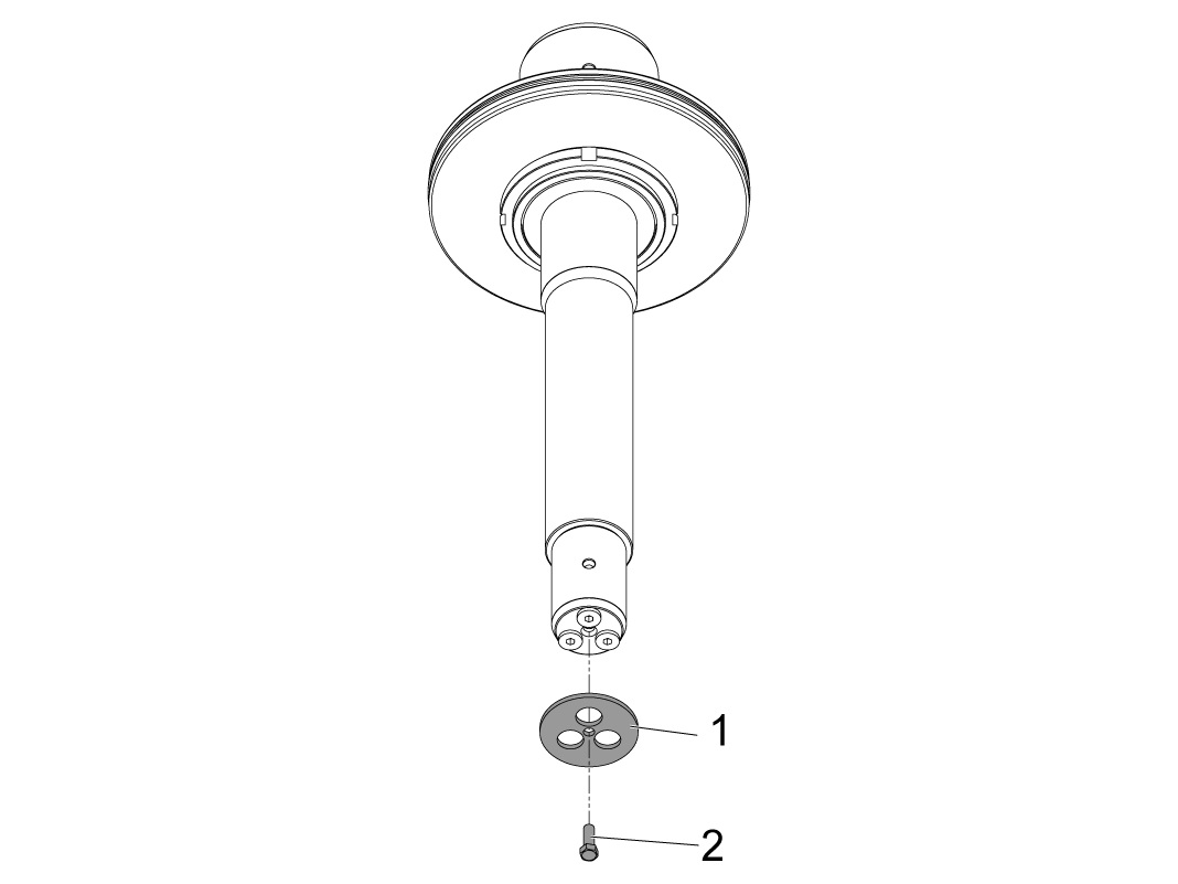

Remove the 1/4-20 bolt and retaining cap from the bottom shaft.

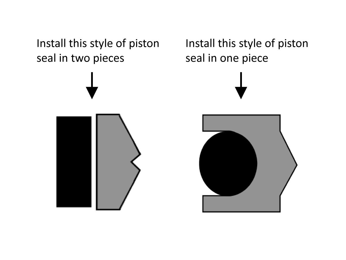

Kits built after 7/2022 may have two possible piston seal styles.
The seal combination on the left is what the kits were originally built with, the seal combination on the right is what the kits are currently being built with.
If the kit comes with the left seal combination apply a thin layer of grease to the energizer and install first. Apply a thin layer of grease to the outer seal and install.
If the kit comes with the right seal combination apply a thin layer of grease to the energizer and apply a thin layer of grease to the outer seal and install it in one piece.

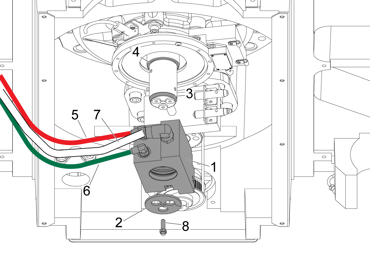

Install the hydraulic manifold [1] on the under the gearbox and reconnect the lines.
Grease the dowel pins using tacky grease.
NOTE: It is recommended to use the retaining cap [2] to raise the manifold into position. Use a longer screw(s) or an appropriately sized 1/4-20 threaded rod with a 1/4-20 nut in place of the mounting bolt [8] to fully seat the hydraulic manifold
Using the longer screws or threaded rod with the retaining cap pull the manifold in place until all 4 internal seals have past over the first chamfer [3] and bottom out at the upper lip [4].
Once the manifold is fully installed remove the longer bolt/threaded rod and install the original 1/4-20 mounting hardware.
NOTE: The line denoted in RED [5] is unclamp, and the line denoted in GREEN [6] is clamp. The air line goes in the clear port [7]. Use the zip ties previously added to aid reinstallation.
Reinstall the sensor block in the correct orientation. The sensors may need to be readjusted if clamp/unclamp alarms appear.
IMPORTANT: Verify all hydraulic hoses keep clear from rotary encoder during clamp/unclamp positions.

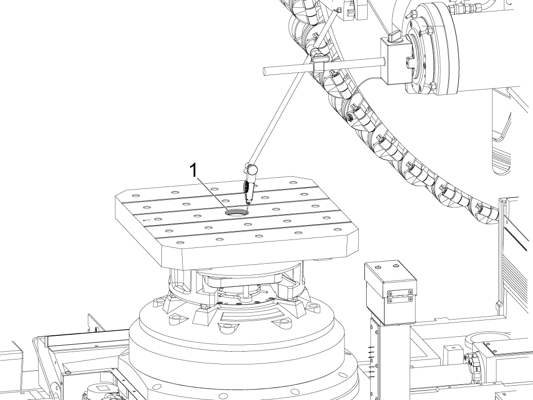

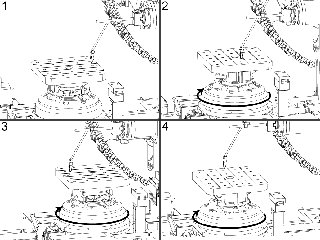

ROTARY FLATNESS:
Do not rotate the rotary during this check. Indicate the top surface on the four outside bosses, this is NTE 0.0003 in (0.00762 mm). Shim the rotary base if necessary.
Shims to correct the receiver flatness will be placed underneath the trucks.
NOTE: Shimming under the trucks should not be necessary. Please verify that the receiver is properly installed (all mounting bolts are torqued, receiver cap is properly installed, etc.) before attempting to shim under the trucks.
There will be thick shims (0.2170 in or 5.5118 mm) already placed from the factory. Please record the value of shims placed under the trucks after installing the new receiver and submit this to Haas Service for records.

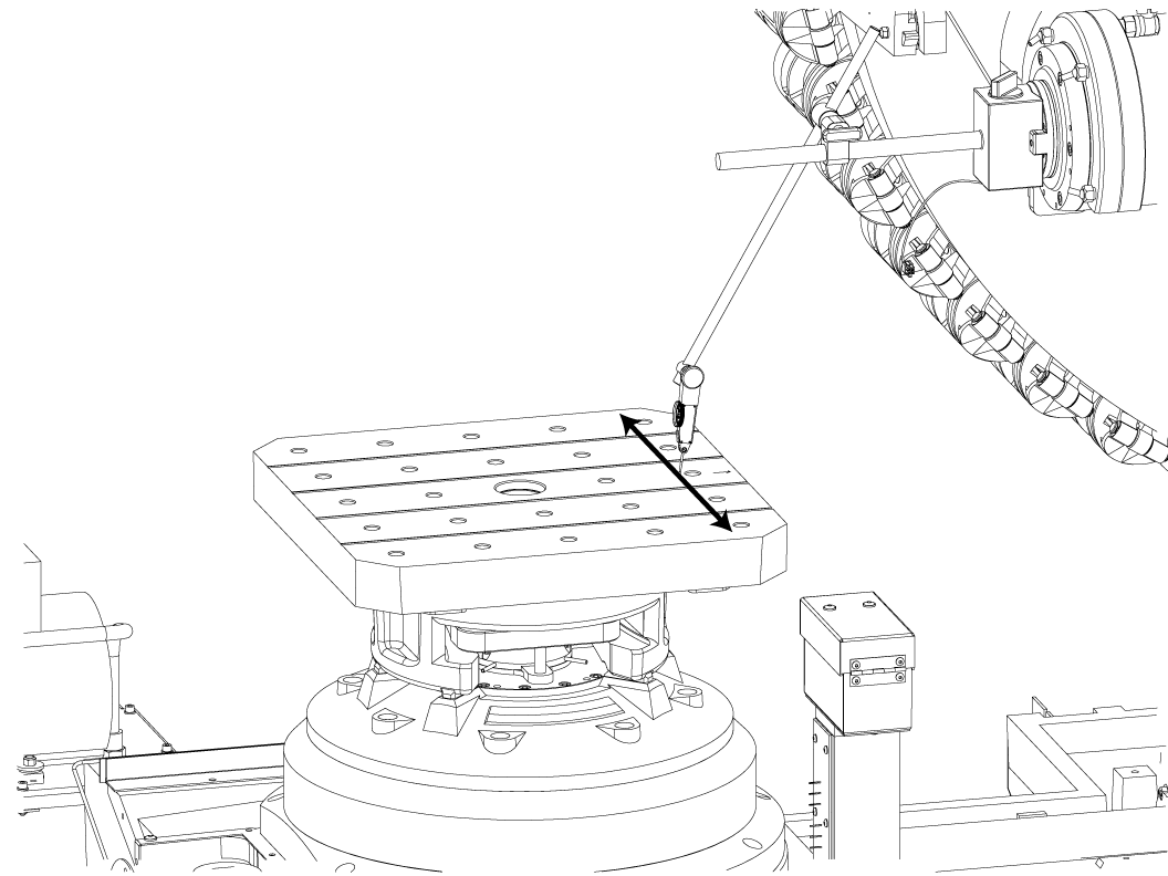

RECEIVER X-AXIS PARALLELISM:
Locate the front edge of the key on the right, set the dial to zero.
Press [POSITION] and navigate to the operators tab, and set the Y value to zero.
Jog X to record value on the key directly across from it, to avoid the key in between jog the Y axis up and over that key and back to the Y-Axis zero location set on the operators tab.
This is NTE 0.0003 in (0.00762 mm). Adjust the B axis until the indicator reading is within specification.
Press [DIAGNOSTIC] and navigate to the Parameters Tab find parameter 6.078 [213:] B-AXIS TOOL CHANGE OFFSET and while on the parameter page in service mode, press B + F2 to set the TC Offset.

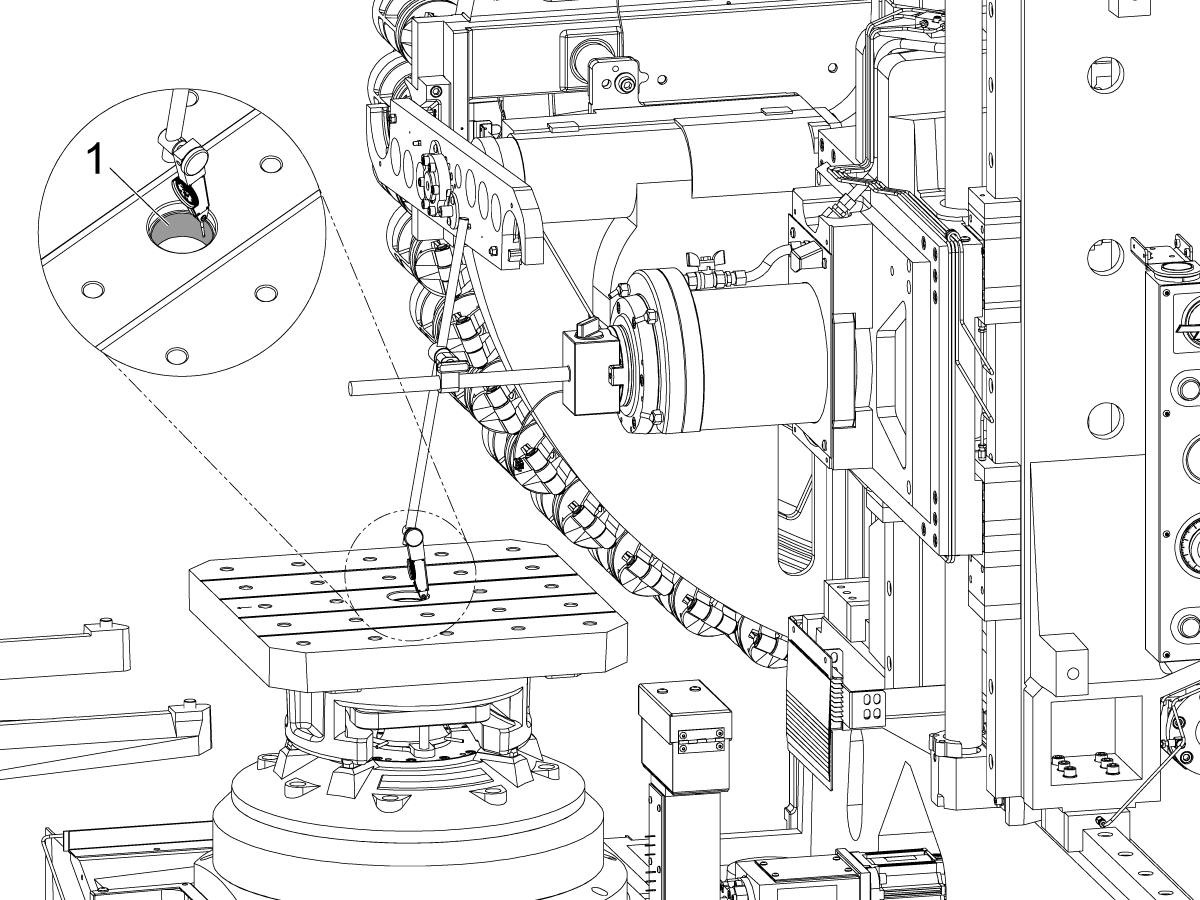

AXIS OF ROTATION:
Rotate the rotary every 90 degrees and move your X and Z axis so that the indicator is marking the same point and record this value.
In this example the indicator is following the front right key with the arrow engraved. This value is NTE 0.0005 in (0.0127 mm)
Install the pallet clamp plate [1], if the dowel pins [2] do not line up with the holes [3] the clamp shaft will need to rotate into position.
To rotate the shaft into position use the mounting bolts without the clamp plate installed, a screw driver can be wedged between and used to turn the shaft into the correct position.
NOTE: Apply tacky grease to the dowel pins [2].
Repressurize the HPU
Set parameter 40.011 HPU 1 TYPE [1] from DISABLED [2] to its original state.

PALLET CENTER BORE:
Place the tip of the indicator in the center of the bore on the pallet, jog in the Z-direction to the bottom half of the bore and jog to one side of the bore and set the dial to zero [1].
Rotate the pallet 360 degrees and record the value, this is NTE 0.003 in (0.0762 mm) TIR.
PALLET FLATNESS IN X DIRECTION:
Pick up a zero point on the top front right edge of the pallet, sweep the pallet in the X  direction and record the value. This value is NTE 0.0005 in/10 in (0.0127 mm/ 254 mm)
PALLET FLATNESS IN Z DIRECTION:
Pick up a zero point on the top front right edge of the pallet, sweep the pallet in the Z direction and record the value. This value is NTE 0.0005 in/10 in (0.0127 mm/ 254 mm)

With an indicator and mag base setup, place the indicator center of the side closest to the spindle and set the dial to zero. The pallet will have an arrow pointing towards the spindle, for reference place the indicator in front of the hole where the arrow is [A].
In this example the indicator is following the front right key with the arrow engraved. This value is NTE 0.001 in (0.0254 mm)
