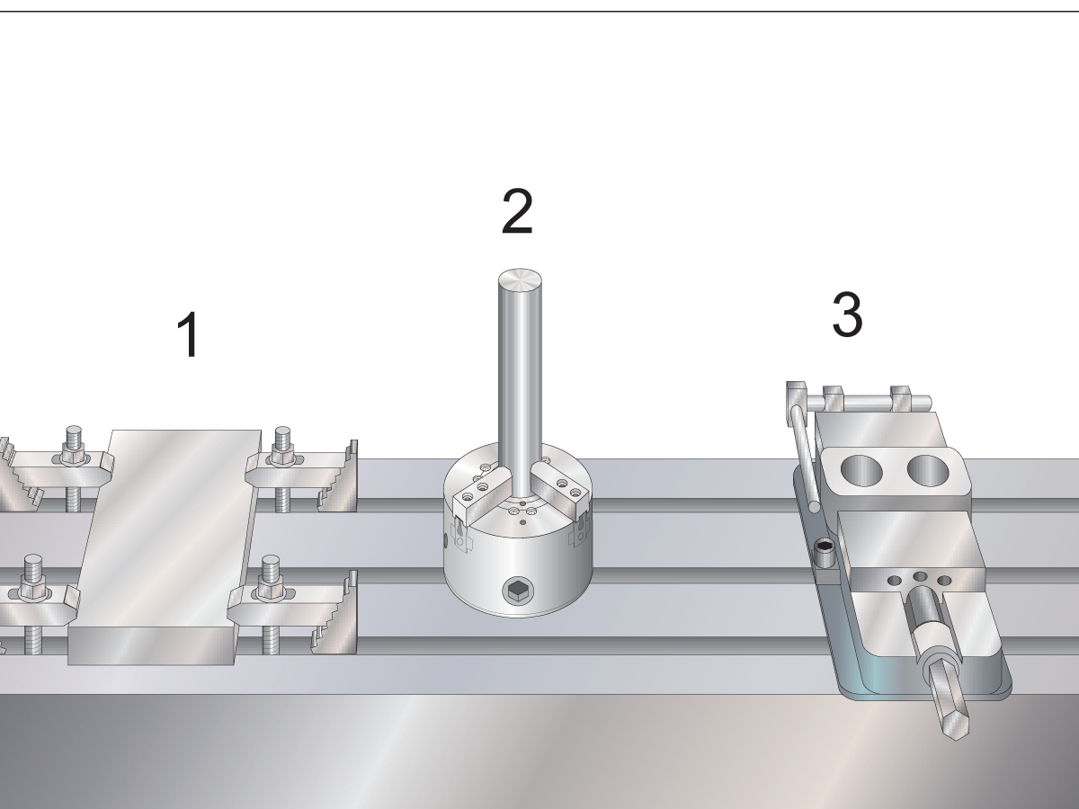

Devices - Workholding
Starting in software version 100.20.000.1110 a workholding tab was added to the control to support multiple workholding devices. The control will support Haas E-Vise [1], Hydraulic [2] and Pneumatic [3] vises.
The machine supports up to 3 foot pedals each would toggle Vise1, Vise2, and Vise3 respectively. If you have a single pedal you will need to enable Vise1 to the vise you want be actuated by the foot pedal.
NOTE: The E-vise is used on the Mill APL and Robot systems but can also be used as a stand-alone product.
You can actuate up to 8 workholding devices.
To access the Workholding page press Current Commands and navigate to Devices > Workholding.
From the Workholding display tab you will be able to:
  • Setup the workholding devices
  • Enable and Disable workholding devices
  • Clamp and Unclamp
  • Jog Advance / Retract (E-Vises only)

Part Setup
mill_part_setup_overview
Part Setup Examples: [1] Toe clamp, [2] Chuck, [3] Vise.
Correct workholding is very important for safety, and to get the machining results that you want. There are many workholding options for different applications. Contact your HFO or workholding dealer for guidance.

Tools For Immediate, On-Table Fixturing - You can semi-automate many setup procedures to assist the machinist. You can reserve tools for immediate situations that you did not anticipate in your application design. For instance, suppose a company uses a standard clamp with a standard bolt hole pattern. If you discovered, after setup, that a fixture needs an additional clamp, and suppose that you programmed macro subprogram 2000 to drill the bolt pattern of the clamp, then you only need this two-step procedure to add the clamp to the fixture:
a) Jog the machine to the X, Y, and Z coordinates and angle where you want to place the clamp. Read the position coordinates from the machine display.
b) Execute this command in MDI mode:
G65 P2000 Xnnn Ynnn Znnn Annn ;
where nnn are the coordinates determined in Step a). Here, macro 2000 (P2000) does the work since it was designed to drill the clamp bolt hole pattern at the specified angle of A. Essentially, this is a custom canned cycle.
