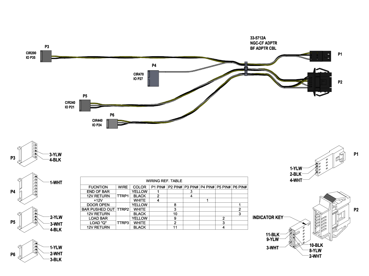

6.1 HAAS BAR FEEDER - Troubleshooting
Overview
Haas Bar Feeder
  1. Home switch
  2. EOB (End of Bar) switch
  3. Load "Q" switch
  4. Load bar switch
  5. In-position switch
  6. Door switch
  7. Trolley, belt, and belt tensioner assembly
  8. Servo motor (trolley)
  9. DC motor (bar loader)
  10. Charging tray
  11. Transfer tray
Symptom Table

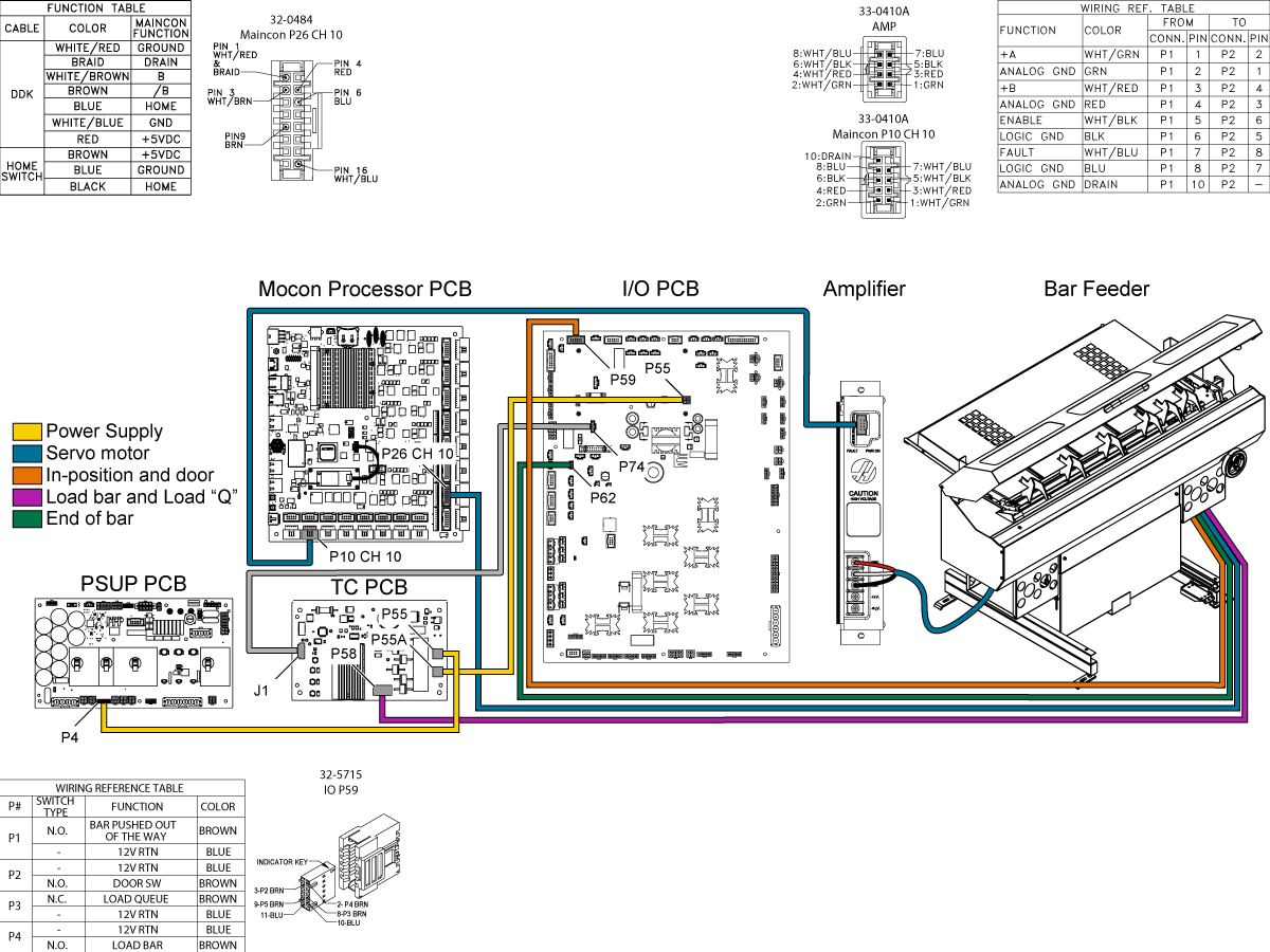

Servo Motor
Corrective Action:
Make sure the motor connections are properly seated and the cables are not damaged.
Go to Servo Amplifier - Troubleshooting Guide and Sigma 5 - Axis Servo Motor and Cables - Troubleshooting Guide. Check for shorts to the motor.
DC Motor and Clutch Inspection
DC Motor Inspection:
Run the DC motor: use G105 Q9 (Load Bar Stock) or G105 Q8 (Unload Bar Stock). Measure for DC voltage at the connector on the motor:
Adjust the multimeter range to 0.0 and set it for Min/Max. The power to the motor will only be on for one second before an alarm is generated and the power is shut off. The reading must be a minimum of 160 VDC, or show a signal change, when it is commanded to run. Some multimeters are not fast enough to read the voltage before the alarm occurs. It should still show a signal change or OL before the alarm is generated.
If there is no voltage and the signal does not change, go to I/O PCB - Troubleshooting Guide (Classic Haas Control).

Proximity Sensors
Corrective Action:
Test the sensor for correct operation: hold a steel object in front of the sensor. If the sensor lights up, the sensor is not faulty. If the sensor does not light up, continue to further troubleshoot the proximity sensor.
Find the correct sensor to troubleshoot:
  1. Load bar (Alarm 452) (Alarm 9986)
  2. Home switch (Alarm 469)
  3. EOB switch (Alarm 423)
  4. Load "Q" (Alarm 1015 CHC)
  5. In-position (Alarm 9984) - Before you attempt to troubleshoot the In-position switch, unlatch and re-latch the bar feeder using the foot pedals.
  6. Door switch (No alarm) - When the door switch detects the door is open, the bar feeder will operate at 25% normal speed. If this switch does not operate correctly, it will operate at 25% normal speed while the door is closed.
Disconnect the cable [1] from the sensor. Use the marker [2] on the cable connector to measure the correct pins. Measure the voltage between the pins [3] and [4] on the cable connector. Make sure to use a multimeter with needle tipped probes.
The correct voltage is 12 VDC.
If voltage is correct, the sensor is at fault. Go to Proximity Sensor - Troubleshooting Guide to further troubleshoot the proximity sensor.
If there is no voltage, go to I/O PCB - Troubleshooting Guide (Classic Haas Control).
Electrical Cables
Corrective Action:
Perform a visual inspection of the motor cable and connectors. Make sure that the cable is in good condition and that the connectors are clean and secure.

NGC - CF Adapter Cable Diagram
CHC Bar Feeder Electrical Diagram
NGC Bar Feeder Electrical Diagram
