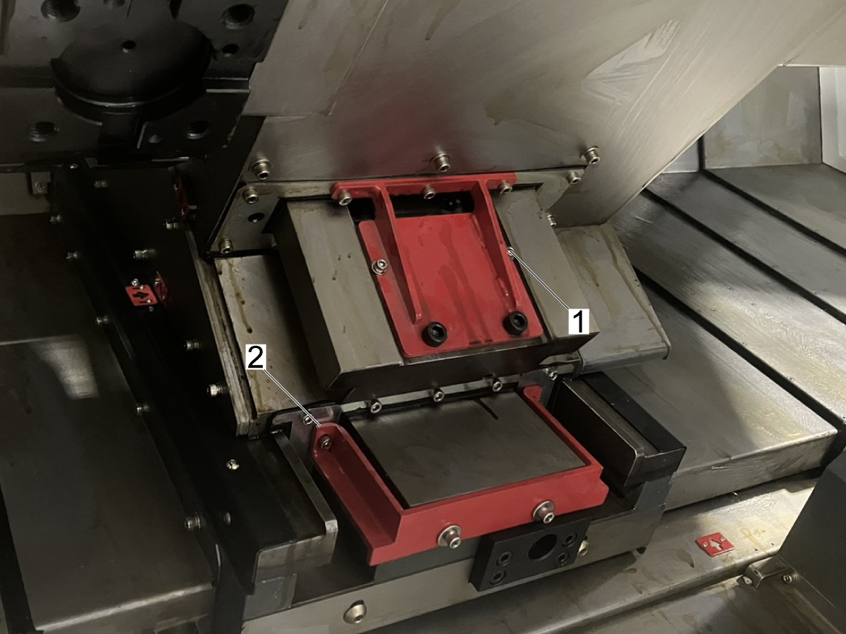

Shipping Brackets Removal (SB-28Y)

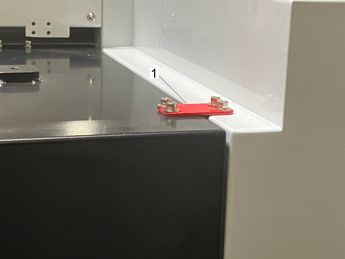

Remove the door shipping bracket [1].
Remove the x and y axis turret shipping brackets [1][2].
Remove the Z-axis shipping bracket [1].

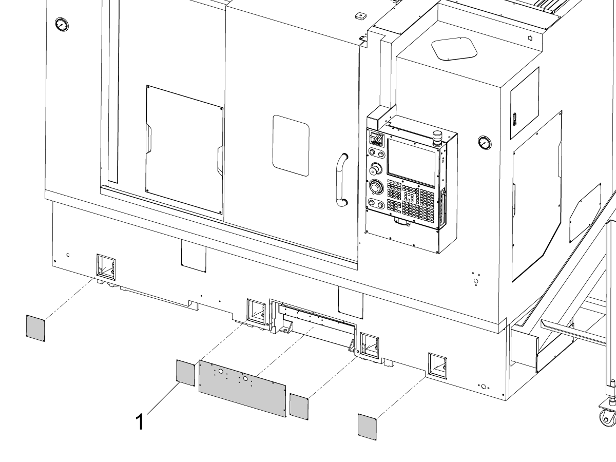

Remove the front access panels [1] to gain access to the leveling feet and coolant tank.

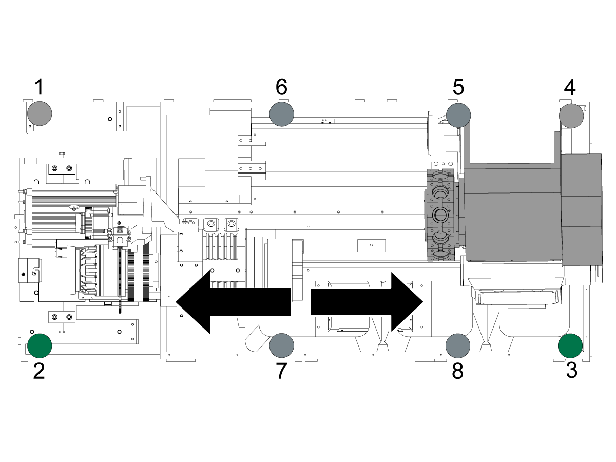

Rough level the machine on all 4 corners to 1 inch (25.4mm) off the ground.
Warning : Ensure that the coolant tank is removed from undernead the machine before leveling.
Feet [1] through [4] will be used to level the machine. Ensure that feet [5] through [8] are completely off the ground.
Remove all the pressure from foot number [4] and use feet [1] through [3] for the leveling.
Place a magnetic base onto the front cover of the turret [1] then place a machinist bubble level [2] onto it.
Jog the turret as close as possible to the bulkhead and ensure that the x and y axis are in the middle of their travel distance.
Gently tap the magnetic base to adjust the larger level until the bubble is centered.
To check for twist in the machine move the turret along the Z-axis back to home position.
Using the larger level raise or lower screw 3 to center the bubble and wait 10 seconds for the bubble to settle. .
Move the turret back towards the spindle as far as possible and raise or lower screw 2 to center the bubble. Continue moving the turret from the home position to the spindle and adjusting screw 2 and 3 until the twist is removed.
Lower screw 4 onto the pad by hand and use a wrench and tighten only by 10°.
Do not tighten any further as you will change the level of the machine.
Tighten the locking nuts making sure that you do not raise or lower the screws.
Verify that the machine is level by moving the turret along the Z-axis and checking for twist and continue adjusting until level.

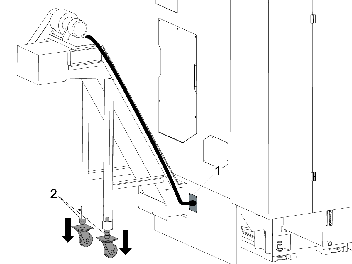

Connect the conveyor to the machine [1] and lower the feet [2] until they touch the ground for support.
Connect the coolant pumps to the machine [2] along with the coolant float sensor [1].
