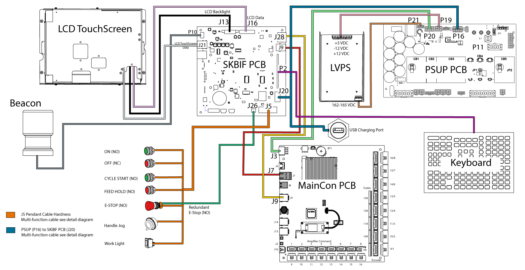

SKBIF Troubleshooting
  1. Remove the LCD back cover.
  2. Check J13 backlight and J16 LCD data connectors. Make sure the connectors are seated, and wires are not broken.
  3. Check the wires going to the [POWER ON], [POWER OFF], [EMERGENCY STOP], [FEED HOLD] and [CYCLE START]
    contactors. Make sure the connections are tight.
  4. Look at the status LED lights.  Refer to the LED table below.
  5. Set the volt meter to DC. Check for +12Vdc supply voltage at J20 you should measure approximately +12Vdc. If this voltage is lower than +11Vdc or not present make sure J20 connector is properly seated, and trace the voltage back to the LVPS. Refer to the above electrical diagram.
  6. The SKBIF PCB generates +3.3Vdc, +5Vdc. Check these voltages at the following test points.
    • Put the black probe on the screw (ground) [4] and the red probe at TP14 (+3.3Vdc) [1] you should measure approximately +3.3Vdc.
    • Put the black probe on the screw (ground) [4] and the red probe at TP13 (+5Vdc) [2] you should measure approximately +5Vdc.
    • Put the black probe  on the screw (ground) [4] and the red probe at TP12 (+12Vdc) [3] you should measure approximately +12Vdc.
    If these voltages are low or no voltage is measured, disconnect all the connectors from the SKBIF PCB except the J20 connector, and measure again. If after doing this there is still no voltage then the SKBIF PCB is defective.
    If after disconnecting the components, the voltages are correct, then there is a short circuit in one of the components connected to the SKBIF for example, remote jog handle, handle Jog, etc. Determine which component is at fault.
     If everything checks out ok, then the SKBIF PCB is defective.
    NOTE: Do not replace the speaker,  the speaker does not produce the beeper sound.

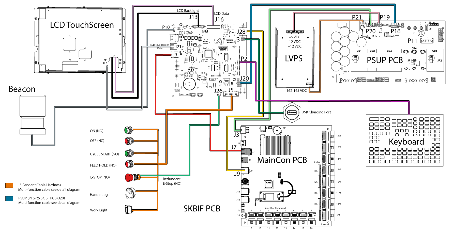

Electrical Diagrams
SKBIF / 15" LCD Interconnect Diagram
SKBIF Diagram P/N 34-4243G
SKBIF Diagram P/N 34-4510/B
Note: Machines with SKBIF 34-4510B and a USB Charging Port  will have the USB Charging Port connected to J20 on the SKBIF. The Charging Port is only for charging purposes and not for getting data from USB devices.
SKBIF Diagram P/N 34-4510C
Note: Machines with SKBIF 34-4510C will have the USB Charging Port connected to J3. The Charging Port is only for charging purposes and not for getting data from USB devices.
