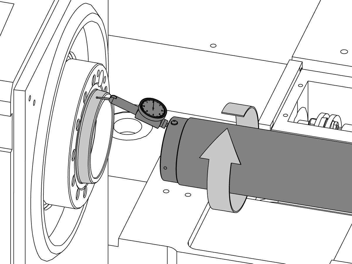

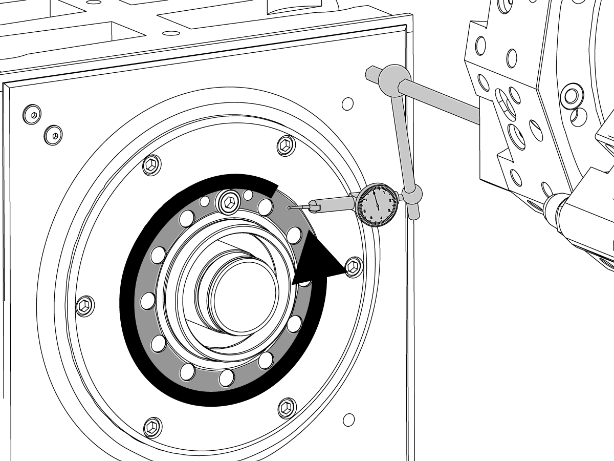

Spindle Centerline to Z-Axis Parallelsim Part 1:
Spindle Face Axial Runout:
  • Attach an indicator as shown to the face of the turret
  • Rotate the spindle 360 degrees and watch indicator movemment
Total Axial Runout on Spindle Shaft Face:
_________________________________________
The maximum permitted error is 0.0002" (0.005 mm)
Spindle to Z-Axis Parallelism Part 2:
  • Measure the radial runout at the base and end of the alignment bar
  • The maximum radial error that is permitted is 0.0002 (0.005 mm)" at each end

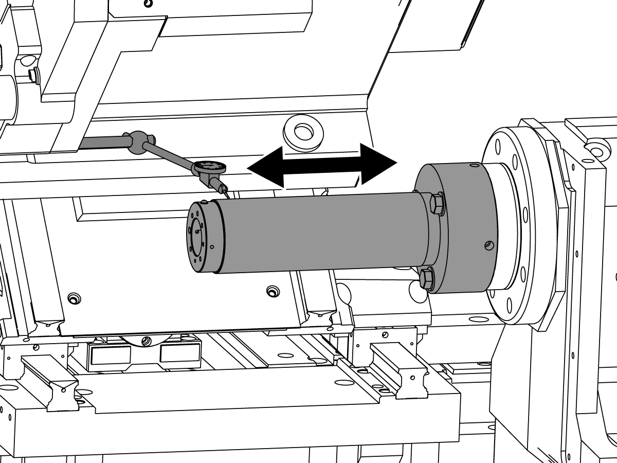

  • Measure the parallelism along the top of the bar as you jog the Z-Axis
  • The maximum permitted error is 0.0004"/10" (0.010 mm / 254 mm)
Top of bar parallelism:
  • Measure the parallelism along the side of the bar while jogging the z-axis
Side of bar parallelism:
Spindle Alingment Bar Service Tool Part Numbers:
  • T-2113 for ST-10
  • T-1312 for ST-20/30, DS-30
  • T-1652 for ST-30 Big Bore, ST-40 and ST-40 Big Bore
  • ST-40 Big Bore also must have Adapter T-2160 and Spacer T-2161
  • T-2165 and T-2166 are necessary for ST-40/45/50/55 that have the optional Steady Rest (T-1652 is too short).

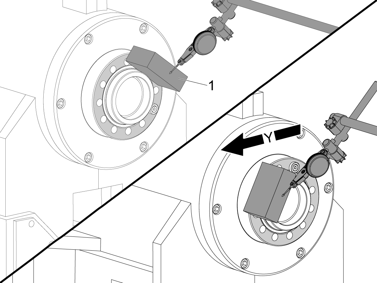

Y-Axis Square to Z-Axis
RECORD PARAMETER 700 VALUE:
  • Set the parameter 700 to zero.
  • Measure the parallelism of the spindle face to the Y-Axis using the gauge block
  • Record the measured error
ERROR:
The maximum permitted error is 0.0002"/5" (0.005 mm / 127 mm)
  • Set Parameter 700 back to the recorded value.
X-Axis to Z-Axis Squareness
  • Measure the parallelism of the spindle face to the X-Axis using the gauge block
  • Record the measured error.
ERROR:

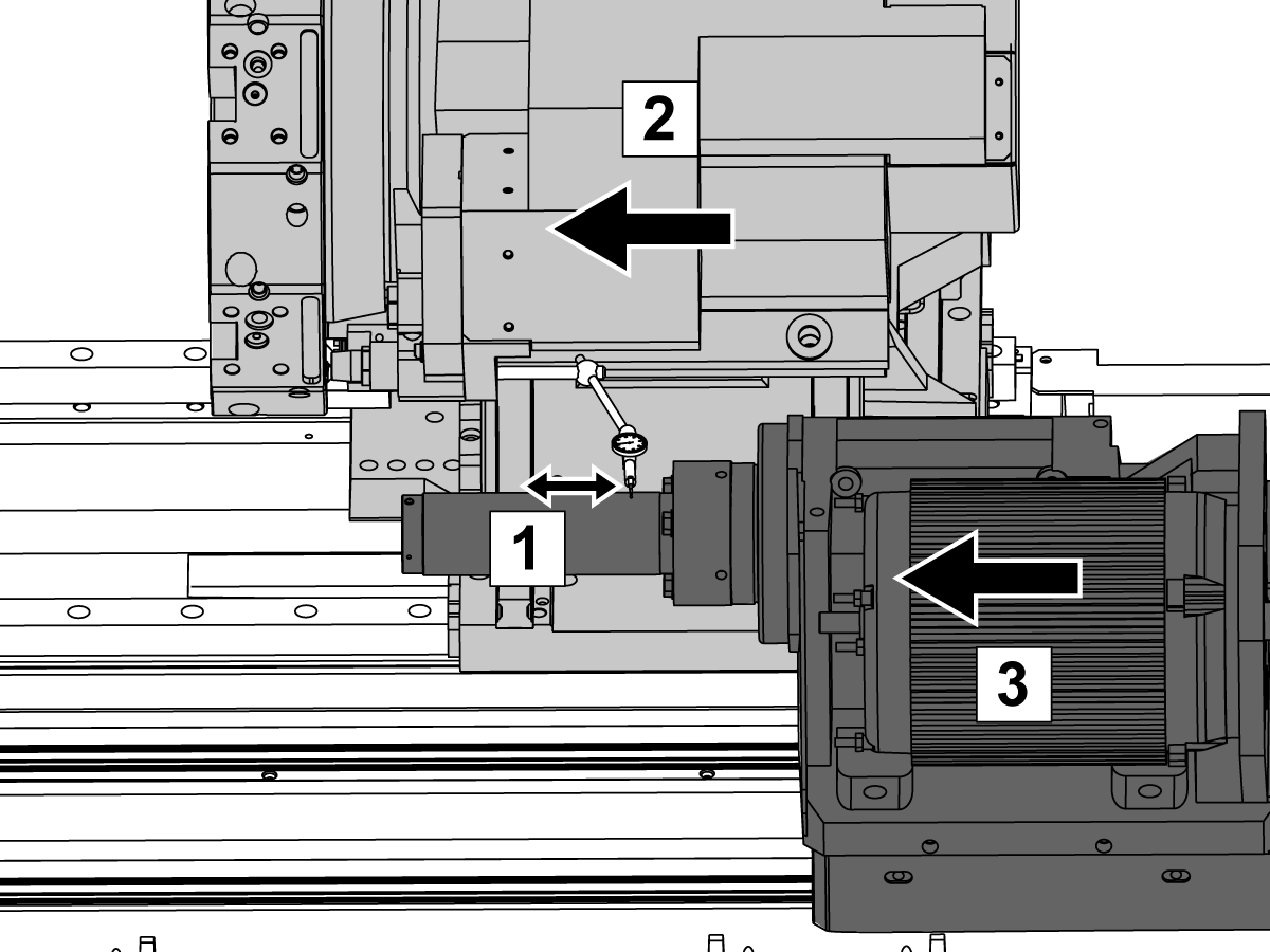

Z-Axis to B-Axis Parallelism
  • Measure parallelism across the side of the tool [1]
  • Jog the Z-Axis 4 inches [2]
  • Jog the B-Axis 4 inches [3]
  • Do this again for the full length of the B Axis travel.
SIDE PARALLELISM ERROR:
The maximum permitted error is 0.001" (0.025 mm)/Full Travel
  • Measure across the top of the taper tool
TOP PARALLELISM ERROR:
