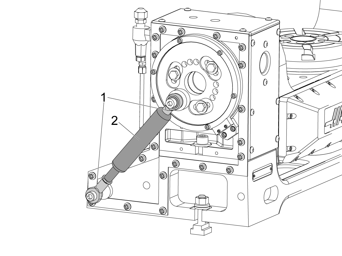

This procedure tells you how to replace the gas-spring counterbalance on a TR and TRT. The gas-spring counterbalance has a gas-spring [2] and (2x) rod ends [1].
NOTE: Haas recommends replacing the Counterbalance gas springs every 4 years and checking the gas spring for oil leaks every 2 years (Replace if an excessive amount of oil is noted between body seal and shaft.  In normal operation the shaft will see a light coat of oil).

Remove the cover from the side of the rotary that does not have a motor. Make sure the gas-spring [2] is fully extended. Remove the gas-spring.
Remove both of the rod ends [1] from the removed gas-spring. Install the rod ends on the new gas-spring [2].
Install the gas-spring.

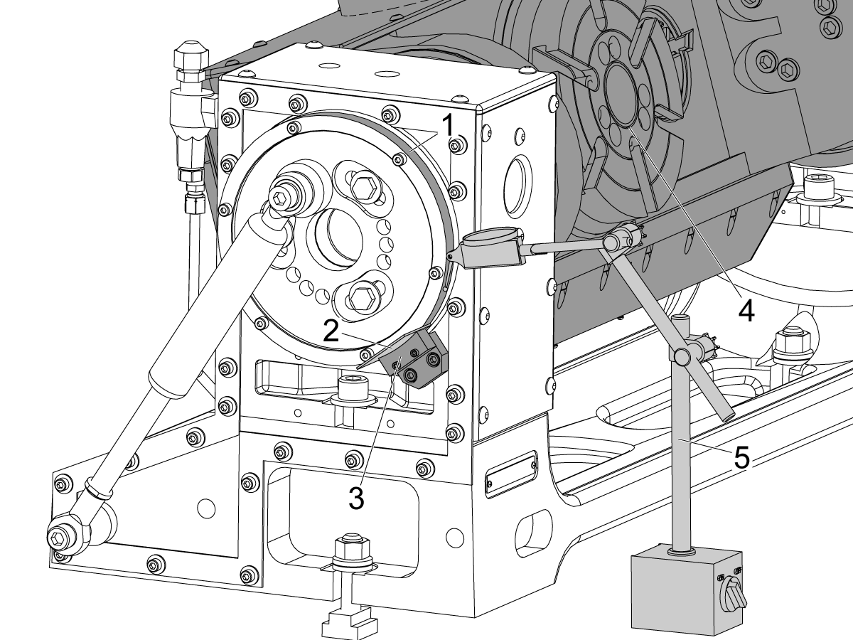

For TR160: Loosen the plate bolts. Adjust the plate and use one of the outer mounting holes for the top counterbalance mount to set the correct length. If you rotate the plate you will need to indicate the scale [1] and remove the scale reader [2]. Go to Step 4.
For TR210: Loosen the plate bolts. Adjust the plate and use one of the outer mounting holes [3] for the top counterbalance mount to set the correct length.

Install an indicator on the table near the rotary scale ring [1]. Make sure the tip of the indicator [5] touches the side of the scale ring. Loosen the scale reader [3]. Put a 0.006" (0.1524 mm) shim [2] between the scale ring and the read head.
Release [EMERGENCY STOP]. Clear alarms
If the error is more than 0.0005" (0.0127mm) make adjustments to center the scale ring. Tap on the inner diameter of the bore hole with a mallet. Do not tap on the scale.
Jog A Axis in the negative direction from +180 degrees to -180 degrees. Jog the A Axis in the positive direction back to +180 degrees. This avoids damage to the cables in the rotary [4]. Repeat this until the error is not more than 0.0005" (0.0127mm).
Do this step only if you adjust the plate on a TR160.
Tighten the read head [4]. Remove the shim [3] and make sure there is a 0.006" (0.1524 nm) gap between the read head and the scale ring.
Press [EMERGENCY STOP].
Torque the plate bolts [2] to 45 ft-lbs (61 nm).
Use the indicator [5] to make sure the scale ring is still aligned. If it is not aligned loosen the plate bolts and repeat this step. If it is remove the indicator and torque the gas-spring Socket Head Cap Screws [1] (SHCS) to 50 ft-lbs (30 nm).
