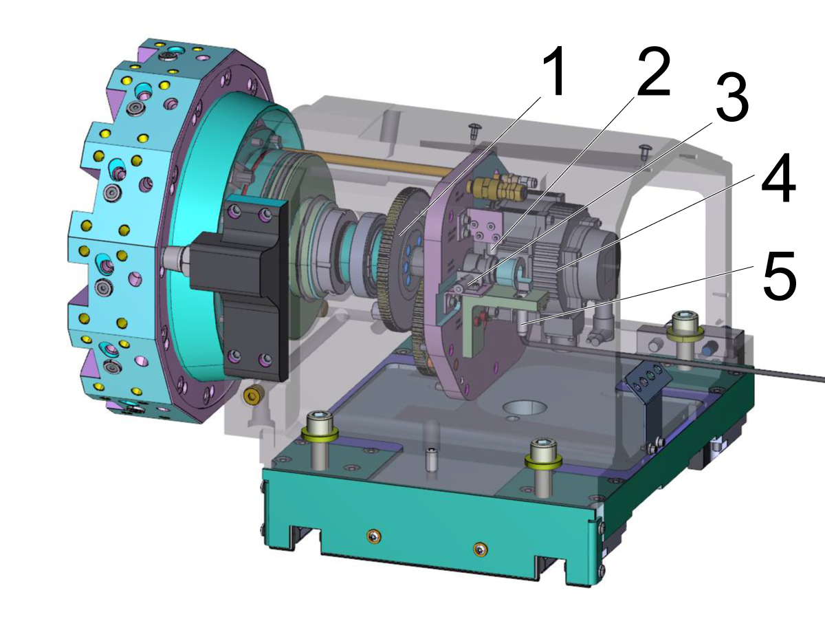

Jump to Section 1. Introduction 2. Symptom Table 3. Incoming Air Supply 4. Clamp / Unclamp Proximity Sensors 5. Servo Motor 6. Turret Pop Out 7. Clamp / Unclamp Solenoid Voltage 8. Internal Gears 9. Quick Exhaust Back to Top
  1. Internal Gears
  2. Unclamp Switch
  3. Clamp Switch
  4. Servo Motor
  5. Home Switch

The internal gears are damaged. This can also cause unusual noise when the turret rotates. Check the internal gears for damage.
The servo motor has an electrical fault. Check the servo motor connector and cables for shorts or contamination. Check the amplifier for shorts.
Alarm 103 Axis Servo Error Too Large The internal gears are damaged. This can also cause unusual noise when the turret rotates. Check the internal gears for damage.
