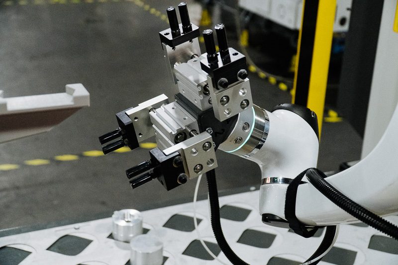

✓ Dual Pneumatic Grippers

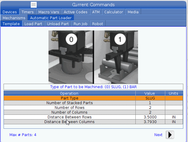

The cobot is set up directly through the Haas control using the Haas Robot Interface, which guides the operator through the steps necessary to quickly program the cobot’s motions using the Haas Touch Remote Jog Handle. Answering simple questions, the operator enters basic information by either positioning the part grippers and pushing a single button to record the position, or by entering basic numerical values. The motions are recorded and values are calculated automatically by the control, and the cobot is ready for automatic parts loading.
A basic part management table can be created by setting up a grid pattern template of equally spaced rows and columns. The cobot grippers can be configured for various part shapes – such as round, hex, and square bars – and adjusted or modified to best fit your parts.
The cobot operates in the background during normal machining operations, returning parts to the storage table and retrieving new raw pieces, while parts are being machined. The result is near-continuous unattended machining.
Our easy-to-use Haas Robot Interface uses simple, step-by-step instructions to help the operator “teach” a 6-axis cobot the correct positions for picking up, loading, and unloading parts.
  • The cobot’s motion is operated directly from the Haas Touch Remote Jog Handle,  allowing for seamless integration
  • Step-by-step instructions and graphics help guide the operator through the setup process, for example:
    • Set the part template pattern – number of rows and columns
    • Set the first part pick-up position
    • Teach the linear path the robot arm will follow to the ready position
    • Set the ready position – where the cobot will wait until machining is complete
    • Set the load and unload positions at the workholding
    • Set the drop-off position for the first completed part

Axes S.A.E METRIC
Controlled Axes 6 6
Capacities S.A.E METRIC
Max Load Capacity at Wrist 22.0 lb 10 kg
Reach 39.0 in 1000 mm
Repeatability 0.0012 in 0.030 mm
Single Gripper S.A.E METRIC
Max Part Weight 14.5 lb 6.6 kg
Gripper Assembly Weight 7.5 lb 3.4 kg
Part Size - Round ø 0.63 in to 6.20 in 16 mm to 157 mm
Part Width - Rectangular 0.38 in to 6.00 in 10 mm to 152 mm
Part Length - Rectangular 0.90 in to 2.20 in 23 mm to 56 mm
Dual Gripper S.A.E METRIC
Max Part Weight (per gripper) 2.5 lb 1.1 kg
Gripper Assembly Weight 7.0 lb 3.2 kg
Part Size - Round ø 1.00 in to 6.00 in 25 mm to 52 mm
Part Width - Rectangular 0.75 in to 6.25 in 19 mm to 159 mm
Part Length - Rectangular 0.90 in to 1.65 in 23 mm to 42 mm
Motion S.A.E METRIC
Motion Range – J1 720 ° 720 °
Motion Range - J2 270 ° 270 °
Motion Range - J3 306 ° 306 °
Motion Range - J4 720 ° 720 °
Motion Range - J5 360 ° 360 °
Motion Range - J6 720 ° 720 °
Speeds S.A.E METRIC
Max Speed - J1 100 °/sec 100 °/sec
Max Speed - J2 100 °/sec 100 °/sec
Max Speed - J3 150 °/sec 150 °/sec
Max Speed - J4 150 °/sec 150 °/sec
Max Speed - J5 180 °/sec 180 °/sec
Max Speed - J6 180 °/sec 180 °/sec
General S.A.E METRIC
Mounting Method Pedestal Mount Pedestal Mount
Wrist Flange Mounting Type ISO 9409-1-50-4M6 ISO 9409-1-50-4M6
Domestic Pallet 102.0 in x 75.0 in x 38.0 in 259 cm x 191 cm x 97 cm
Weight 1460 lb 1460 lb
Power Requirement 100-240 VAC 50-60Hz, 1-Phase 100-240 VAC 50-60Hz, 1-Phase
