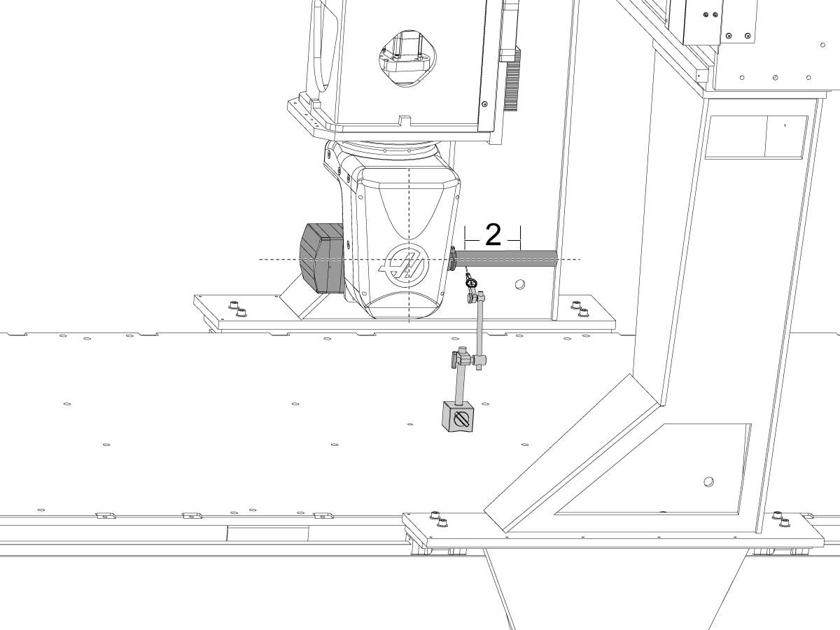

Spindle Centerline and B-Axis Intersection
C-axis Home
B-axis to 90º
Insert the test bar into the spindle
Find the high spot on the under side of the test bar 4" out from the spindle nose by jogging the Y axis forward and back,
Set your indicator to zero
Jog the X axis along the test bar [1] 4.75" out from the zero position.
Sweep across the test bar in the X; your results should be zero-to-zero
  • This is NTE .0005"
6
Rotate the B axis so it is in the position shown.
C axis at Home.
B axis at -90 degrees.
Be sure Z axis is high enough so when rotating B the test bar does not contact the table.
Jog the X axis over so the indicator is as shown in figure 2. Do not change the Y or Z axis position.
Without changing the indicator zero, jog the X axis [2] 4.75" document the error.
  • This is NTE 0.002"

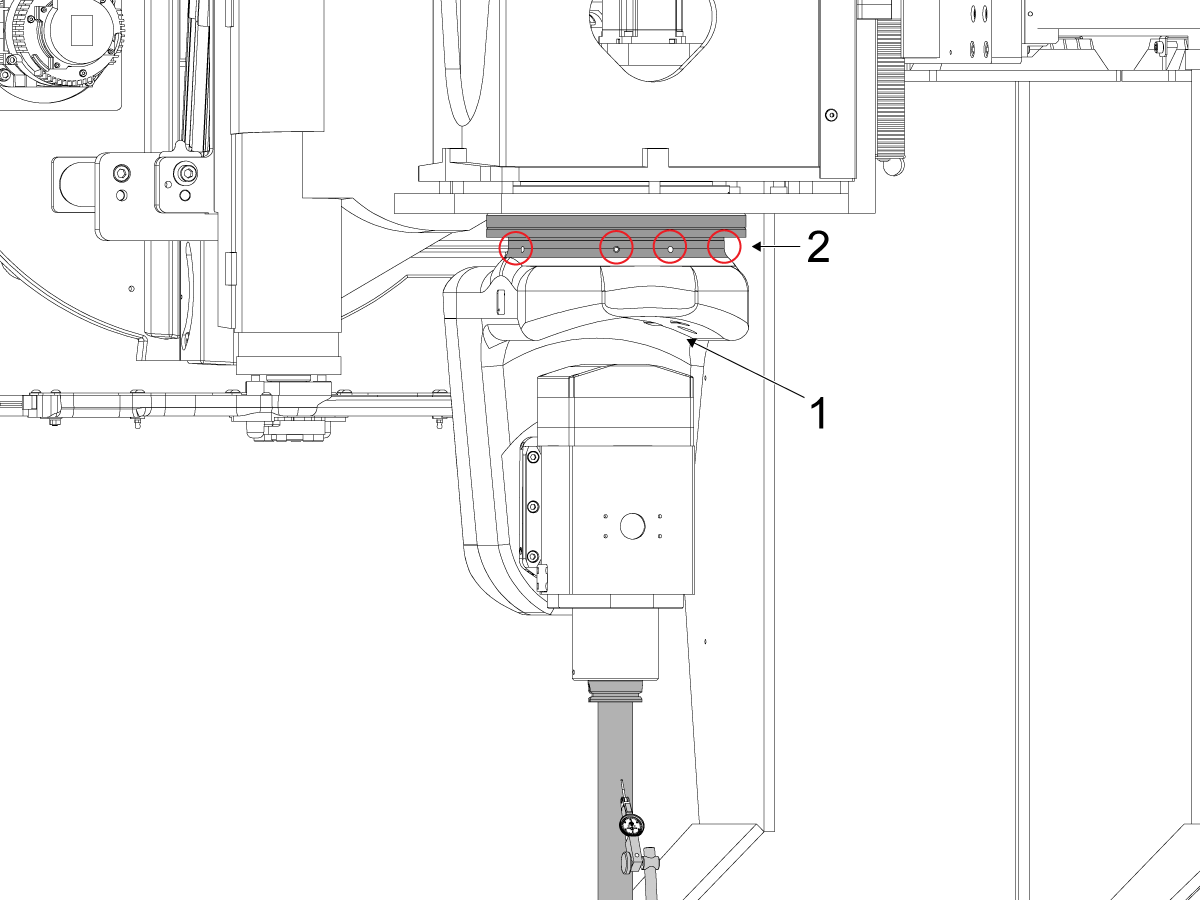

C-AXIS RUNOUT
  • Rotate the B-Axis to 90°.
  • Remove the (7) plugs in the B-Axis body
  • Loosen the B axis body mounting screws under the 7 plugs that were removed.
C-AXIS RUNOUT
 The (8) B axis adjustment set screws (represented as [2] on the diagram) will be used push or pull the head in needed direction to correct the error.
  • Rotate the B axis back to Zero and place the indicator setup on the test bar
  • Use the 8 concentricity set screws to adjust the runout. (represented as [2] on the diagram)
  • Tighten all (7) B-Axis Mounting Screws [1] and verify TIR is within machine specification. If not, repeat the process.

B AXIS INCLINATION
Correct for error in the "C-AXIS at 90 Degrees" by following the instruction below:
  • Rotate the B-Axis to 90°. Support the 5 axis head using a fixture.
  • Remove the 7 plugs in the B-Axis body
  • Loosen the 8 concentricity set screws. (keep very light tension on set screws to hold concentricity)
  • Carefully remove five of the seven B-Axis Casting mounting bolts.
  • Do not fully remove the 2 bolts shown in red, bolt may be diffitcult to remove due to cable being int the way.
  • Be careful not to damage any cables
  • Slowly jog the Z-Axis up to separate the B-Axis body casting.
  •  Note: It is critical the B-axis body is stabily supported so mating surfaces remain parallel during separation
  • Only separate enough to install mylar shim.
  • Install mylar shim
  • Be sure to not block a bolt hole with the shim.
  • Tighten all [7] B-Axis Mounting Screws and check TIR is within machine specification. If not, repeat the process
            Refer to HAAS FASTENER TORQUE SPECIFICATIONS.
  • Once complete jog the  Z-zaxis back up,  zero-return the B and C-Axis and recheck steps 2 and 3 of the head verification process
Recheck Steps 1 and 2 of the Head Verification above and adjust if necessary
Breaking the DON'T REMOVE seal on the spindle without contacting Haas Service will VOID the warranty. Contact Haas Service before proceeding with any adjust.
Verify dowel pins between the Spindle and spindle mount plate are not damaged.
14
Verify Dwell pins between the Spindle and spindle mount plate are not damaged.
