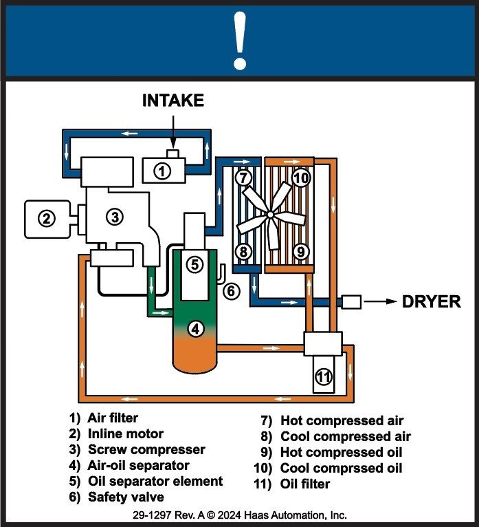

This chapter provides a basic troubleshooting guide for both the single speed and variable speed Haas Air Compressor.
This guide includes a table of common issues with the compressor as well as potential solutions.
This image shows the flow of the oil and air through the internals of the compressor system.
  1. Air Intake Filter
  2. Inline Induction Motor
  3. Screw Compressor Assembly
  4. Air-Oil Separator Unit
  5. Oil Separator Element
  6. Safety Valve
  7. Hot Compressed Air Entering Radiator
  8. Cool Compressed Air Leaving Radiator
  9. Hot Compressed Oil Entering Radiator
  10. Cool Compressed Oil Leaving Radiator
  11. Oil Filter
