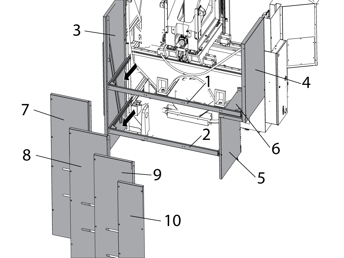

Shipping Brackets Removal
Remove the X [1] and Y [2] axis shipping bolts from both sides of the saddle and ram. There are (4) total as seen in the TOP VIEW.
[ZERO RETURN]  [Z] axis and remove the shipping bracket [3] from the platter.

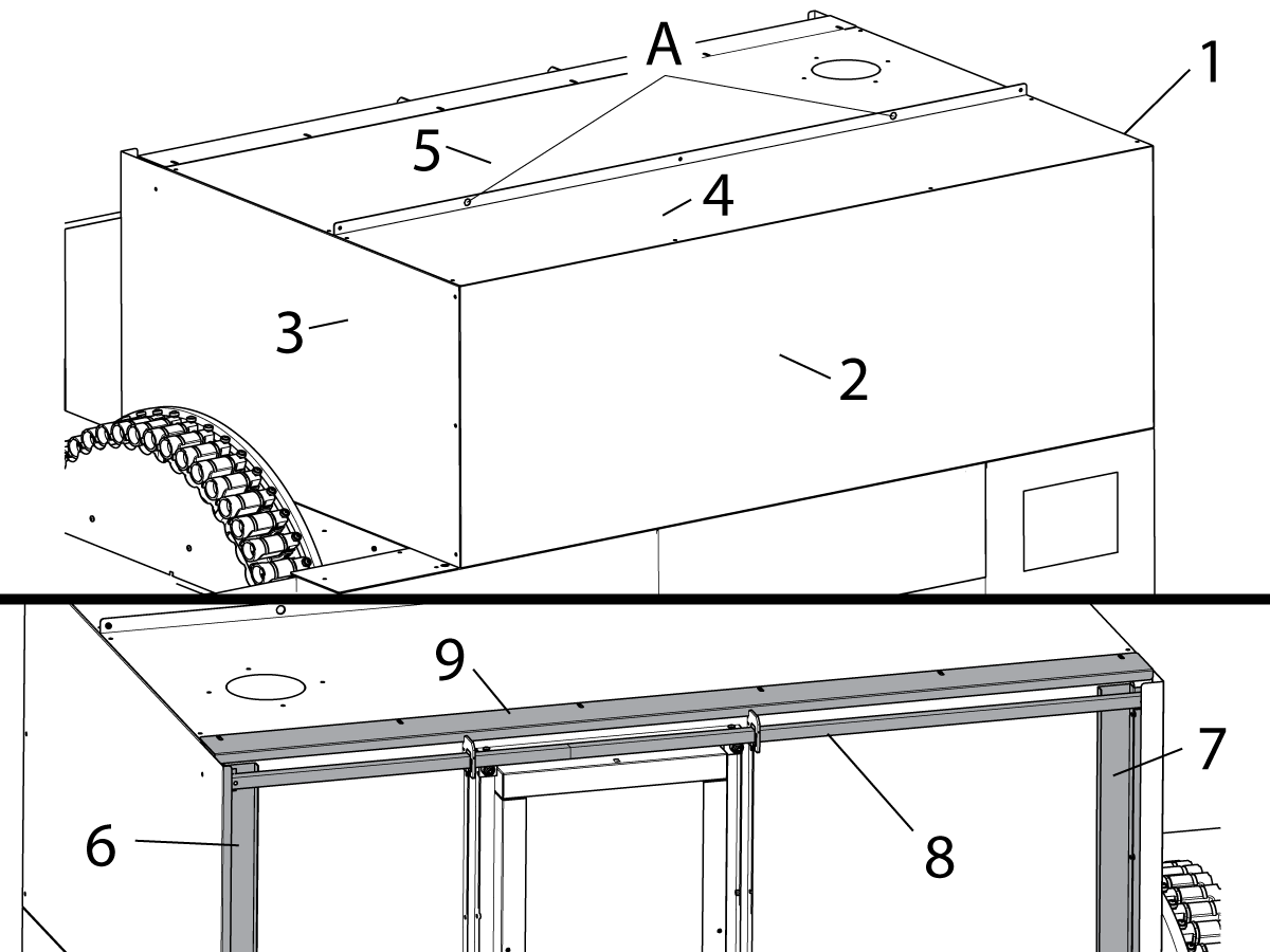

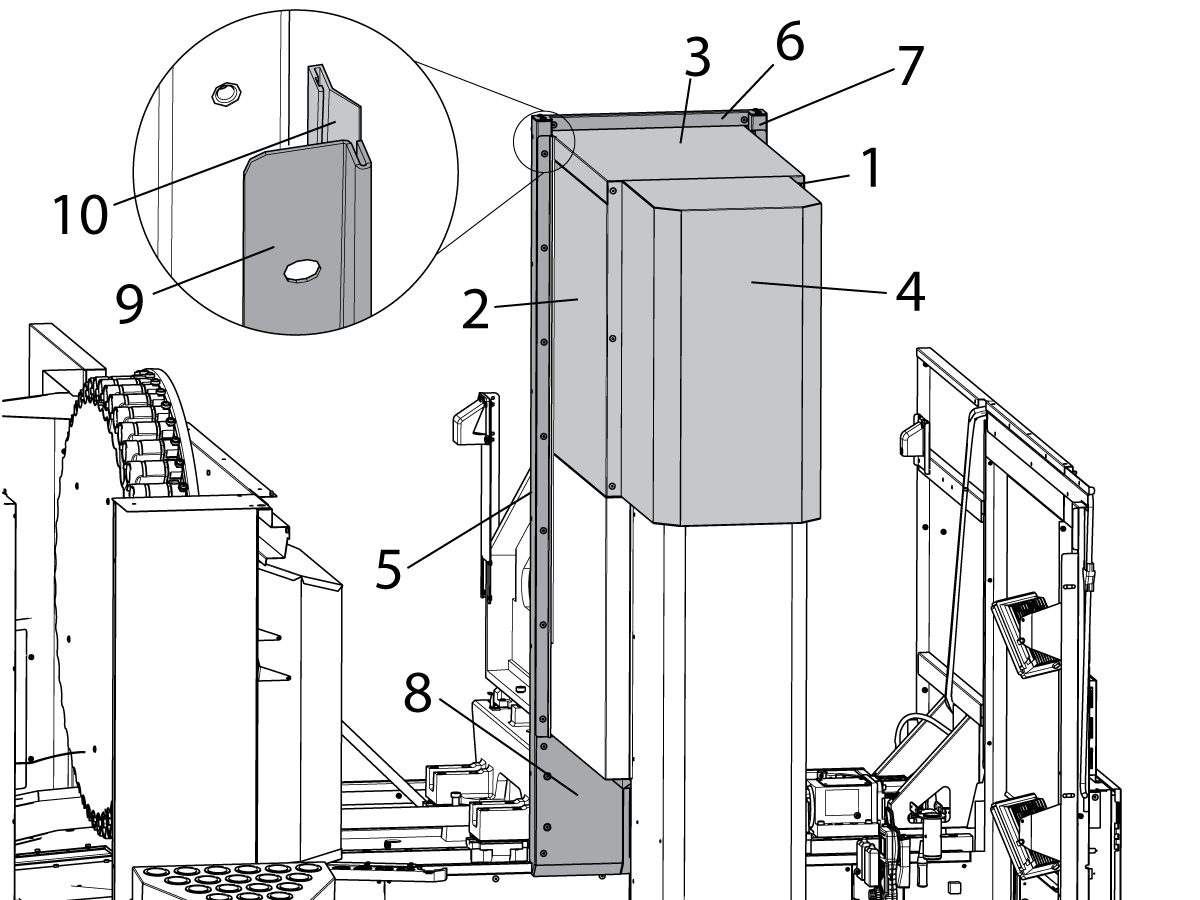

Ram Top Cover
Install the ram top sheet metal: [1] [2] [3] [4].
Install the saddle wiper frame: [5] [6] [7] [8].
Install the wipers [10] on the retainers [9] and install on both sides of the frame.
Roof and Waycovers
Install the roof assembly. It can be assembled on the ground an hoisted into position using the lift points [A] or assembled in place in the order shown: [1] [2] [3] [4] [5].
Install the X axis waycovers, [6] & [7] with the lower tabs hooked over the chip guard. Leave the velcro straps in place and bolt the waycovers to the side walls. Install the curtain rod [8] with the waycovers hooked over the top. Remove the velcro straps and bolt the waycover to the saddle frame.
Install the cover plate [9]. If equipped with the enclosure exhaust option install it now.

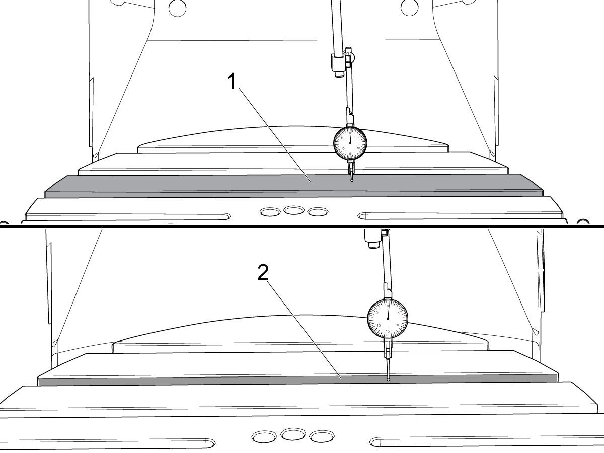

B-Axis to Y-Axis Parallelism Setup
[ZERO RETURN] [B] [C] Axis. Indicate the table face along the X-Axis over a distance of 20" (500mm).
If the reading is not zero, jog the B-axis (in 0.0001" increments) until the indicator reads zero over 20".
Set a workoffset of the B-axis position you will come back to this position in later steps.
Note: Do not reset the Tool Change Offset.
Handle Jog C Axis to C90. Check the parallelism of the platter surface by indicating from the back to the front of the platter in the Y-Axis plane.
Zero your indicator at the back of the platter with Y-Axis at 0 and on the 3rd rib out from the center.
Sweep forward with the Y-Axis over 20" (500 mm). Record the indicator reading, noting both the magnitude and the direction.

Zero the indicator on the rear table face and jog the Y Axis from back to front over 20" (500 mm).
Record the indicator reading, noting both the magnitude and the direction. This measurement shows the position of the table relative to the Y-Axis in the side to side direction.
If the trunnion leans to the right, lift with the right front leveling screw and lower with the left front leveling screw in small, equal, increments.
If the trunnion leans to the left, lift with the left front leveling screw, lower with the right front.
Sweep the table again to make sure that it is aligned to read zero over the 20" (500mm) sweep.

Rear Panels
Extend the C-channels [1] & [2]. Install the side panels [3], [4], [5], & [6].
Install the rear panels [7], [8], [9], & [10].
