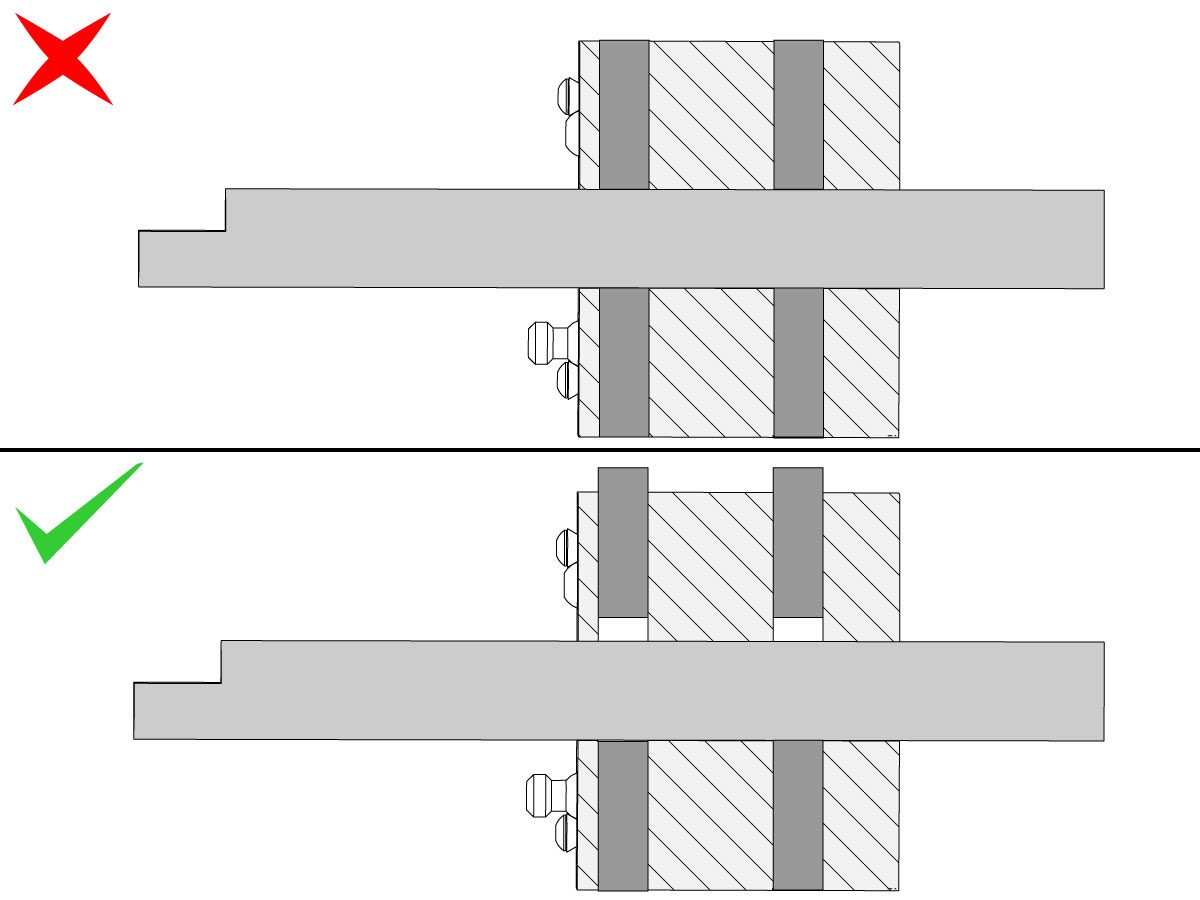

For boring bars, the material type of the bar will affect its stability. A steel boring bar (2) is stable up to a stick-out of 3 times the diameter. A carbide boring bar (1) is stable at a length up to 5 times its diameter. If you must exceed these limits, you must compromise your cut parameters to compensate for the reduced stability—reduce the depth-of-cut, feedrate, or spindle speed to compensate.
 Note: Special vibration-dampening boring bars are available when you need an extreme length-to-diameter ratio to machine a bore.

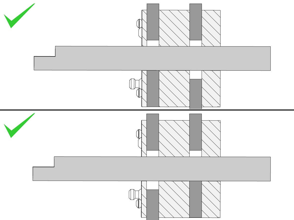

The set screws holding the bar in the holder can change the boring bar's resonant frequency. BOT holders have four set screws; two on each side. Best practice is to tighten the set screws on only one side of the holder. This ensures that the bar is held firmly against the BOT holder's bore. If you tighten the screws on both sides of the holder, then the bar may not be in contact with the bore, effectively floating in the center of the holder [1].
If you still have chatter issues using two screws on one side, you can loosen one of the set screws to change the bar's resonant frequency.

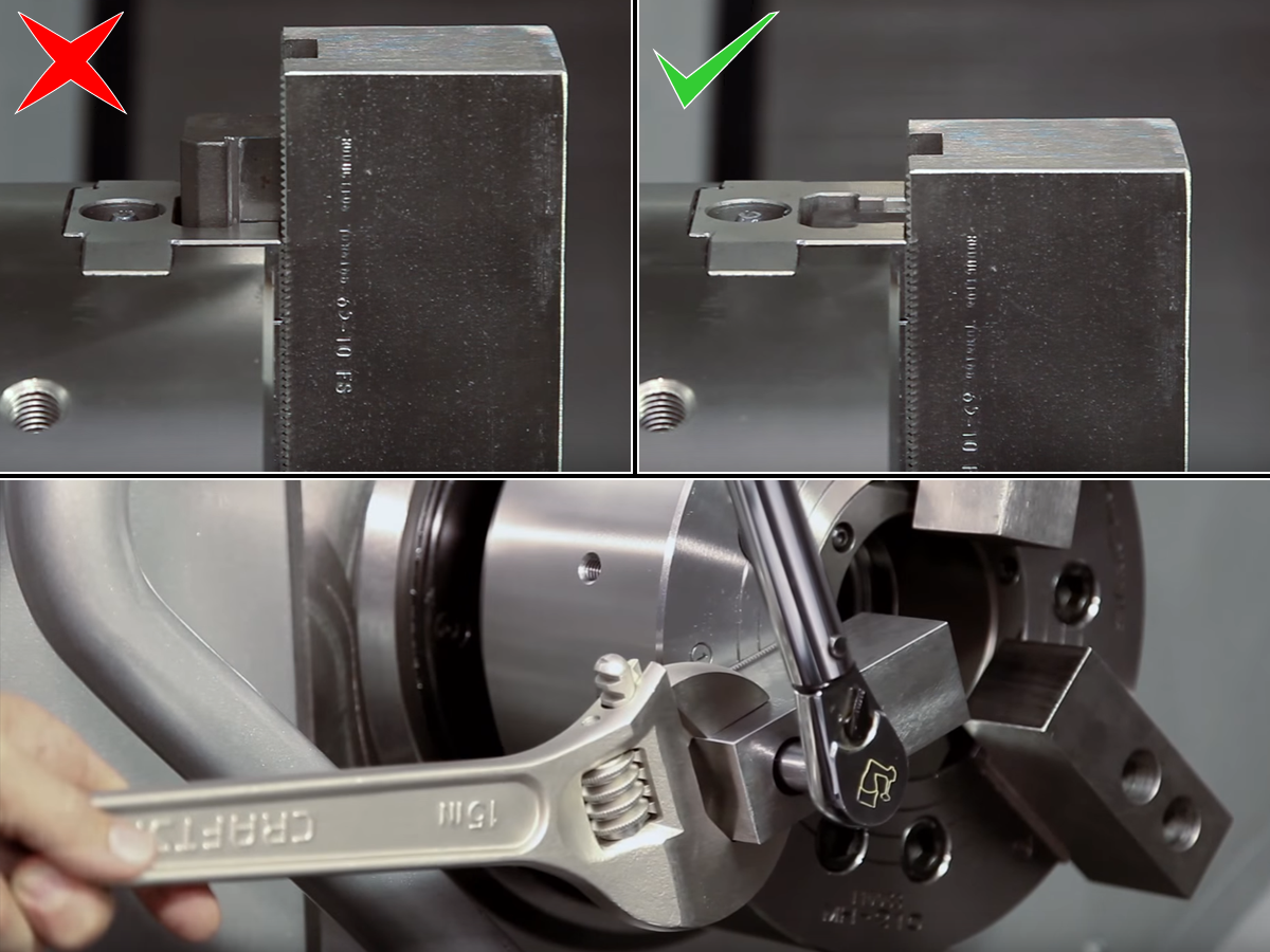

The Workpiece Moves in the Chuck
If your workpiece moves in the workholding during  the cut, you will have accuracy issues, difficulty holding tolerances and chatter issues.

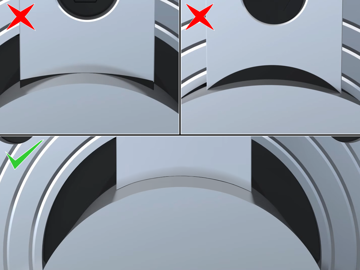

Incorrectly bored chuck jaws can let the workpiece move. The soft jaws should be machined to match the nominal size of the part being held.
Be sure to use a chuck jaw support slug (1) or adjustable boring ring (2) in the center travel of the jaws, before you machine the jaws. If the Jaws are too close to the top of the stroke you will have diffucalty loading and unloading your workpiece in the jaws, if the jaws are too close to the bottom of the stroke the full clamping force will not achieved.

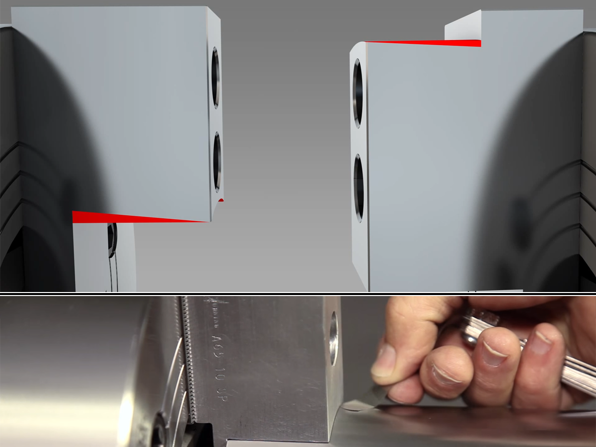

Use a 0.001" (0.03 mm) feeler gauge to check for gaps between the workpiece and the chuck jaws. Check both the front and the back. The jaws may have deflected from the clamp force, in some cases you may need to machine a slight taper in the jaws to compensate for the jaw's deflection allowing for full jaw contact with the workpeice.
Make sure that the chuck jaws are tight, and that the screws do not bottom out on the T-nuts or T-slot. The T-nuts should not extend outside the T-slots.

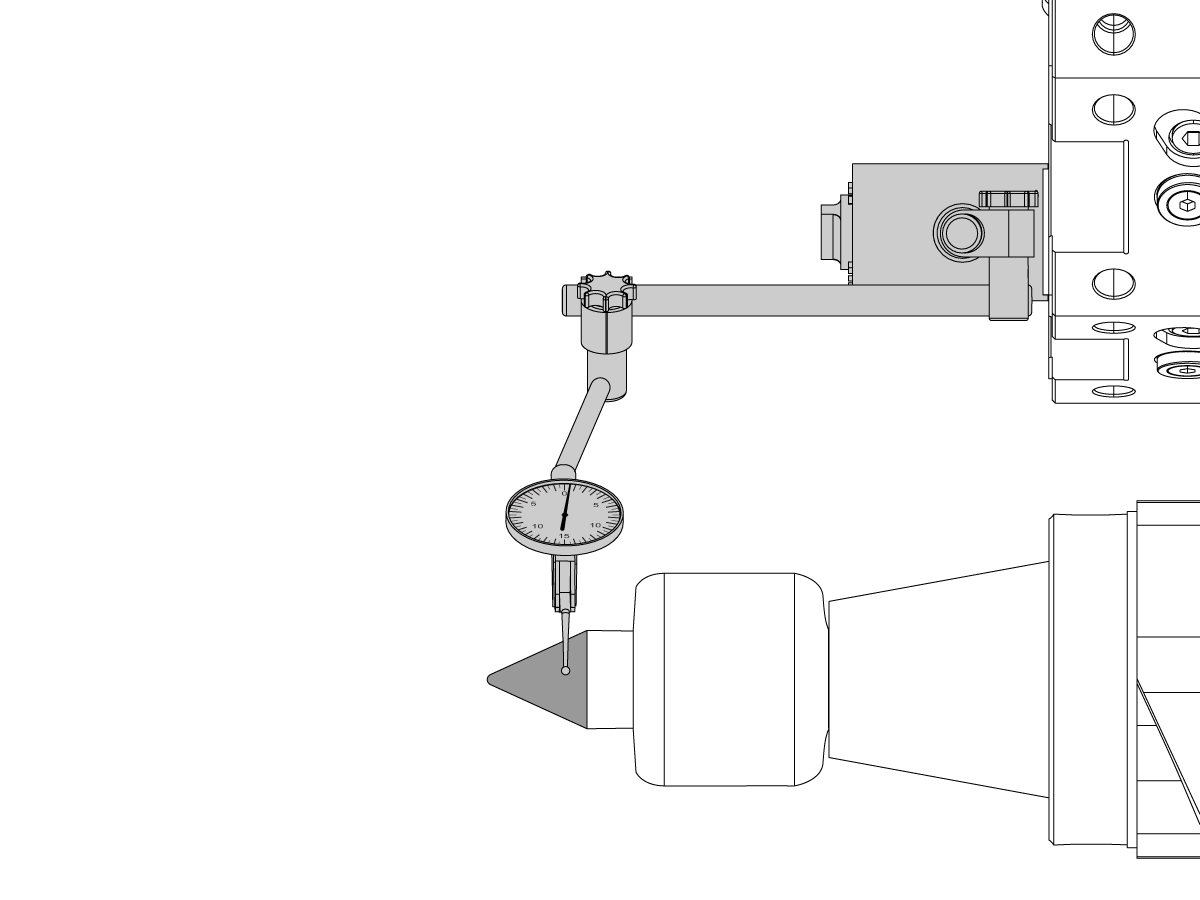

Worn or Damaged Live Center
A worn or damaged live center can introduce vibrations and let the part move. This can cause chatter, taper, poor surface finish, and tool life issues.
Inspect live centers for excessive runout and damaged bearings while they’re still in the machine.
Check runout by placing an indicator on the 60 degree point, then gently rotate the center's point. The TIR should be within the manufacturer’s specification.
Check for bearing wear by gripping the point firmly and rotating it in one direction. The spindle should turn freely, if you can feel hesitations or roughness this indicates bearing wear.

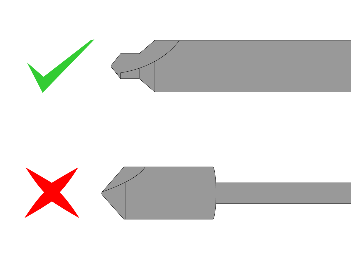

The Center-Drilled Hole is Incorrect or Damaged
If the center-drilled hole has the wrong angle, is too small, too shallow, too deep, or is damaged, the live center will not have sufficient contact with the workpiece to properly stabilize the cut.
Be sure to use a 60° center drill tool. Countersink tools do not have the tip relief required for the live center.
Inspect the center-drilled hole. If necessary, machine it again.

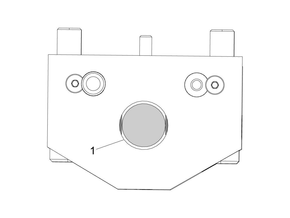

Adjust the OD stick tool holder so that the tool holder’s projection length from the turret is as short as possible. If you must use a longer stick tool for clearance, consider using a Haas Twin Turn or Extended Twin Turn BOT holder to fully support the stick tool. You can get these holders on parts.haascnc.com.
Adjust the ID boring bar holder so that the tool’s projection length from the tool older is as short as possible. The material type of the bar will affect its stability. A steel boring bar is stable up to a stick-out of 3 times the diameter. A carbide boring bar is stable at a length up to 5 times its diameter. If you must exceed these limits, you must compromise your cut parameters to compensate for the reduced stability—reduce the depth-of-cut, or spindle speed to compensate.
Helpful Hints:
If you need to use a bushing for the boring bar, use a split bushing to increase bar support.

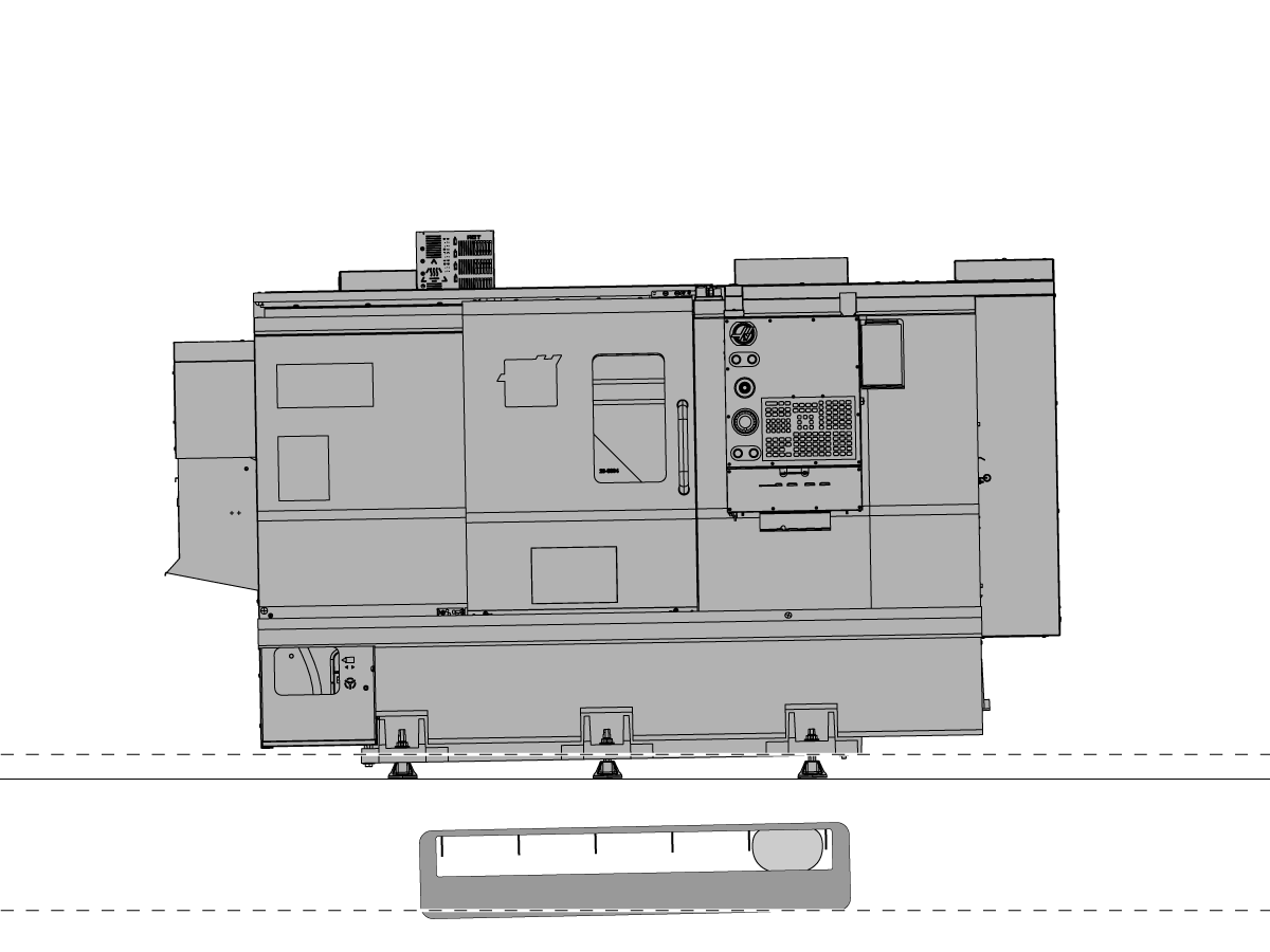

Threading - Machine is Not Level
To operate correctly, the machine must be level. An out-of-level machine can have problems such as poor surface finish, tapered parts, accuracy and repeatability issues, out-of-round circular motion, and out-of-true linear motion.
Watch the Lathe Leveling video to learn how to properly level your Haas lathe, or contact your Haas Factory Outlet to have your machine’s level checked.

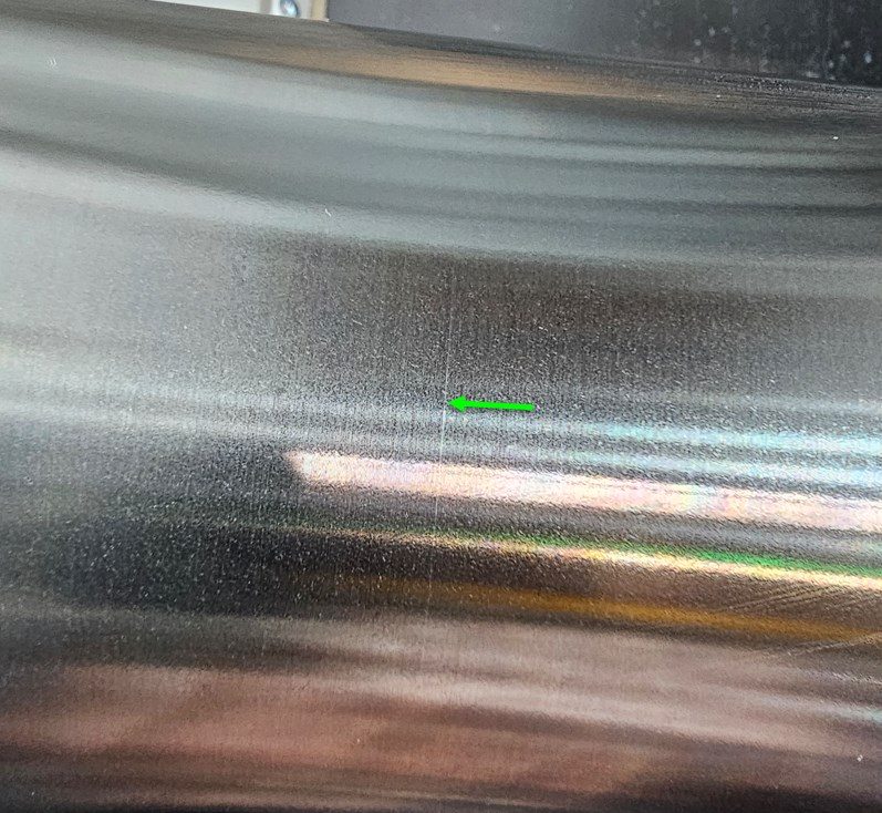

Surface Finish Step
ST-40 and Above only (Machines Built after Jan 2022)
During long cuts along the Z-axis after rapid movement on the X-axis if a surface finish step is observed verify that parameter 1.042 is set to 0.
 Note: These steps are very small (0.0002" - 0.0003") but visible.
