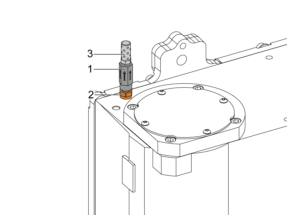

Cambox Exhaust Check Valve
Verify the check valve [1] arrow is facing away from the cambox as shown.
The check valve (PN 58-2754) [1] should be install between the brass fitting (PN 58-1674) [2] and muffler fitting (PN 58-1865) [3].

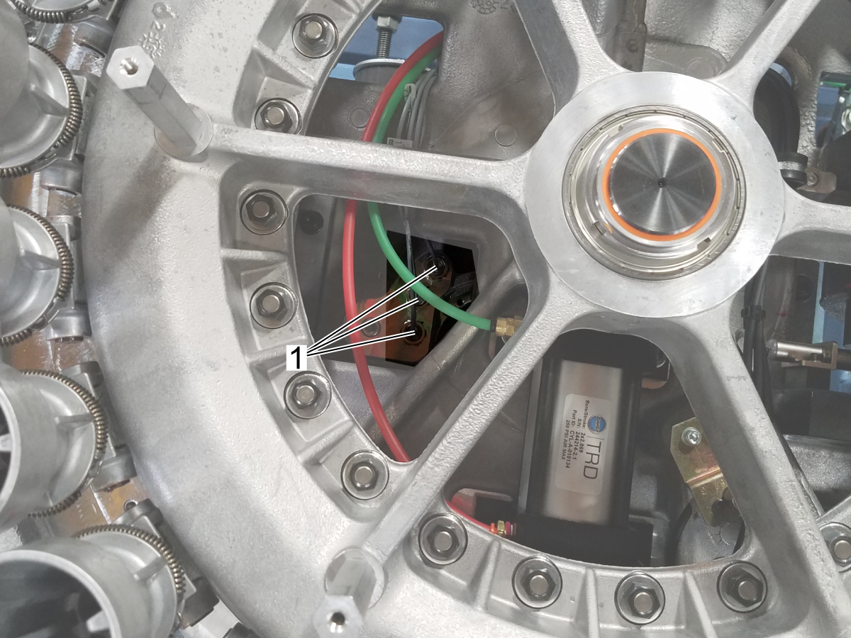

Cambox Proximity Sensors
Corrective Action:
Remove the carousel number plate to get access to the sensors [1]. Go into the manual tool recovery and push ATC FWD to move the arm through a complete cycle. Make sure the LED on the sensor and the diagnostic bit state change at the correct stage of the tool change cycle. See the chart below.
If the sensors fail to change state, refer to the Proximity Sensor - Troubleshooting Guide.
SENSOR Origin Rotation Tool Pick - Up Down / Rotation 180 / Up Tool Exchange Arm Backup (Reverse) Origin
Clamp/unclamp On / 0 On / 0 Off / 1 On /0 Off / 1 On / 0 On / 0
Origin Off / 1 On / 0 On / 0 On / 0 On / 0 On / 0 Off / 1
Motor stop Off / 1 On / 0 Off / 1 Red / 0 On / 1 On / 0 Off / 1

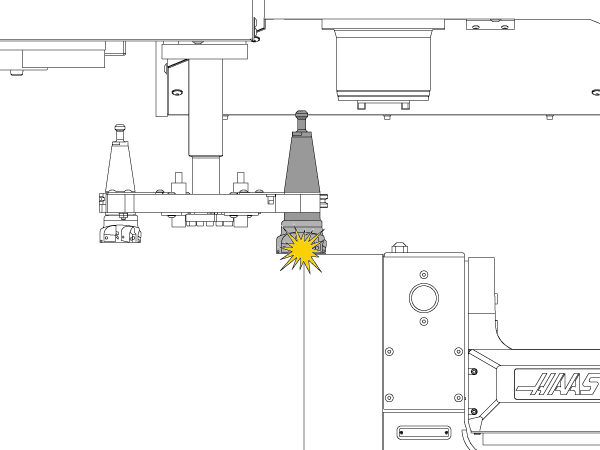

Double Arm Alignment
Corrective Action:
Use a straightedge to find out if the arm is bent. If the arm is bent, these are some of the possible causes:
1: The tool release piston (TRP) sensor(s) are not adjusted correctly.
If the TRP sensors are not adjusted correctly, a tool can get stuck in the spindle taper, or the drawbar might not release a tool. Damage to the double arm can occur. Adjust the tool release piston switches correctly. Refer to VMC - 20/30/40-Taper- TRP - Proximity Sensor - Adjustment.
2: The arm crashed into a rotary or a fixture during a tool change.
Refer to your operator's manual to set the tool change offset, or alias an M06 command, to move the spindle to a safe height. Move the obstacle on the table to a safe distance away before the tool change. If you install a rotary or trunnion unit, mount it as far to the right as your setup will allow. This gives you more room for safe tool changes.
Go to Episode 21 - How to Command a Safe Tool Change Position to Avoid Fixtures and Rotaries for more information.

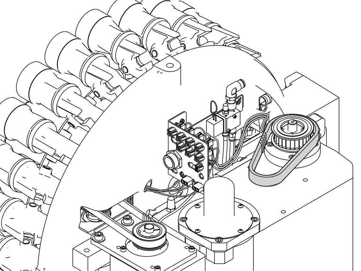

Cambox Drive Belt
Corrective Action:
Inspect the belt for damage and replace it if necessary. Refer to VMC - Side-Mount Tool Changer (SMTC) - Carousel Motor - Replacement for how to replace the cambox belt.

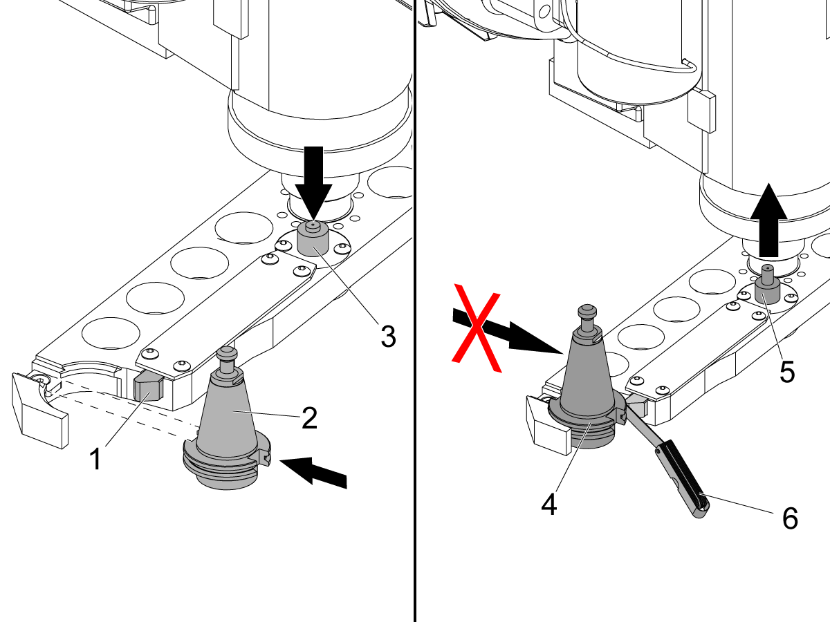

Double Arm Tool and Slide Adjustment
Push down on the plunger [3] and hold it down.
Put a tool holder [2] into the arm. During correct operation, the slide [1] moves in.
Release the plunger [5].
Try to remove the tool holder [4]. During correct operation, the slide does not move in and the tool holder locks in position.
Measure the space between the slide and the tool holder. Use a feeler gauge [6]. The correct space is between 0.014 in (0.36 mm) and 0.020 in (0.51 mm). If the machine is a DM-1 or DT-1, the correct space is between 0.005 in (0.13 mm) and 0.015 in (0.38 mm).
Add or remove 0.01 in (0.25 mm) shim washers, part number 45-0075,  until the space is correct.
Once the gap is set reassemble the slider assembly with the spring and washer installed. Apply a layer of Lithium Tacky Grease to the finger, spring and washer.
