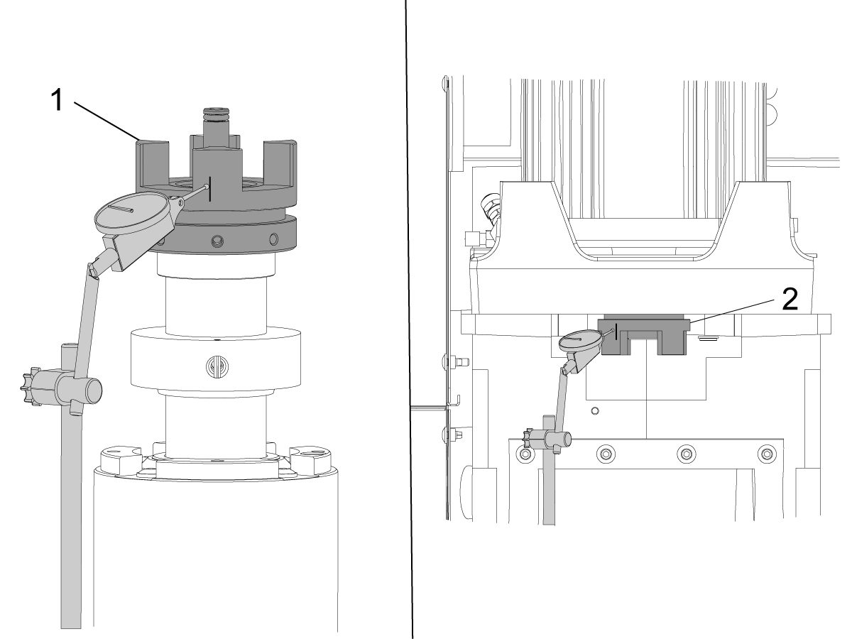

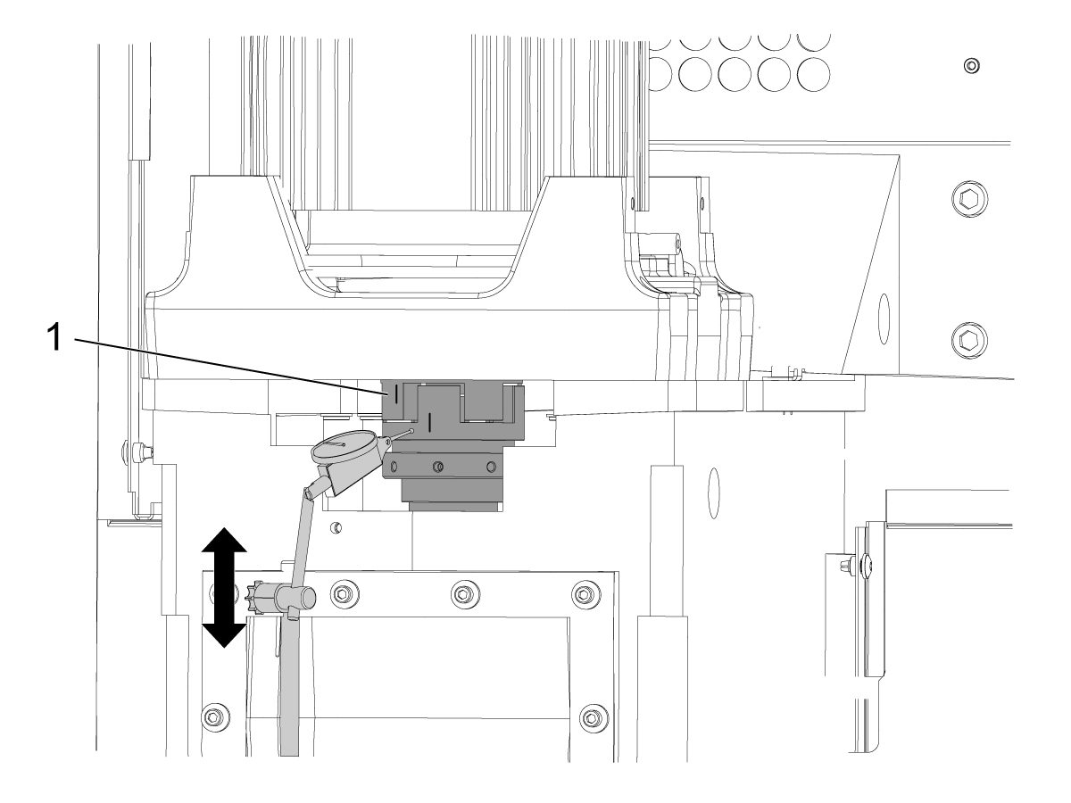

 Note: If you install the same spindle that you remove or a new spindle, record the location of the spindle shims. Install the spindle shims in the same location and then do the VMC - Spindle - Spindle Sweep procedure.

Place the shims in the same location as the previous spindle.

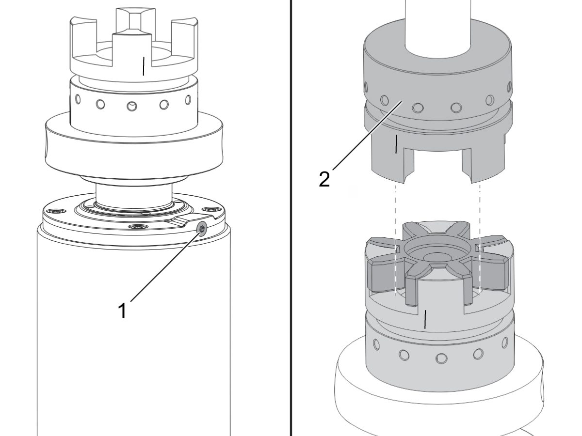

Caution: The motor shaft may become misaligned if spindle installation is done incorrectly.
Before installing the spindle loosen the motor mounting bolts at least a half of an inch.
If the pins are misaligned with the coupler, the motor will visibly lift instead of transmitting all of the axis thrust force into the motor shaft and creates damage on the bearings.
Slowly jog the Z Axis in the negative (-) direction over the spindle.
Make sure the spindle coupler and the motor coupler align with the spider coupler [1].
Caution: Incorrectly aligned couplers can cause damage to the bearings.
Slowly jog the Z axis in the negative (-) direction.
Make sure the couplers engage smoothly.
Make sure the spindle is centered in the spindle bore. Install (6) spindle screws [2]. Torque the screws. Refer to HAAS FASTENER TORQUE SPECIFICATIONS.
