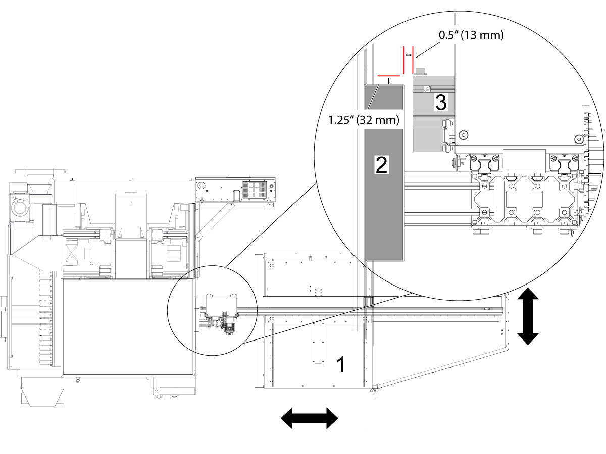

Align APL to the Mill
  • Bring the APL approximately 35 inches (89 centimeters) from the front of the machine - measure from the APL pillar to the seam between the sheet metal panels on the front of the machine
  • Remove the back panel shipping bracket [1]
  • Secure the back panel [2] to the support bracket [4]. Leave screws loose
  • Maneuver the APL until you can attach panel [2] to [3]
  • Tighten all screws

Level the APL
  • Level the APL base with the bubble level on top of the APL table
  • Use the leveling screws at the bottom of the APL base to level the APL front to back [1] and side to side [2]
  • When done with leveling make sure that all four leveling screws make contact with the floor
  • Place the level on top of the horizontal beam [3]
  • Loosen the bolts that secure the beam to the pillars
  • Lift or lower the right side [2] of the horizontal beam until it is leveled
  • Tighten the bolts that secure the horizontal beam to the pillars

Align Gripper to the Vice
  • Mount an indicator base clamped to the gripper [1]
  • Jog the AU axis and measure the offset between the dowel pins [2] on the APL table to verify the table is in line with AU axis motion - NTE 0.060" (1.5mm).
  • Jog the AU and AW axes to place the gripper [1] in front of the automatic vice [2]
  • If necessary move the APL base [3]  front to back until the stock is aligned with the vice
  • Note: Make sure the entire APL assembly stays perpendicular with machine when you move the base

APL Alignment on Machines With 90 Degree Control Cabinet
NOTE: Perform this Section only on UMC's with the swivel Control Cabinet.
NOTE: Machines built after April 1, 2021 are built with the swivel electrical control cabinet (also known as the 90 degree electrical control cabinet).
  • Use a pallet jack to move the APL [1] into the proper position.
  • adjust APL to the measurements shown:
    • Measure distance of 0.5" (13mm) for the AU Axis of APL
    • Measure distance of 1.25" (32mm)  for the AV Axis of APL

APL Alignment
Use a pallet jack to move the APL into the proper position. Adjust the APL to the measurements as shown:
Measure distances from the end of the AU axis arm to the machine:
  • Measure 0.75" (19 mm) from the end of the arm to the sheet metal above the auto window  [1]
  • Measure 11" (280 mm) from the side of the arm to the side of the side of the auto-window sheet metal [2]
Secure the sheet metal panels between the back of the APL and the back of the machine. Bolt one panel to the APL [1] and use magnets to attach the other panel to the machine [3]. Use bolts to secure the panels together [2].
