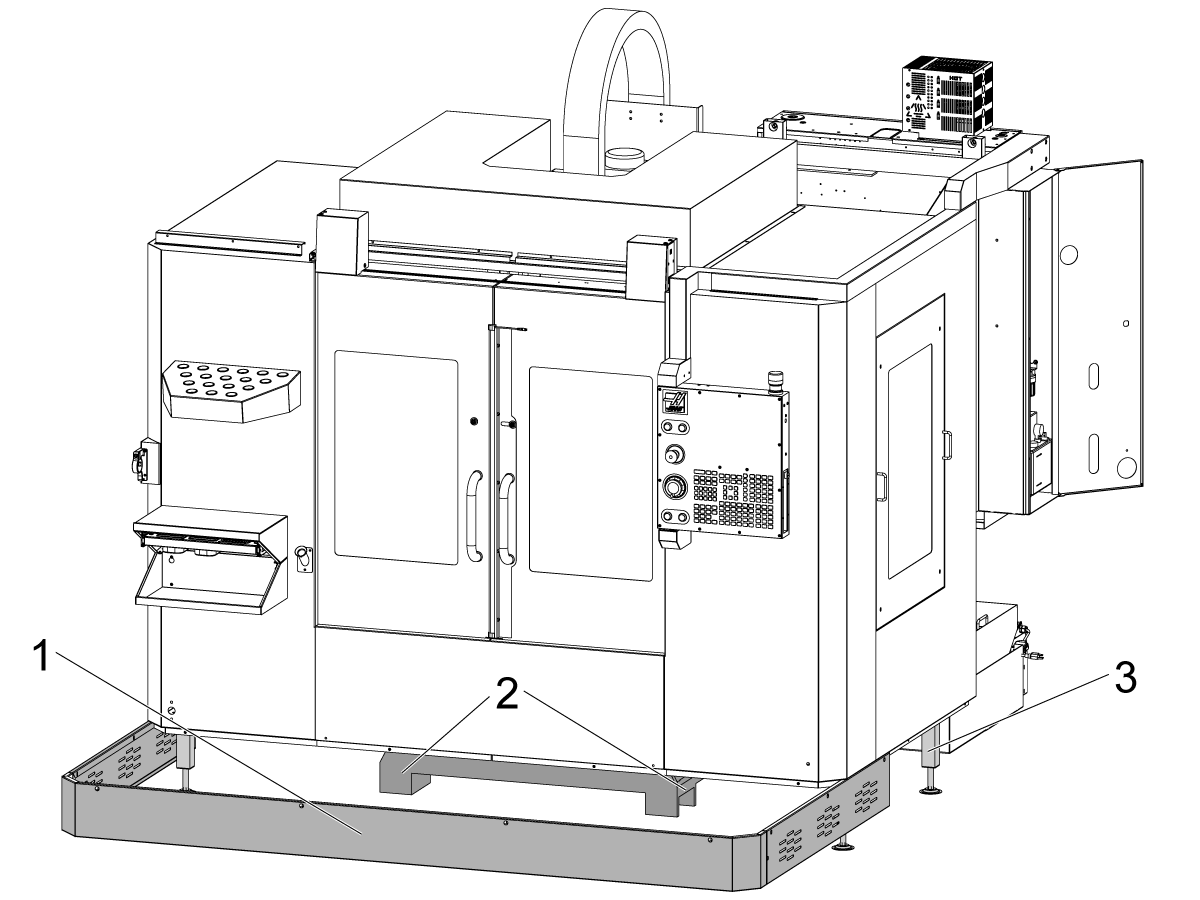

The DC-1 can be lifted by forklift, or by using the lifting points on the base and column castings. For details on how to lift the DC-1 refer to the Pre-Installation Guide, or the machine lifting placard located on the machine.

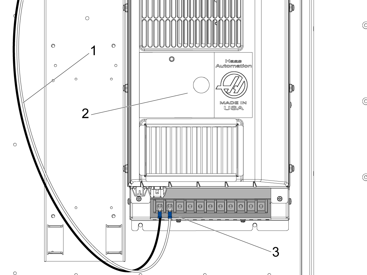

1-Phase Machines: Insert each power lead into the wire cover.  Connect the two power leads to L1 and L3 terminals on top of the main circuit breaker.
3-Phase Machines: Insert each power lead into the wire cover.  Connect the three power leads to L1, L2 and L3 terminals on top of the main circuit breaker.
Connect the separate ground line to the ground bus to the left of the terminals.
Refer to Haas Main Circuit Breaker - Torque Specifications for what value to torque the circuit breaker power leads.
 Note: Make sure that the leads actually go into the terminal-block clamps . (A poor connection will cause the machine to run intermittently or have other problems, such as servo overloads.) To check, simply pull on the wires after the screws are tightened.
After the line voltage is connected to the machine, make sure that main circuit breaker (at top-right of rear cabinet) is OFF . Remove the Lockout / Tagout and Turn ON the power at the source. Using a digital voltmeter and appropriate safety procedures:
1-Phase Machines: Measure the AC voltage across L1 & L3 at the main circuit breaker.  The AC voltage must be between 220 - 250 volts .
Note: Lower or higher than this voltage can generate low/high voltage alarms.
3-Phase Machines : Measure the AC voltage between all three pair phases at the main circuit breaker.
The AC voltage must be between 195 and 260 volts (360 and 480 volts for high voltage option).

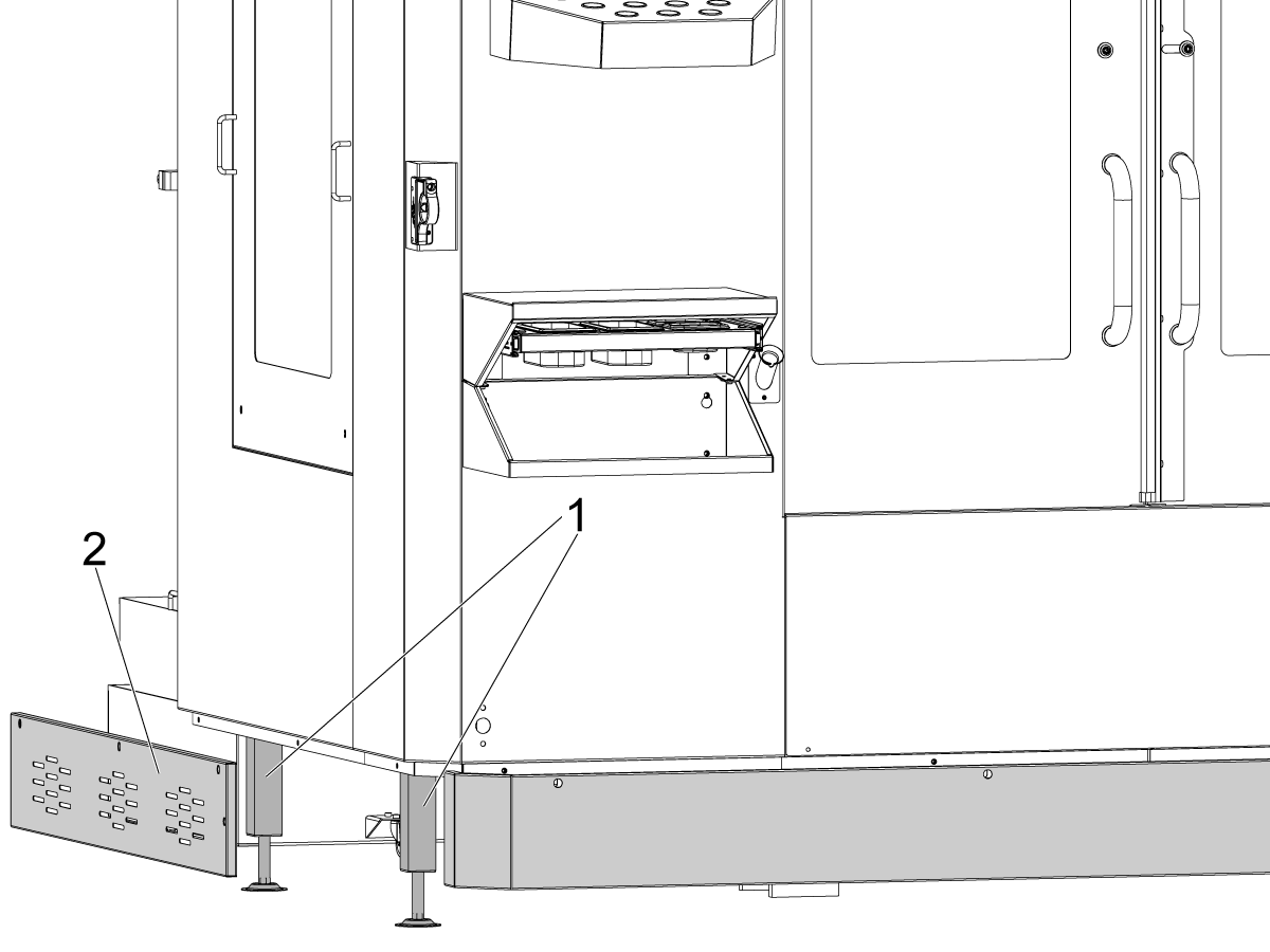

Machine Leveling
Zero return each axis one at a time or press [POWER UP]. Go through the leveling process.
Repeat these steps to achieve correct machine level.
Set the machine height using the four corner leveling bolts [1 ,2, 3, 4] to 3" +/- .5" (75 mm +/- 10 mm) above the floor. Turn each screw so they have equal tension.
Jog the X-axis and Y-axis to the middle of their travel, centering the table.
Note: For more information, refer to this link for a more detailed process on how to level a VMC machine.

Adjust corner leveling bolts [1, 2] or [3, 4] until the bubble parallel with the Y-axis is centered.
This levels the machine front to back.
Always raise the lower side of the machine to maintain clearance for the coolant tank (if equipped) and adjust the two leveling bolts on that side an equal amount.
Adjust corner leveling bolts [1, 3] or [2, 4] until the bubble parallel to the X-axis is centered.
This levels the machine left to right.
Again, raise the lower side of the machine and adjust the two leveling bolts on that side an equal amount.
6
Keep the level in the same position and jog the Y-axis to bring the table to the front of the machine.
Note the position of the bubble.
Jog the Y-axis across its full travel, stopping at the column. Look to see which rear corner of the machine is lowest, as shown by the leveling tool.
Raise the lowest rear corner by adjusting corner leveling bolt [3] or [4] until the bubble is centered on the level.
7
Jog the Y-axis back across its full travel, bringing the table to the front of the machine. Look to see which front corner is lowest, as shown by the level.
Raise the lowest front corner by adjusting corner leveling bolt [1] or [2] until the bubble is centered on the level.
Repeat steps 6 and 7, moving the table back and forth across the full travel of the Y-axis, raising the lowest corner each time.
Continue this process until the level reads zero at both ends of the Y-axis travel.
8
Once the machine has been leveled along both the X and Y axes, raise up the non-corner leveling bolts [5, 6, and 7] so that they are making contact with the base to provide support.

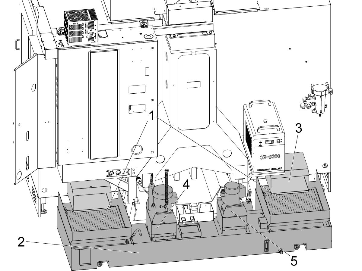

Coolant Tank Installation
Power off the machine.
Place the strainer basket [1] into the coolant tank [2].
Move the coolant tank assembly [2] under the drain slots at the base of the mill, under the front-left corner of the trough.
 NOTE: Make sure that the strainer basket [1] is directly under the drain slots to ensure coolant flows into the tank.
Insert the coolant pump assembly [3] into the back left corner of the coolant tank when facing the spindle.
Connect the hose to the coolant pump [1] into the coolant filter [2].
Connect the coolant pump power cable into the plug located beneath the control cabinet[3].
If included as a machine option, route the TSC pump[4] to the lube panel and fill the coolant tank with the necessary gallons of coolant.

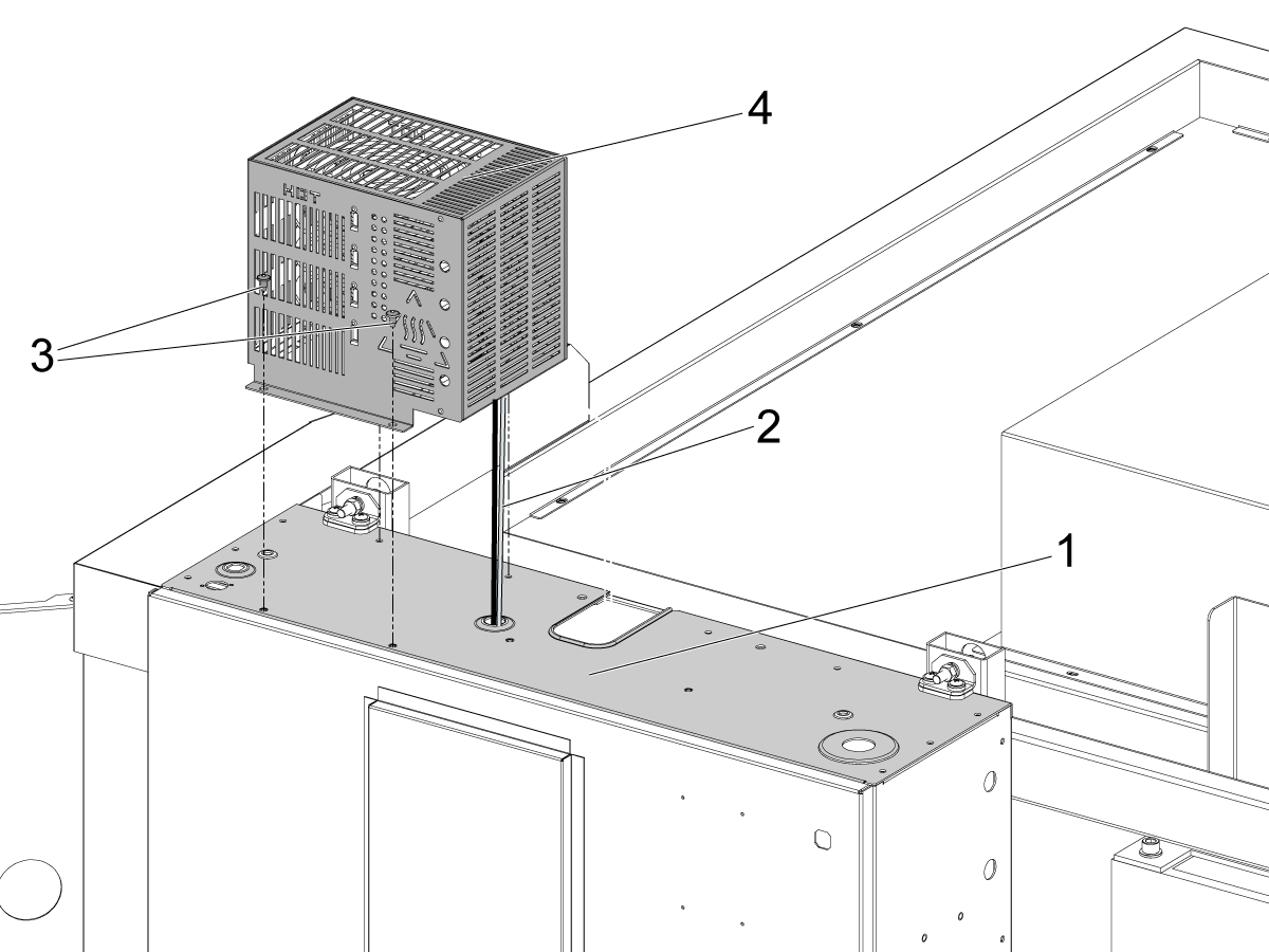

Control Regen - Installation
For the DC-2 machine, the regen assembly needs to be installed on top of the control cabinet [1].
Feed the 2 wires [2] connected to the regen assembly through the cutout in the control so that the wires can be routed to the vector drive.
Use the 4 BHCS [3] to install the regen assembly [4] in the correct position on the top of the control
Route the regen cable [1] to through the control cabinet to the vector drive [2].
Connect the cables to terminal 1 and 2 [3] on the bottom of the vector drive according to the label on each cable.

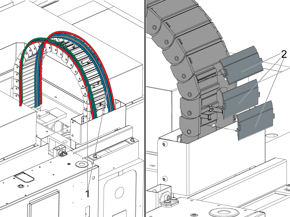

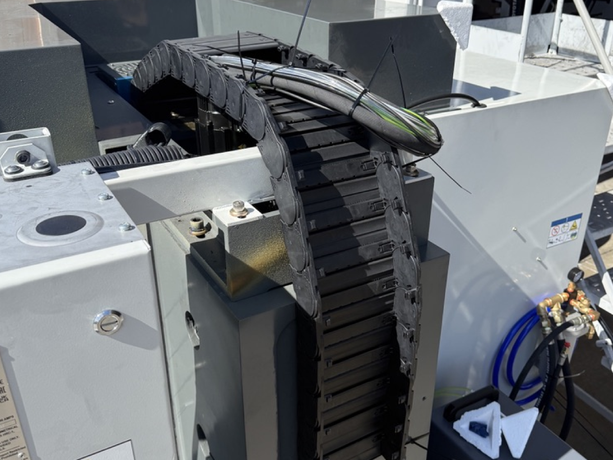

Z-axis Cable Carrier Installation
The Z-axis cable carrier needs to be mounted. It is removed on some machines for shipping purposes.
Important: Make sure to verify it is fully installed before you begin jogging the machine.

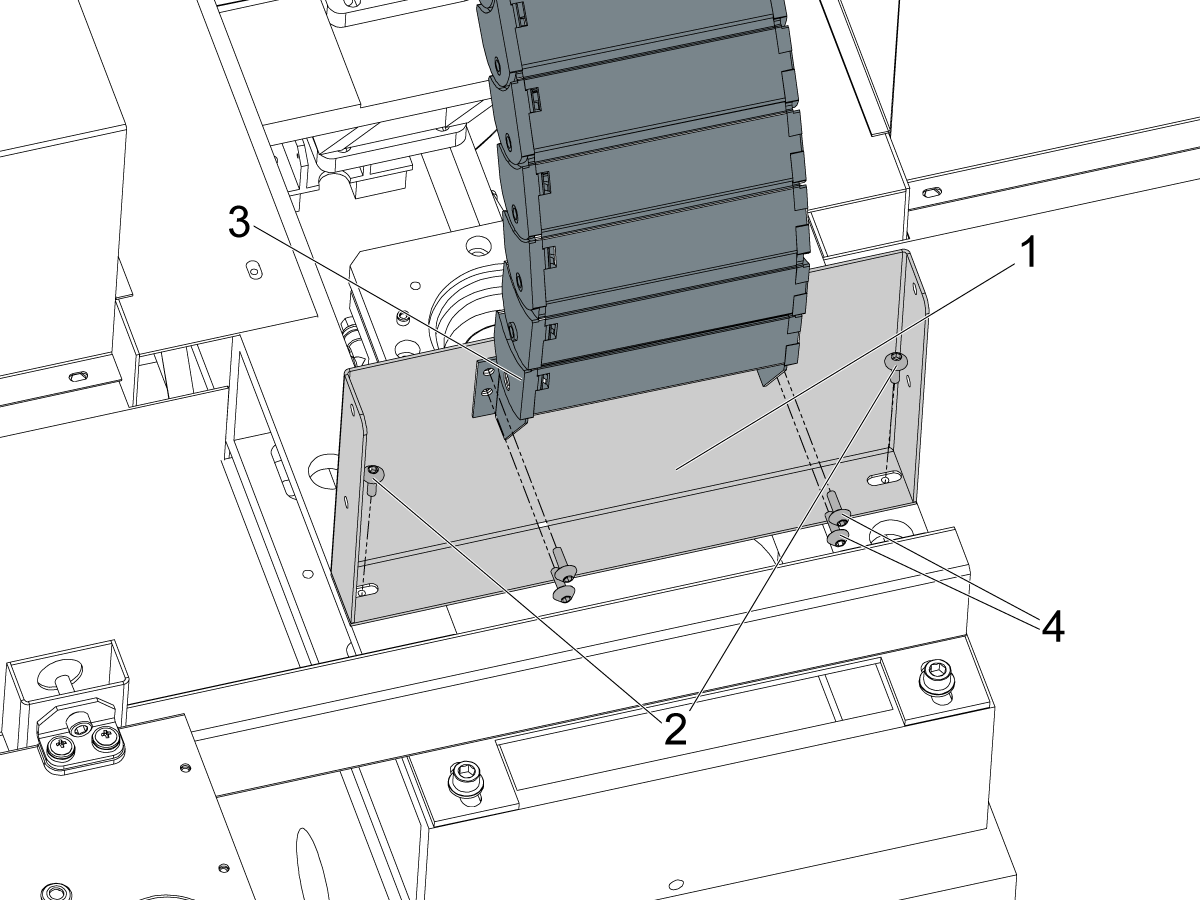

Install the cable carrier mount plate [1] to the top of the column using the mounting screws [2].
Then attach the Z-axis carrier [3] to the plate [1] with the 4 BHCS [4].

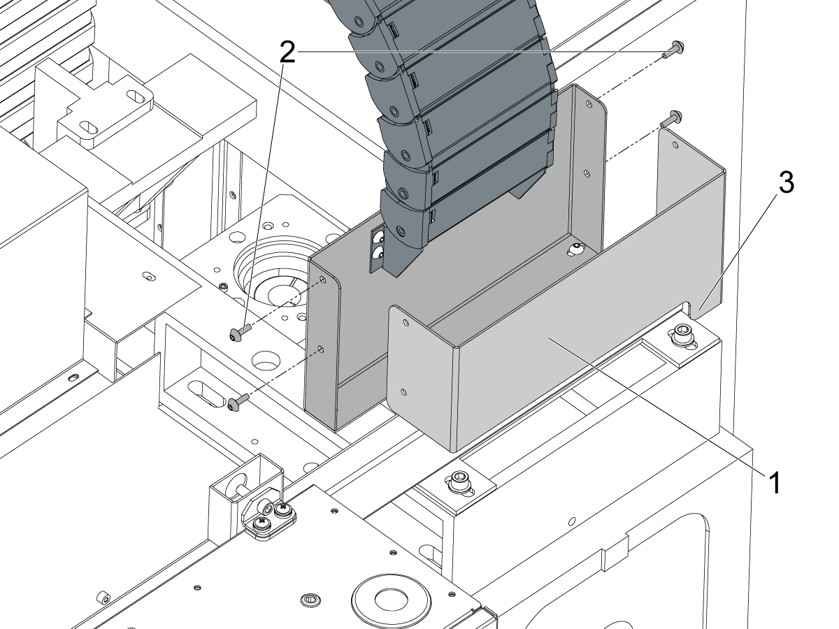

Install the rear cover [1] to the cable carrier mounting plate.
Use the 4 BHCS [2] to mount the cover to the mounting bracket [3].
Note: Make sure that the cover plate is oriented correctly. The cutout side [4] needs to be on the bottom right side as shown in the image.
Warning: The cables and hoses need to be separated and pulled to the sides of the cable carrier [1]. Pull them to the left and right sides and don't leave cables or hoses routed in the middle of the cable carrier. The cables could be pinched by some of the mechanical components in the spindle head area.
Once the cables are pulled to the sides, install all the missing links [2] of the cable carrier.

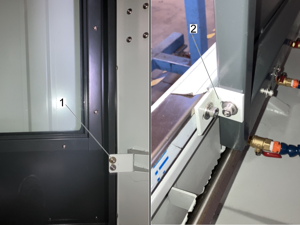

Remove the SHCS keeping the door fastened to the bracket [1].
Note: There are two brackets securing each door in position. One bracket near the door handle [2] and the other bracket on the other end [1].

Remove the skirt [1] located at the bottom of the machine.
This will give access to the front two leveling bolts [2].
The DC-2 machine has supporting feet [3] near the skirt of the enclosure.
Important: Make sure these support feet are not touching the ground when doing the leveling process.
Set the machine height using the four corner leveling bolts [1 ,2, 3, 4] to 4" +/- .5" (101 mm +/- 10 mm) above the floor. Turn each screw so they have equal tension.

After the machine is leveled, touch down the supporting feet [1] of the enclosure.
Reinstall the machine skirt [2] that was removed before leveling.
Place the 2 chip strainer baskets [1] into the coolant tank [2].
Move the coolant tank assembly under the drain slots [3] at the base of the machine.
Place the TSC pump on the left [4] if included in machine. Place the flood coolant pump on the right [5].
Connect the hose coming from the coolant pump [1] to the end of the chip separator [2].
Connect the hose from the T-fitting [3] to the coolant washdown going to the left side of the machine (right side as shown in the image from the back of machine)
Connect the hose from the right side of the chip separator [4] to the other side coolant washdown. Route the hose through the column casting to the far side of the machine.
Connect the hose coming from the spindle head [5] to the front fitting on the chip separator [6].
Connect the hose [7] to the coolant gun port on the front of the machine. Route it through the enclosure with the hose for the coolant washdown.
